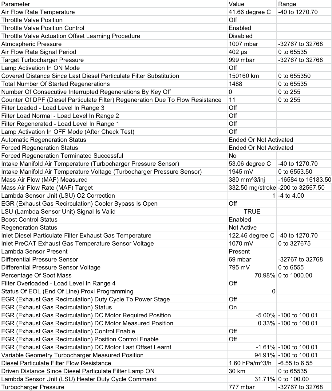

However, all reference data appears to be within permitted levels. You can see the attached output for reference.

Another thing is the 70.98% Soot mass and also the "Forced Regen Terminated Successful...No.
This would make me suspicious of a DPF issue, especially if your driving is generally short low speed town usage?

Thank you for pointing out the soot quantity. I restarted the forced regeneration using the Multiecuscan software with the vLinker FS Bluetooth adapter. After performing the procedure, the soot mass reduced to 11%, and I cleared all error codes. Following this process, the vehicle stabilized, and its performance was restored. Additionally, the P0238 error has not reappeared.
