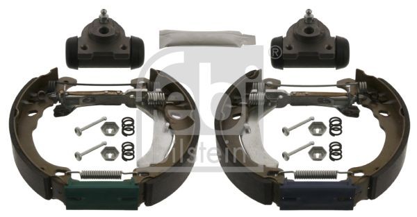

A kit with shoes clips et al. and cylinders is the cheapest way I find

Thanks for the input, everyone. I've ordered a full Febi shoe kit with cylinders. I suppose it'll be good to have all the parts in case something else turns out to be broken (or I break it!).

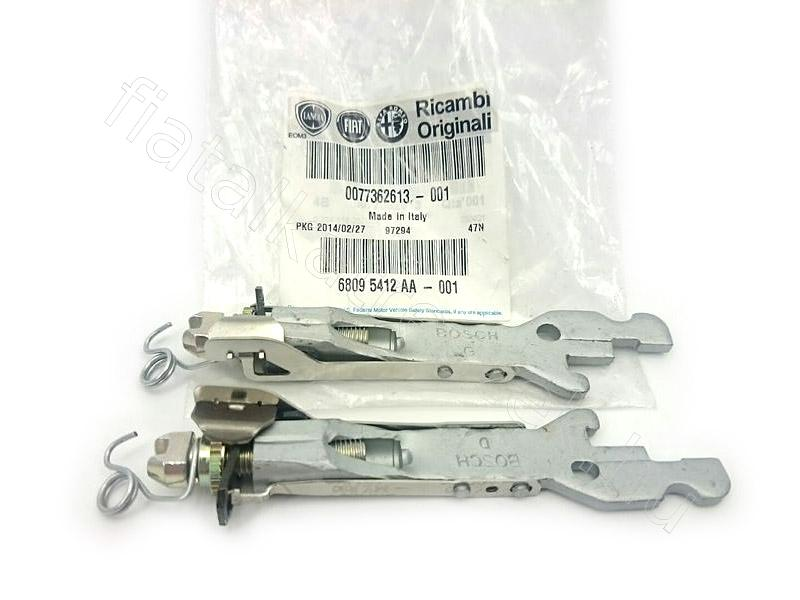

Finally made some progress with this today. I replaced the wheel cylinder, adjuster, and the shoe retaining pins.

Yeah, the adjuster was also broken on the other side (pawl disappeared), so I replaced that and the wheel cylinder (only half working/starting to leak). Now the handbrake is much better balanced between the two sides after adjusting the cable.

Mine failed MOT on weak handbrake. I bought new shoes but was given the wrong parts. The adjusters have no visible signs of wear or corrosion but were clearly not adjusting themselves. I wound the adjusters back a few clicks, refitted the old shoes and set the adjusters so the drums were a close fit. The adjuster knurling is accessible through a wheel bolt hole. I used this to set brakes for no binding.
Set handbrake cables for a reasonable lever pull and refitted the centre “console”.
It passed MOT no problem.
What I found with the adjusters was that the pawls had disappeared (no. 9 in the diagram here - maybe fell off and disintegrated over time?), so they would not adjust themselves at all. I noticed one of the adjusters was stamped Bosch so maybe they were the originals. Handbrake works great now after replacing them.
