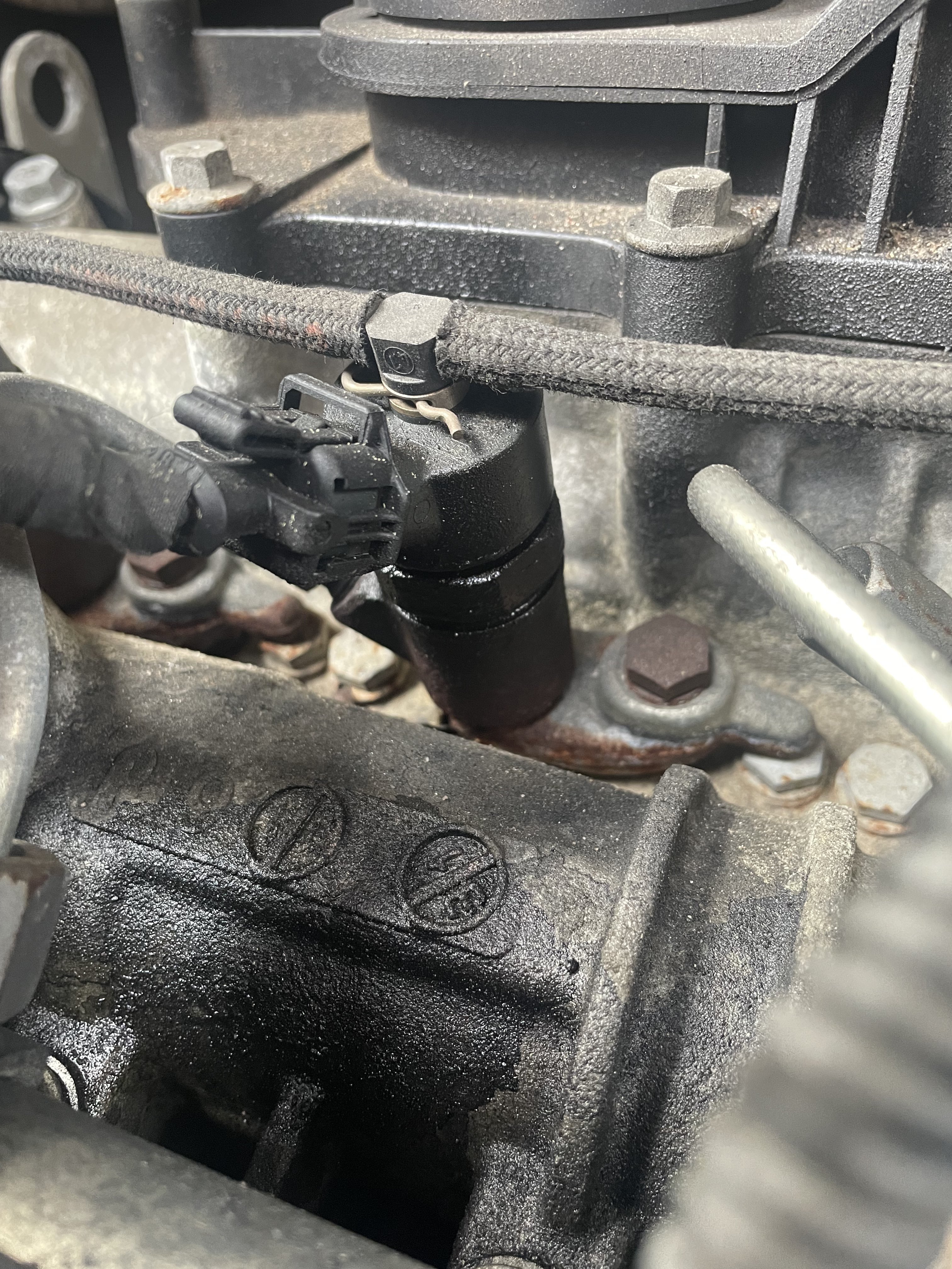

I don’t know if this has a yo thing to do with the misfire/rough idle but it seems as though one of the injectors has maybe a weep, as all the other 3 are dry?…
