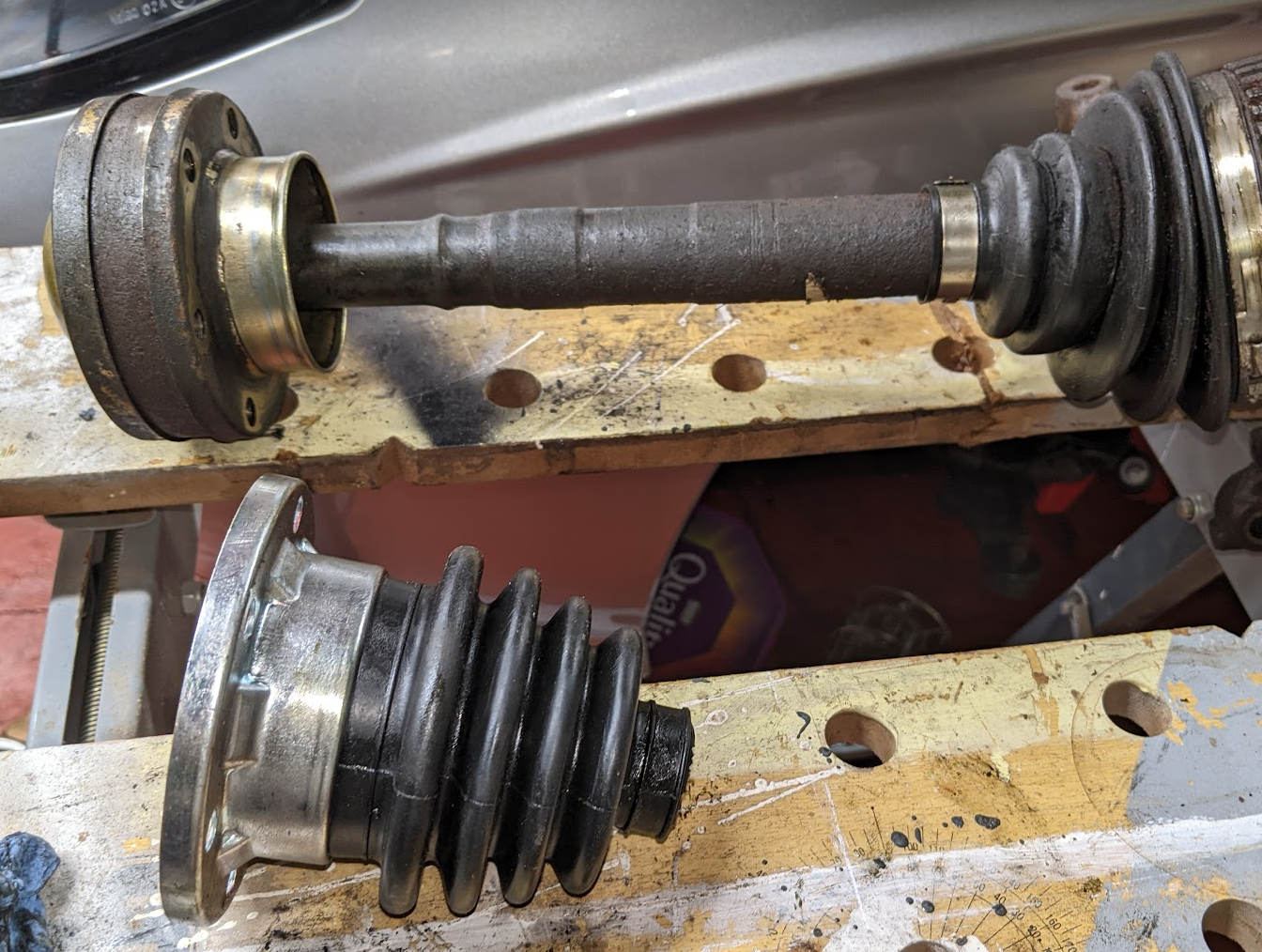

I've got the drive shaft out from under the car and it looks like this:
Does my new boot replace the brass coloured piece on the CV joint? If so, how do I remove it? I don't know whether those brass coloured pieces should remove easily or not as they don't seem to move and I don't want to apply unreasonable force if they're not supposed to come off.

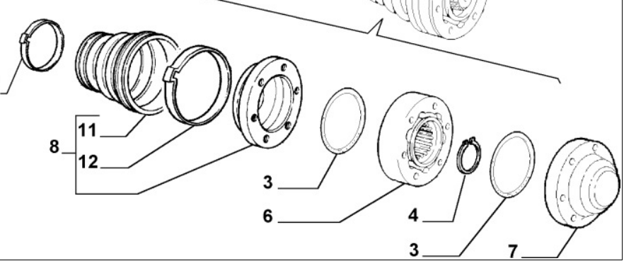

I took a look at the ePer diagram to help me. I believe that the part on the extreme left of my photo is part 7, the rusty part inserted into that is part 6 and my new CV boot is part 8.
Based on all of that I think I should be abe to tap off part 7. Remove the circlip (part 4), slide part 6 of the drive shaft, put my new boot (with grease) on to the drive shaft and then put part 6 back on, add the circlip and then part 7.

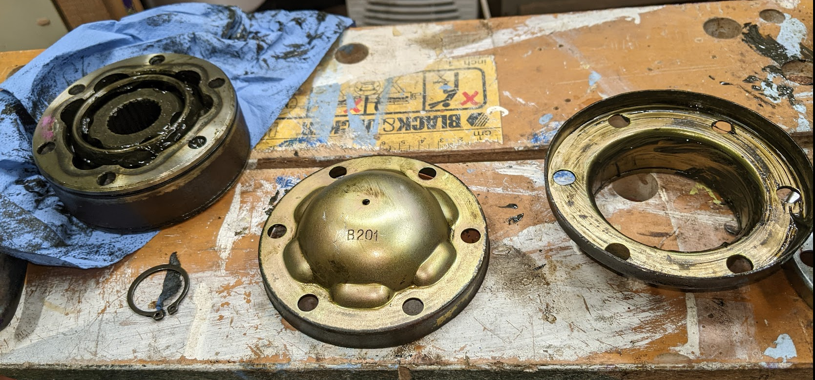

Persuaded myself that those ends should tap off and with a little encouragement with a hammer they do. For anyone who is interested the inner CV join breaks down like this:

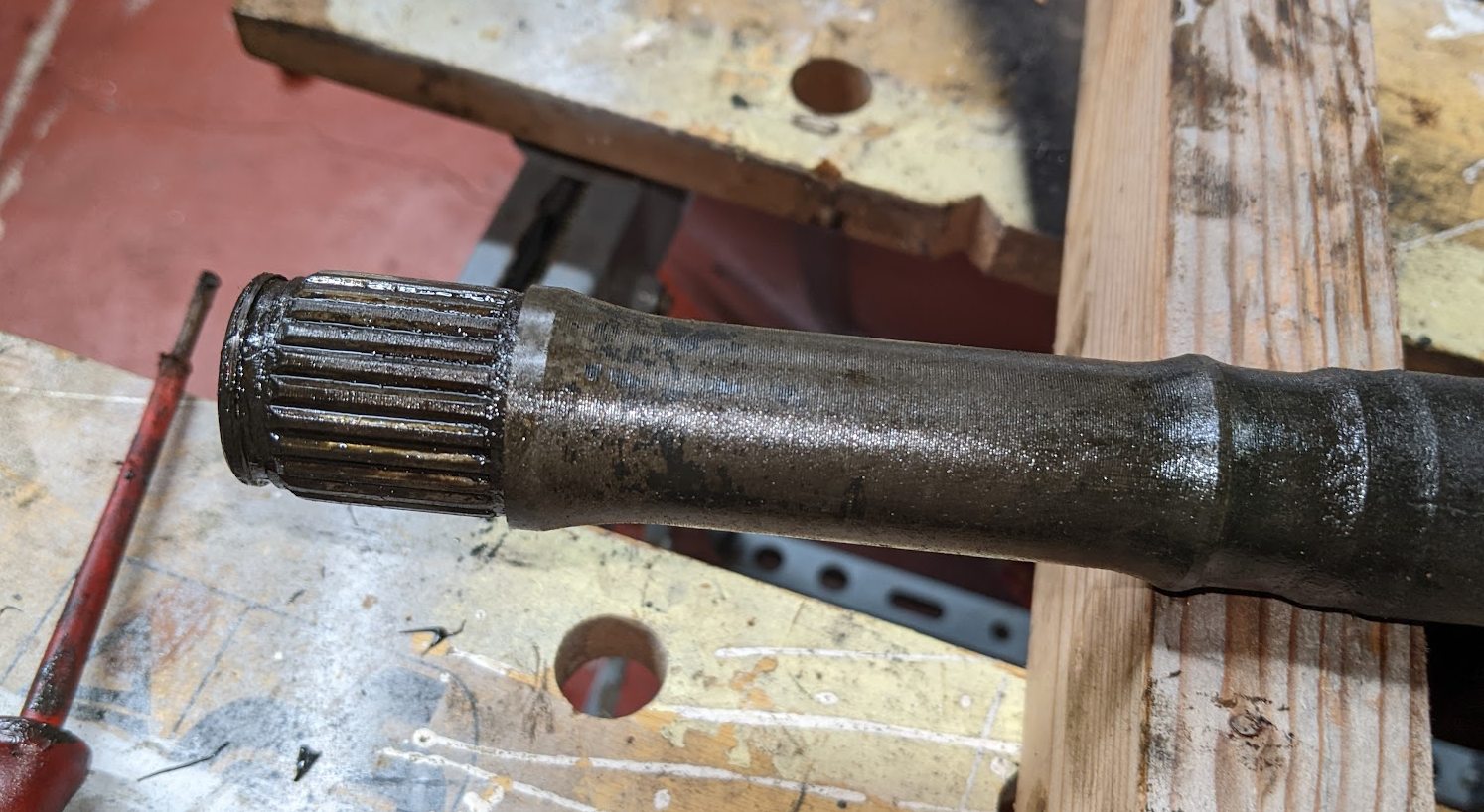

The part in the centre come away first and then the small circlip holds the CV joint onto the shaft (groove shown below). There are rubber seal inset into grooves in the side of the joint that keep everything snug.

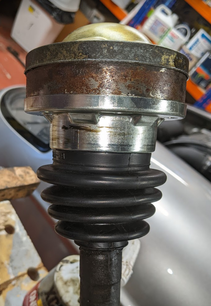

My new boot replaces the part on the right and so the assembled joint looks like this
I just need to get a clip for the boot on to the drive shaft and it's done. Oh and clean black grease off the pile of tools I've used. I'm going to order the lower arms today and then I can get the car back together and ready for MOT at last.
