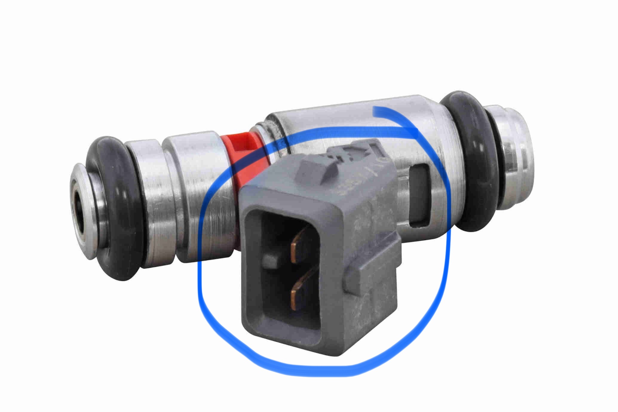

I need to replace one of my fuel injectors on my 2007 1.2 Panda Dynamic
Somehow the bit circled in blue has snapped off, meaning it’s getting no power rendering it useless while giving me a misfire. Can I please get some guidance on how I change it? I only need to order&change one.

Injector on petrol are not coded
As long as the the part numbers match change one is fine
Perfect that's good. Any advice on how to change one? How hard of a job is it? The injector itself is fine but I have no choice than to replace it because the connector has somehow snapped off.
It is a fairly easy job.
Here is a video about it
You don't necessarily need to take the fuel line out of the injectors rail like in the video. It can be done by letting it connected and just pull out the injector you need to replace after you've pulled all the injectors out of the manifold and removed the safety clip on the injector you’ll replace.
It's pretty hard to damage the injector
