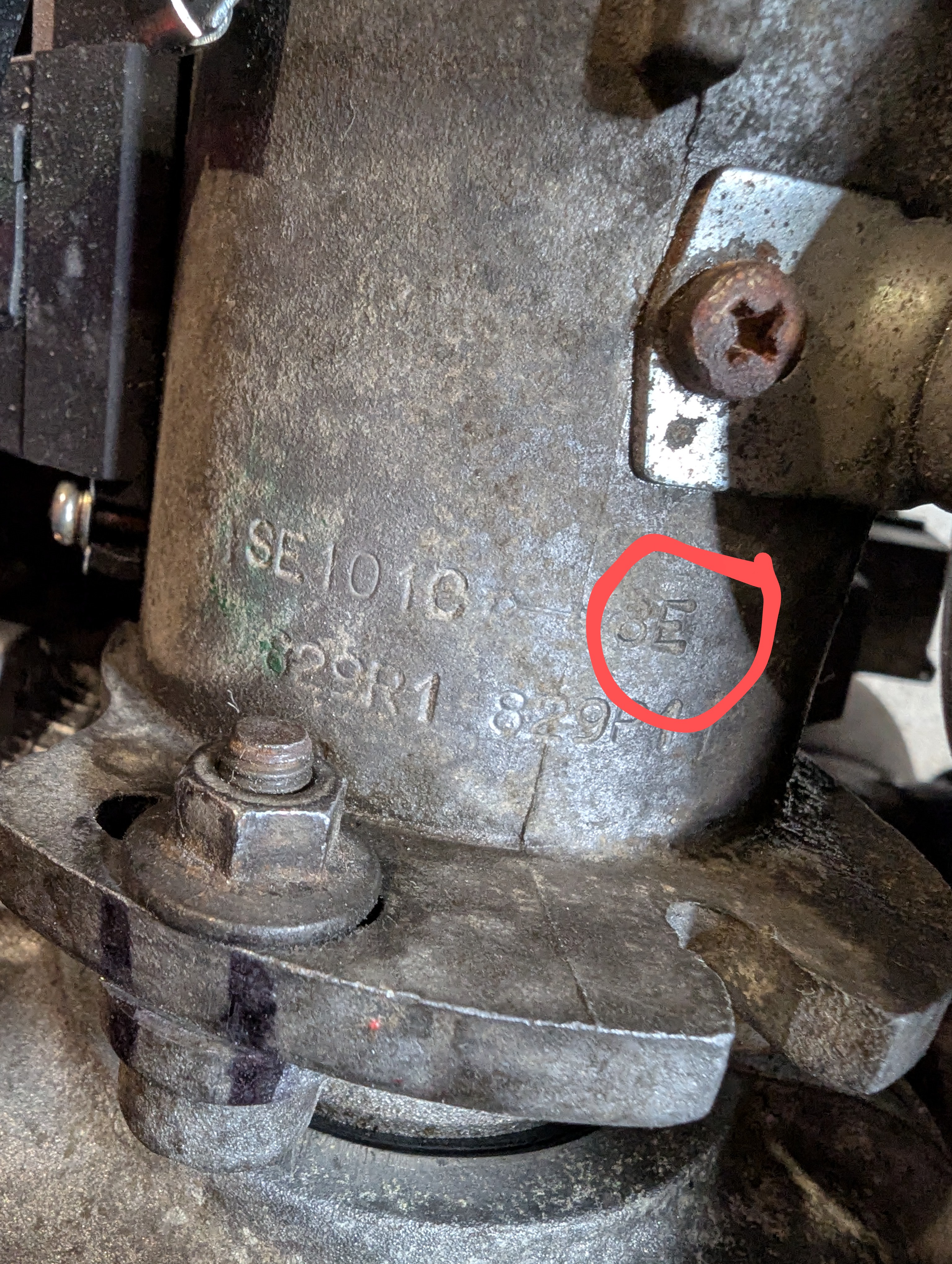

Hi, Who can help me with this question? The ignition distributor of my Fiat panda 1000ie fire 4x4 from 1988 is broken. It makes a sound as if something is rubbing. I would like to buy another one. The choice is a new one of Chinese make or a second hand one. I have already bought a Chinese ignition distributor once but it was of poor quality. The earth wire was loose and the plastic cover was broken. Maybe I was just unlucky and it was a coincidence that it was so bad. If I buy a second hand one you also do not know what the quality is exactly. And the difficulty which one exactly fits my car. The number on the part is SE101C- 8E 829R1 829P1. I come across a lot of them where all numbers are the same except for the two numbers after SE101C - ....... Who knows how much those last two numbers matter?

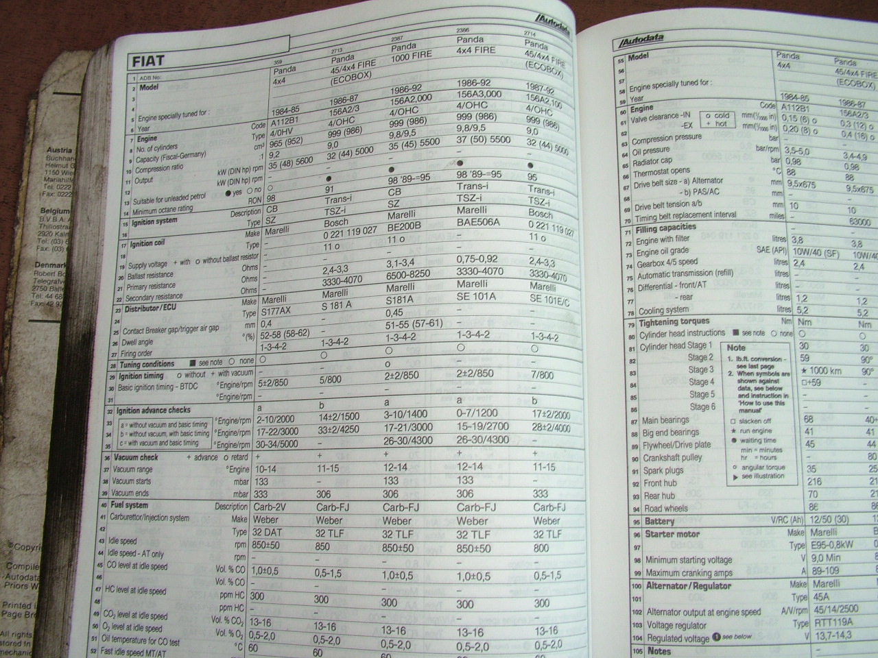

I notice further down the page there are different advance details etc. for the different distributors.
I suspect the last numbers are less relevant.

If you look in my photo of manual above you will see the two most likely distributors for your engine are electronic already.

Than I guess I already have an electronic ignition. I hope that someone knows more about the impact of the two letter and number combination behind the SE101C. Than I can look for one and order it.

First check your engine Series Number as if you look at my photo of manual there are only two significant versions so unless yours is the low powered "ecobox " version then all you need to do is look for the SE101A, as if you go for the other ones they "detune" the engine with less ignition advance etc. As the details I have given will show you. Check which of the last two columns relate to your vehicle.
The numbers that are in my Motor Trade Manual are the significant ones you need when ordering the part, I doubt whether there is much information available these days on those other details.:)

I have just checked on other pages and it appears you have had an engine change at some point, assuming that number 156A2.246 is from your actual engine as that number indicates a Panda 1000 ie Kat and doesn't describe it as a "Fire" version and certainly not for the 4x4, but suggests the distributor should be a Marelli SE 101C. See photo below.:)
