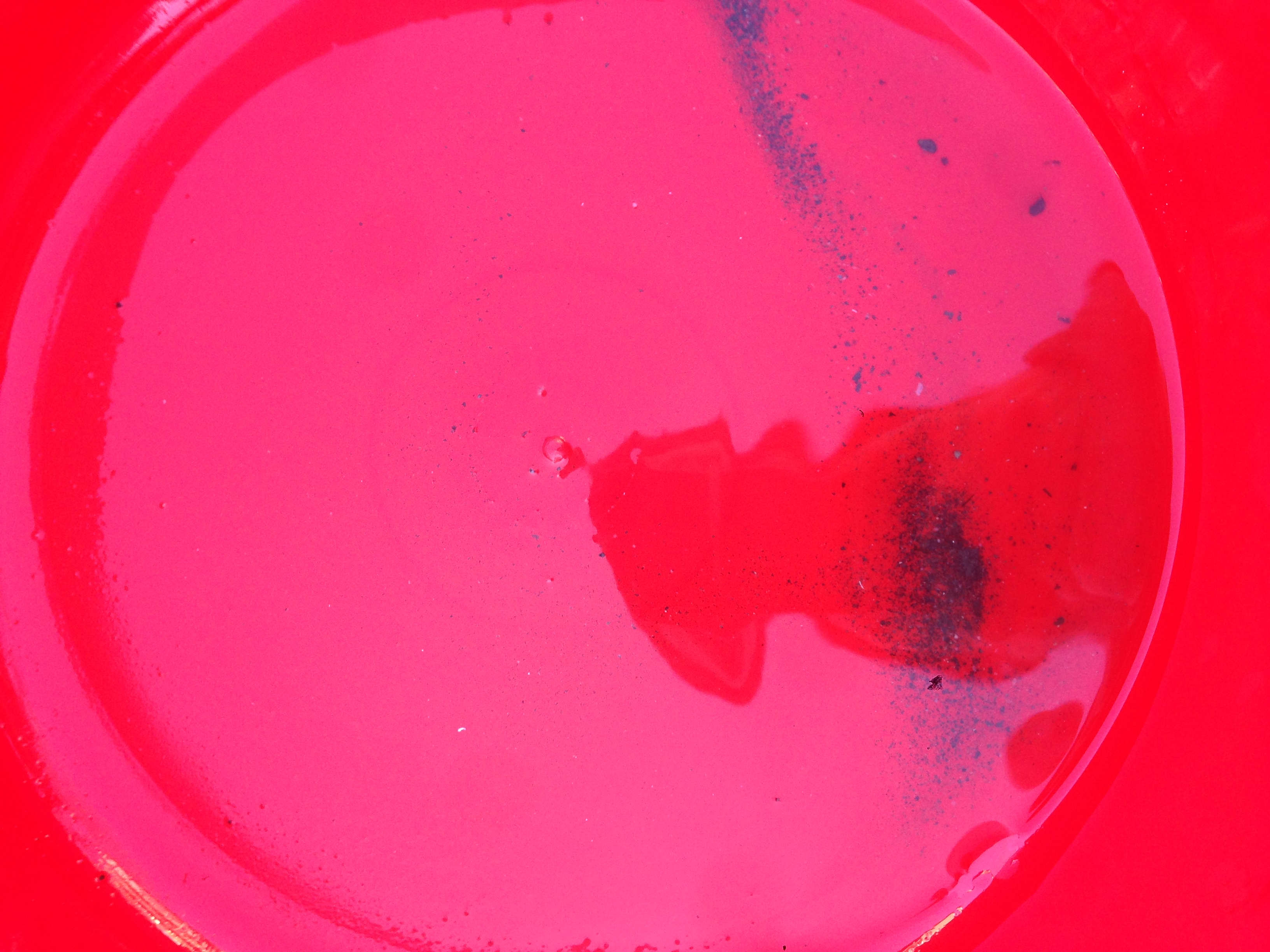

[FONT="]I washed the cooling system with this mix of water + lemon salt. I drained the antifreeze, I boiled 4 L of spring water (in order to deposit the limescale on the resistance with which I heated it and not to wait too long for the engine to cool - mandatory if I put cold water! do wait for engine to be cold. DO NOT PUT COLD WATER ON HOT ENGINE because that can cause cracking of engine block or cylinder head) I put in it 400 g of lemon salt and (with slightly cooled water, not directly boiled) I put it in the system. The 4Ls came in almost perfect, there was little water left, the aerator was open. I started the engine and when it warmed up too (very quickly, the water was hot) it was already warm inside the car. I ventilated (bleed out air from the cooling system) and filled up water to the correct level. I kept the engine running for about 20-30 minutes; I was amazed at how well it warms up. At idle, the air heater on stage 2, 3 or 4 gave off heat. When I revved the engine up to 2000RPM, air got very hot. Sounds began to be heard from the radiator, there was still air or the dirt was dissolving. I stopped the engine, left it for about an hour, then again. First of all, I looked in the radiator, what the water looks like. It was no longer clear how I put it, but brown and very bad smelly. Here is a picture with how it looked like, when I drained it out: [/FONT]
[FONT="]https://ibb.co/JyLHLcN[/FONT]

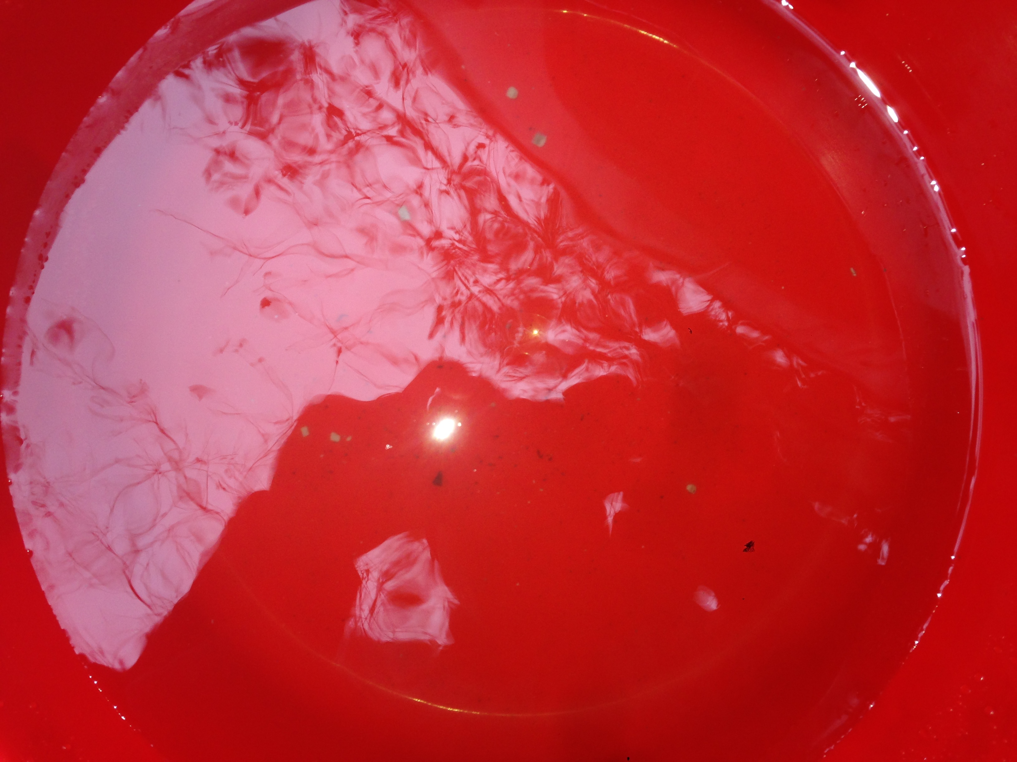

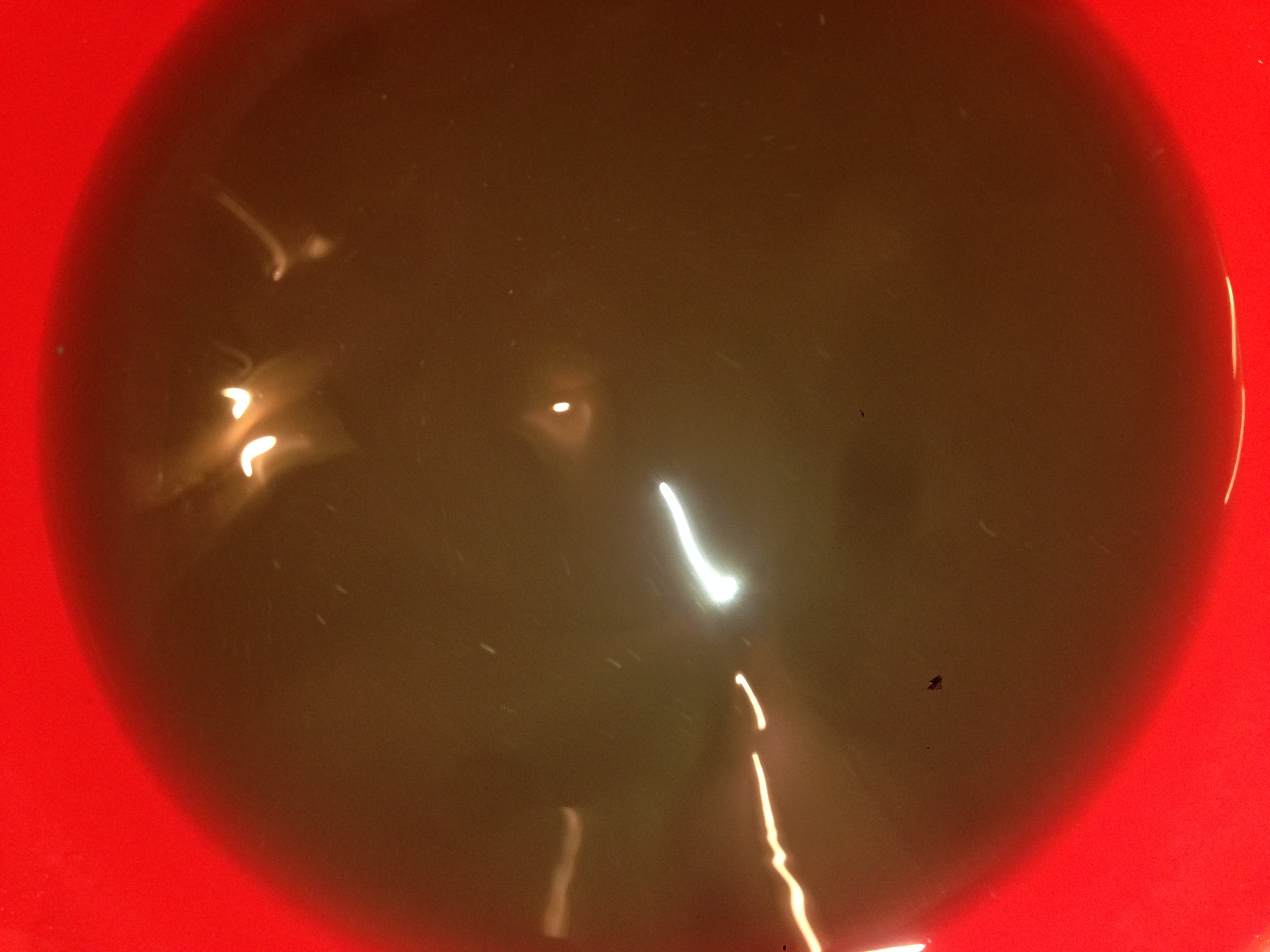

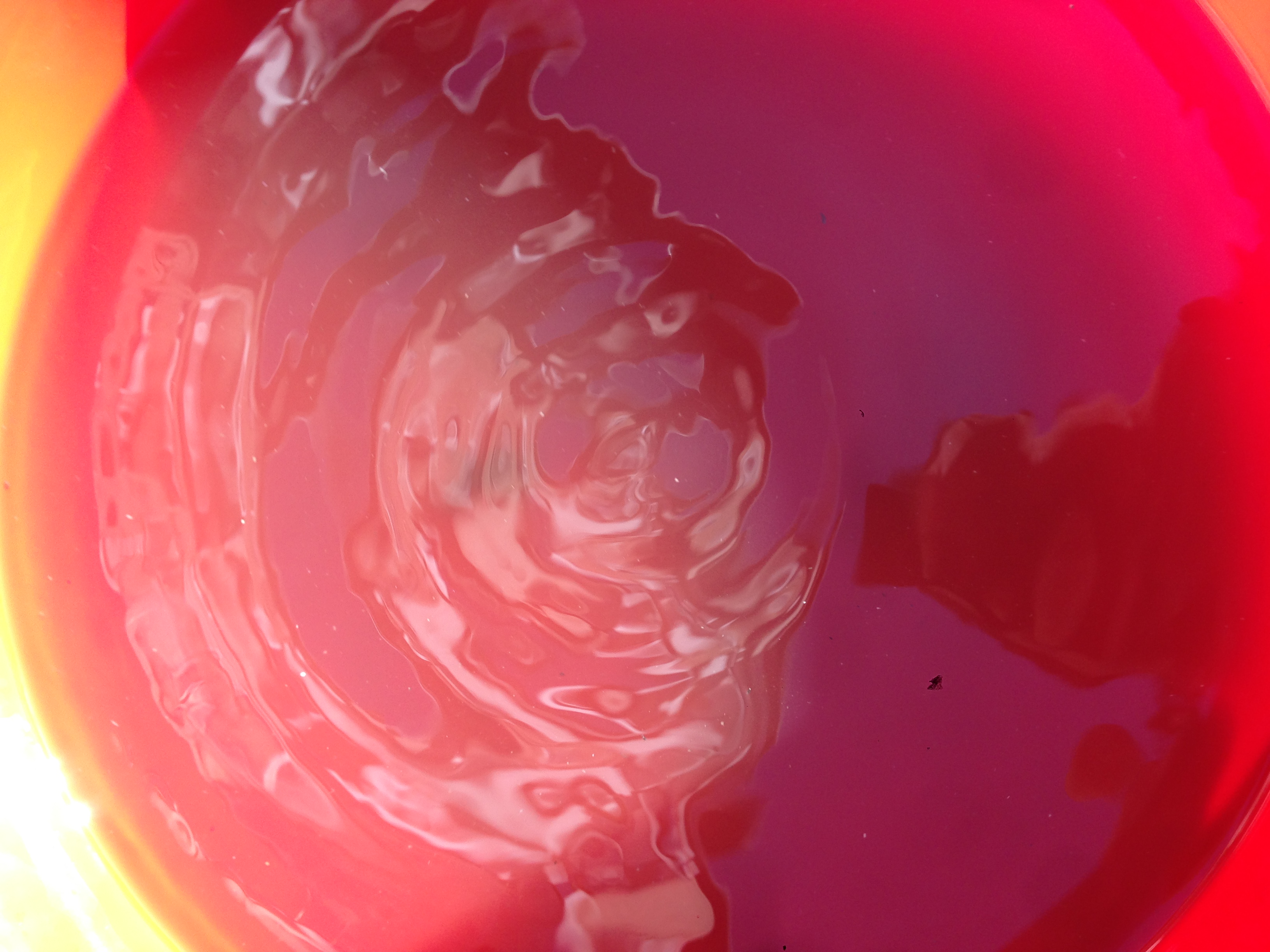

[FONT="]Then I rinsed the system 2 times, with softened water. It helps if you drive the car around a little because there is still dirt in the system and running with water on cooling system, it gets cleaned. This is what water looked like after first rinse and the dirt that came out:[/FONT]
[FONT="]https://ibb.co/WsrD36q[/FONT]
[FONT="]https://ibb.co/CnPDkBk[/FONT]
[FONT="]And this is how water looks like after the second rinse:[/FONT]
[FONT="]https://ibb.co/qkbxCrF[/FONT]
[FONT="]Then I drained the water out and I filed up system with antifreeze. done the bleeding out air and the heat works like magic inside the car.[/FONT]
