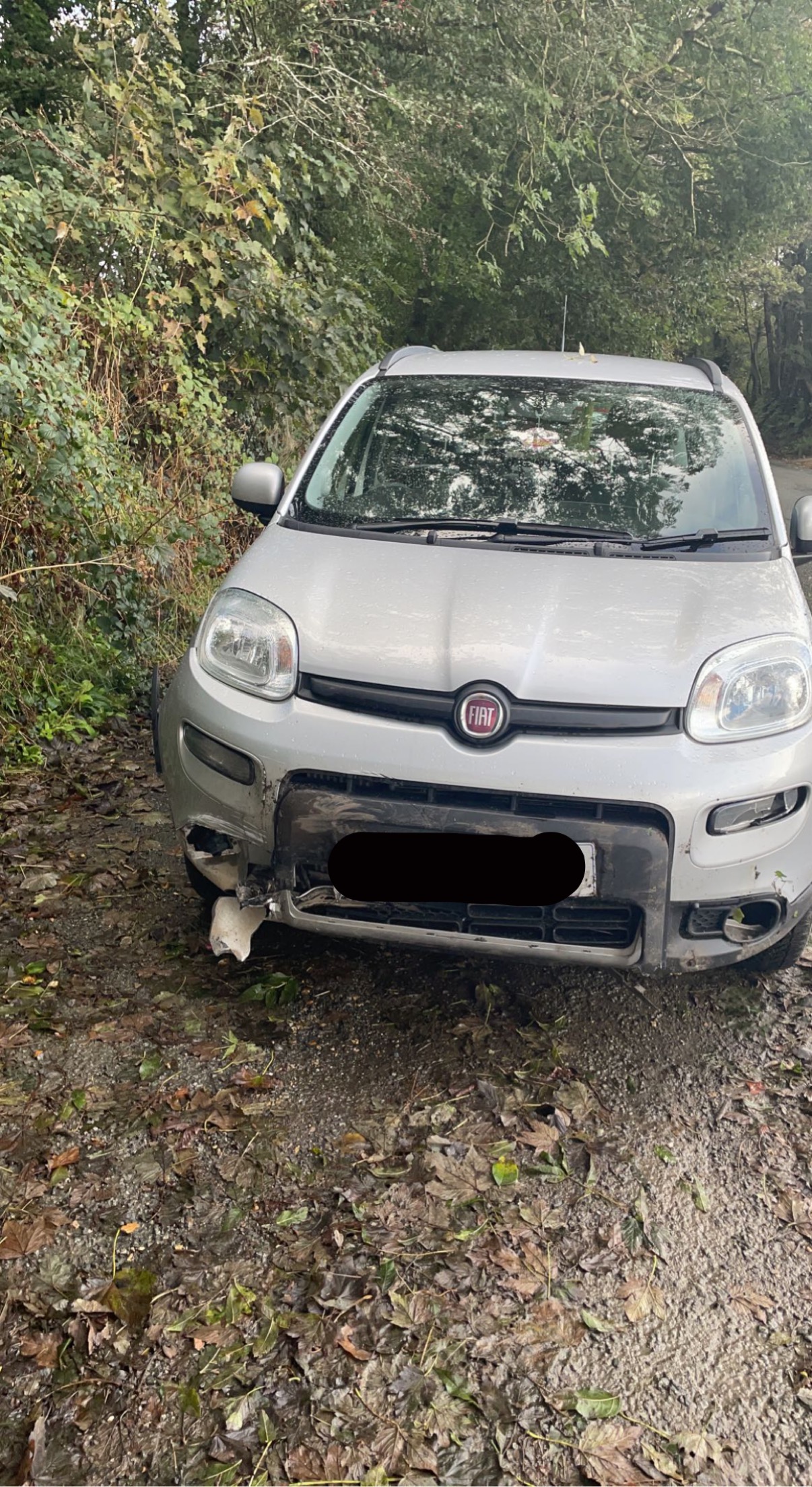

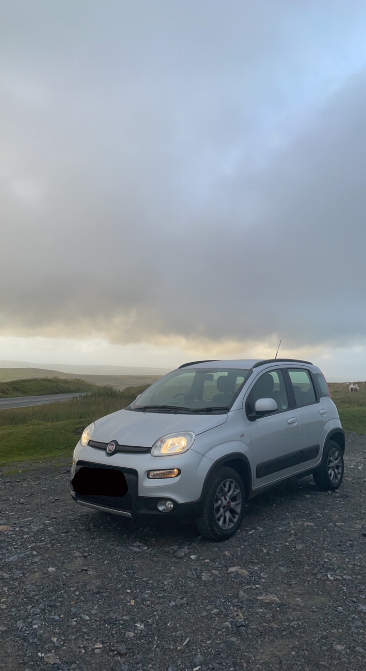

I crashed my Panda 4x4!
It’s been a good few months since it happened on a Domino’s run (third party cover only) but I’m yet to get her fixed as I am not making an insurance claim.
I’ve got all the parts I need except both of the front fog light grill covers and the chrome trim that accompanies them.
Does anybody know the part number to the 2012+ 4x4 fog light surrounds/trims/grill covers? Alternatively, if anybody has any for sale, or knows where I can source the used fog light surrounds I badly need, please get in touch. There are some available on eBay (at near OEM price) however I’m trying to save as much money as possible as I’m paying for all the repairs myself.
I have contacted my local dealership who I have bought 10 cars through in the last 8 years, yet they still refuse to give me a parts number, hence why I am approaching the forums for help :)
Attached is an incredibly depressing before and after of the crash.
Drive safe out there!
