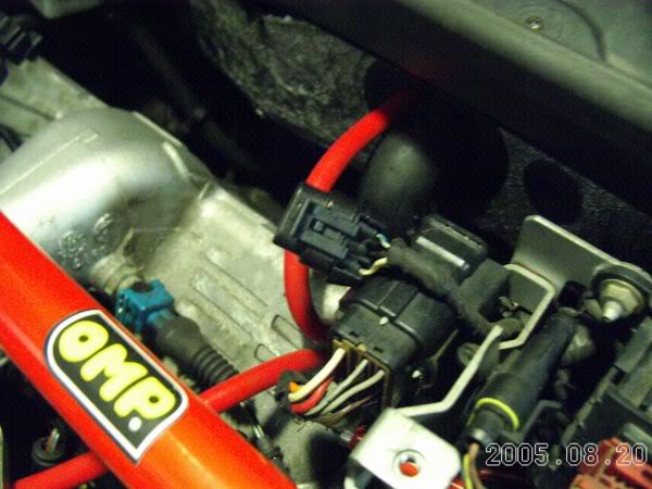

Procedure:
1: turn the ignition key to MAR, without starting the engine
2: find the 3 pin diagnostics port located at rear of engine bay under the plastic cover (see pic).
3: Remove the cover (if its still there) and find the pin which has a blue/white wire. Stick one end of your little length of wire in the pin with the blue/white wire and stick the other end to earth for 4 seconds - the inlet manifold is a good bet for the earth as its right there next to the diagnostics port. This will start the readout process:
