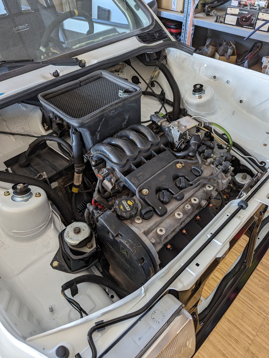

Hey you all!
Sorry for lifting this from the dead, but has been such a resourceful thread that I thought I might get the best help here!
I'm currently in the last stages of swapping my 1242 16V/C514 gearbox combo and am not able to get the car started. Picture is just some eye candy, current state is further along! ;)
I'm as far as when trying to start the car the starter is cranking, as well as the fuel pump priming!
I think I wired up the code box as well as the Punto engine loom side the correct way, I even added a bulb to the blue/white cable of the code box to check things.
With the key in the off position it blinks constantly, when turning the ignition on it ever so slightly turns on very dimly for a split second (Less than Dragon Man descried/showed in his video) and then turns off entirely - so I'm still assuming the immobilizer is being lifted.
Since the fuel pump isn't priming with the Punto key removed from the aerial, but does so with it in place, is another reason for me believing that the immobilizer is being lifted.
I'm also relatively sure I hear the white relay box clicking (am alone, so trouble shooting isn't as straight forward while turning the ignition or cranking).
Also checked that the ignition live from the Panda loom (in my case a blue cable with black dots going into orange/white at the original Panda plug) stays on while cranking with a multimeter.
Is it correct that the red cable from the Punto loom isn't used at all and the red/black one is sufficient for constant power?
Just to be certain, this is how i connected everything:
Red/black from Punto loom together with red from Punto code box to battery + on Panda with 30A fuse (constant live)
Orange from Punto loom together with orange from Punto code box to blue/black (later orange/white) on Panda (iginition live)
Black from Punto loom together with black from Punto code box to chassis earth on Panda (earth)
Brown/white from Punto loom to brown/white on Panda (fuel pump)
Grey/green from Punto loom to grey/green on Punto code box (ok signal)
Left untouched on Punto loom:
Red, green/white, pink/yellow, blue, blue/black, grey/yellow, grey/black, grey/white
Any ideas where my problem could lie, or what else to check?
Thanks heaps all of you, really looking forward to finally drive the finished car! :)
All the best from Germany!
Fabian
