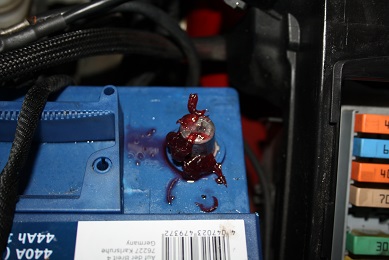

Step 1. Disconnect battery negative terminal
Secure the disconnected negative terminal from any contact
