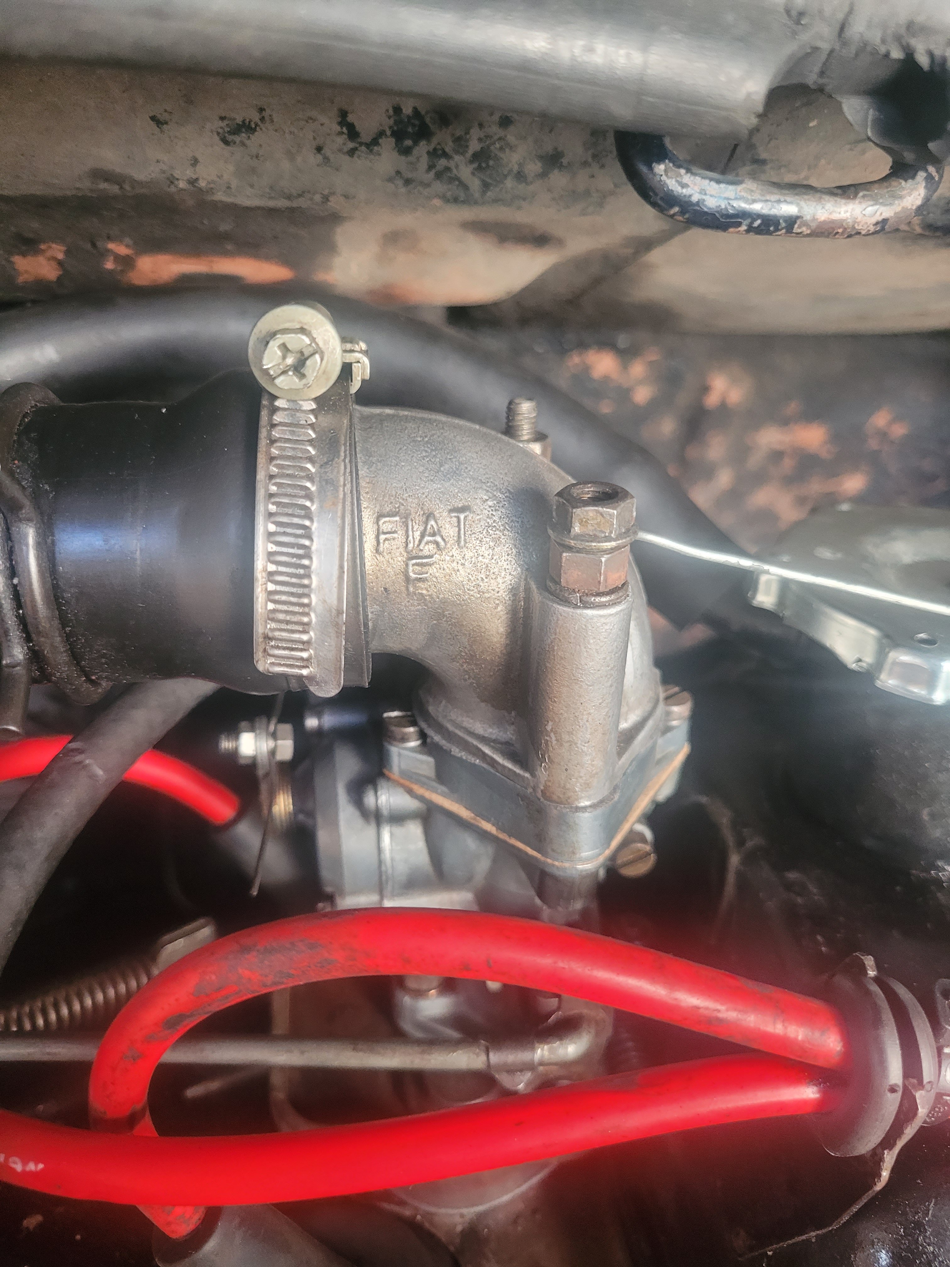

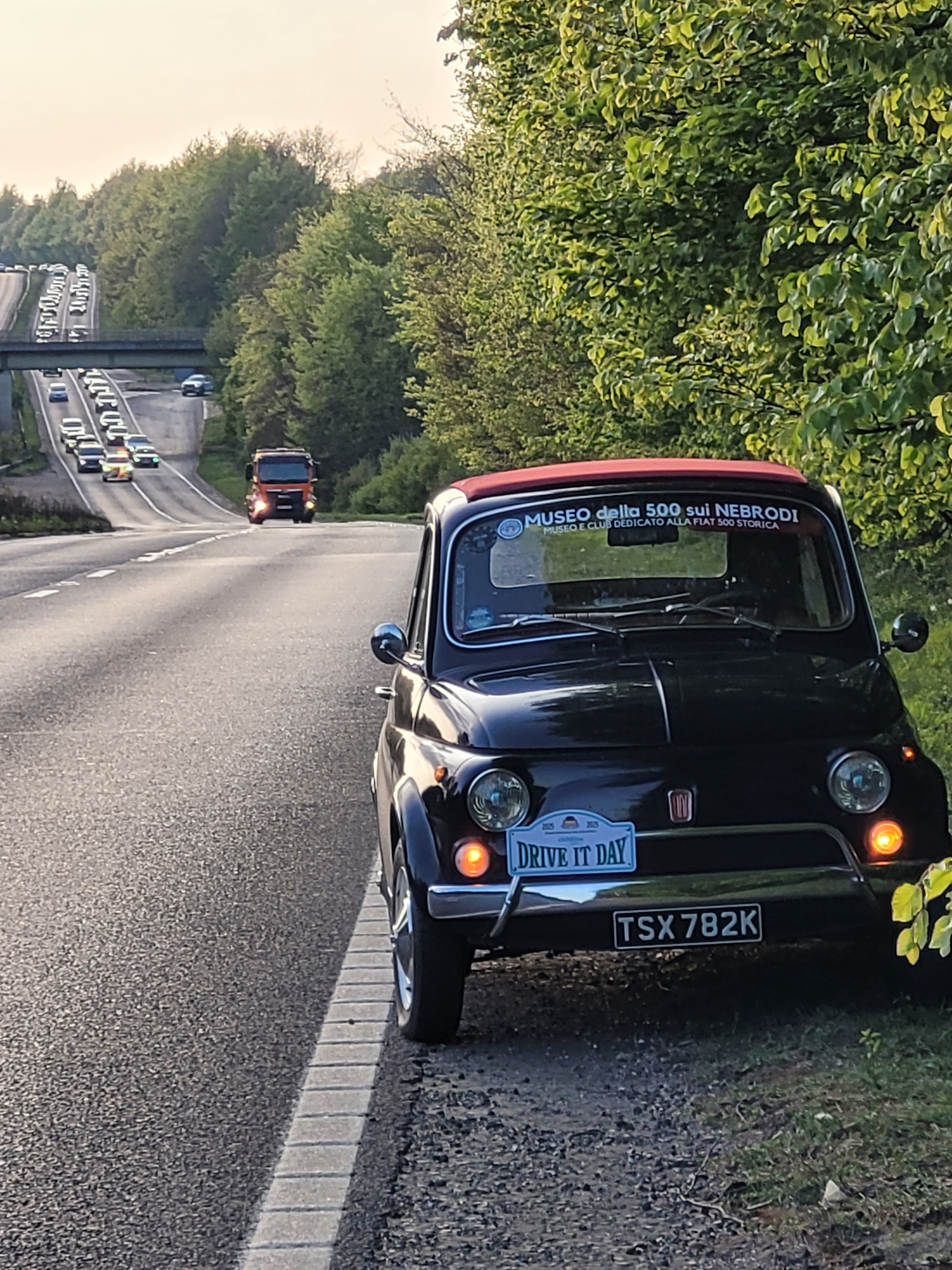

We had a great run out for the FBHVC/NSPCC Drive-it Day today with Overton Classic Revival, ending up at the Crofton Beam Engines site in Wiltshire.

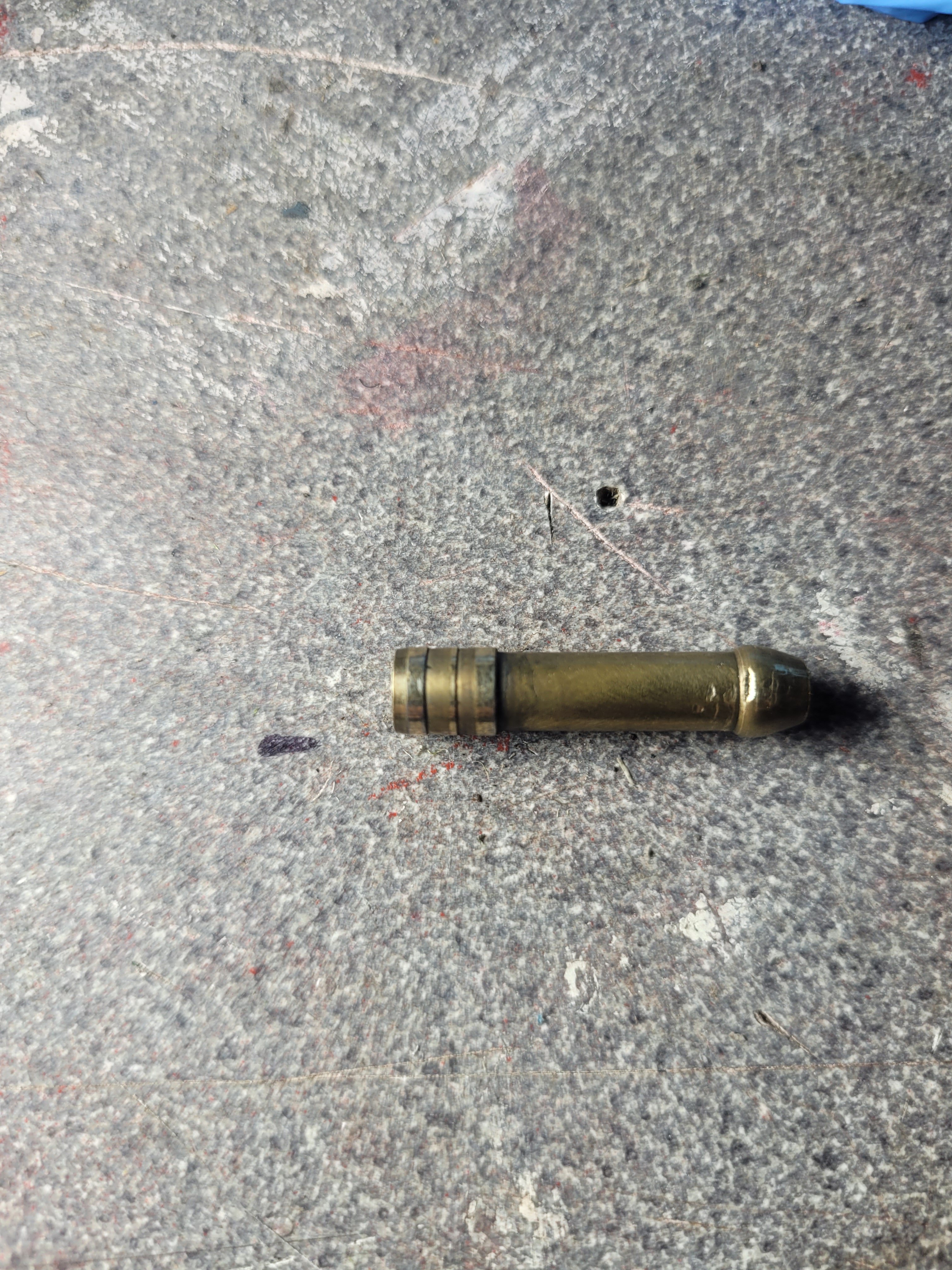

Long story short: on the way back on A303 doing a comfortable 60+mph it suddenly lost power. I managed to pull off the road onto the verge and it quickly became clear that the top fuel hose feeding into the carb had come off and must have been spewing petrol all over the engine bay 😬. Looking at it more closely, it wasn't that the hose clip had given way but the whole brass connector (the ridged connector piece) had come out of the carb itself. Thinking back, there has been a bit of a fuel smell in the engine bay since I've had the car (3 and a half years), so presumably it has been working loose for a while.
So: is it fixable or do I need a whole new carb, or new head part?

It is a known issue! I caught mine before catastrophic failure, fortunately.

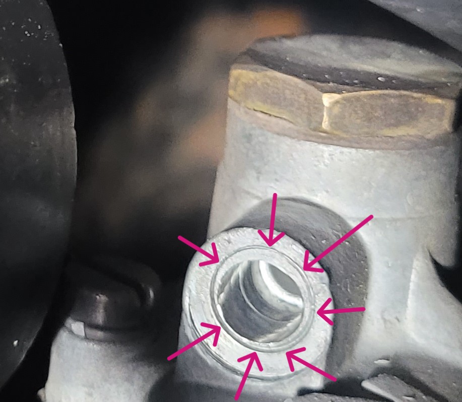

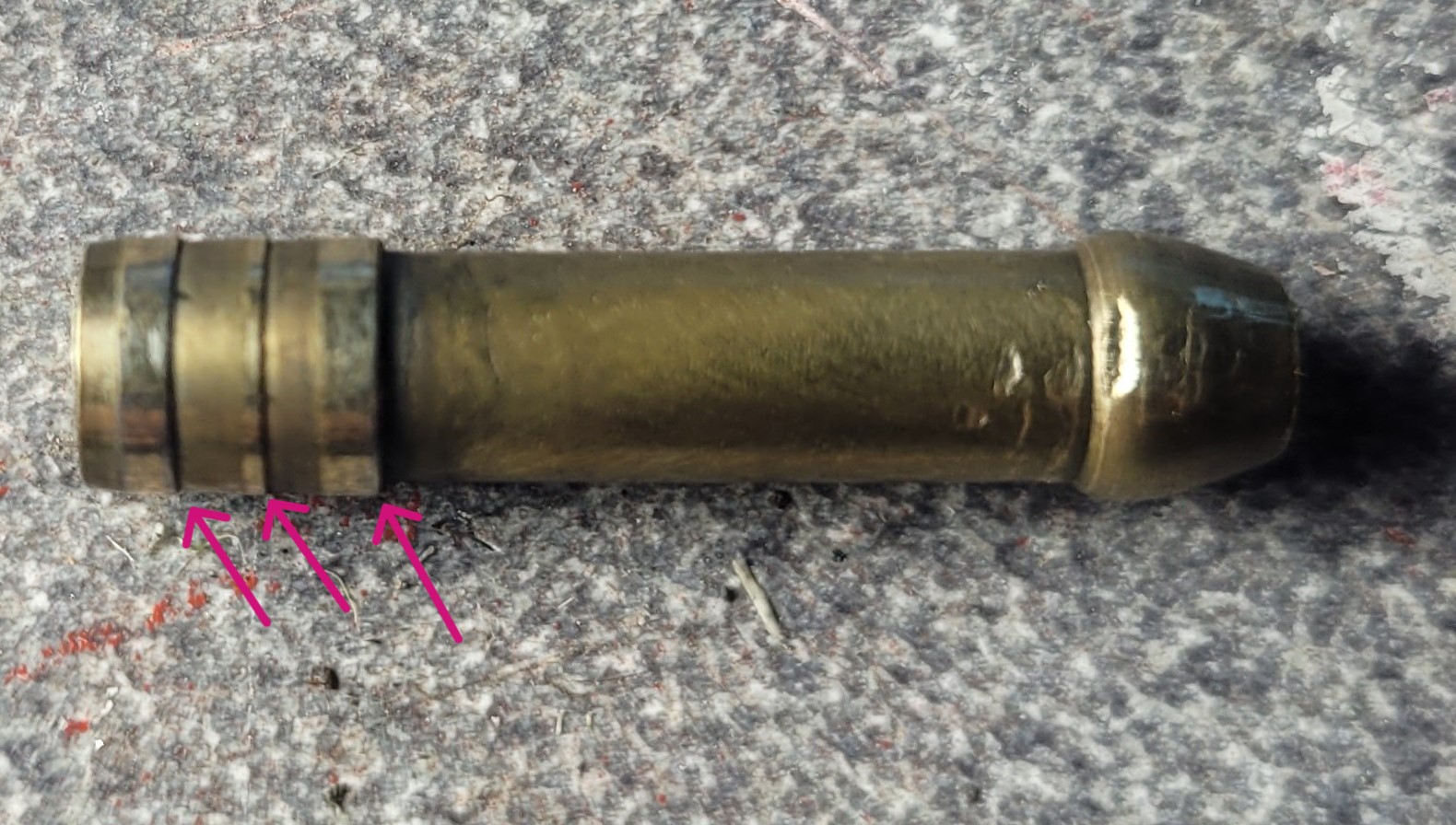

repaired mine by thoroughly cleaning out the hole in the alloy carb cover, lightly 'keyed' the brass spigot and used a JB Weld-type epoxy metal to refix it. Just ensure you don't get the epoxy in the tube (I applied a thin ring around the spigot before inserting it, rather than putting adhesive in the hole on the carb.)
It has lasted well for four years so far.
Alternatively, you can buy threaded spigots, which you'll obviously need to tap the hole for.

Reuse existing brass "spigot" using method described by Ant Knox.
