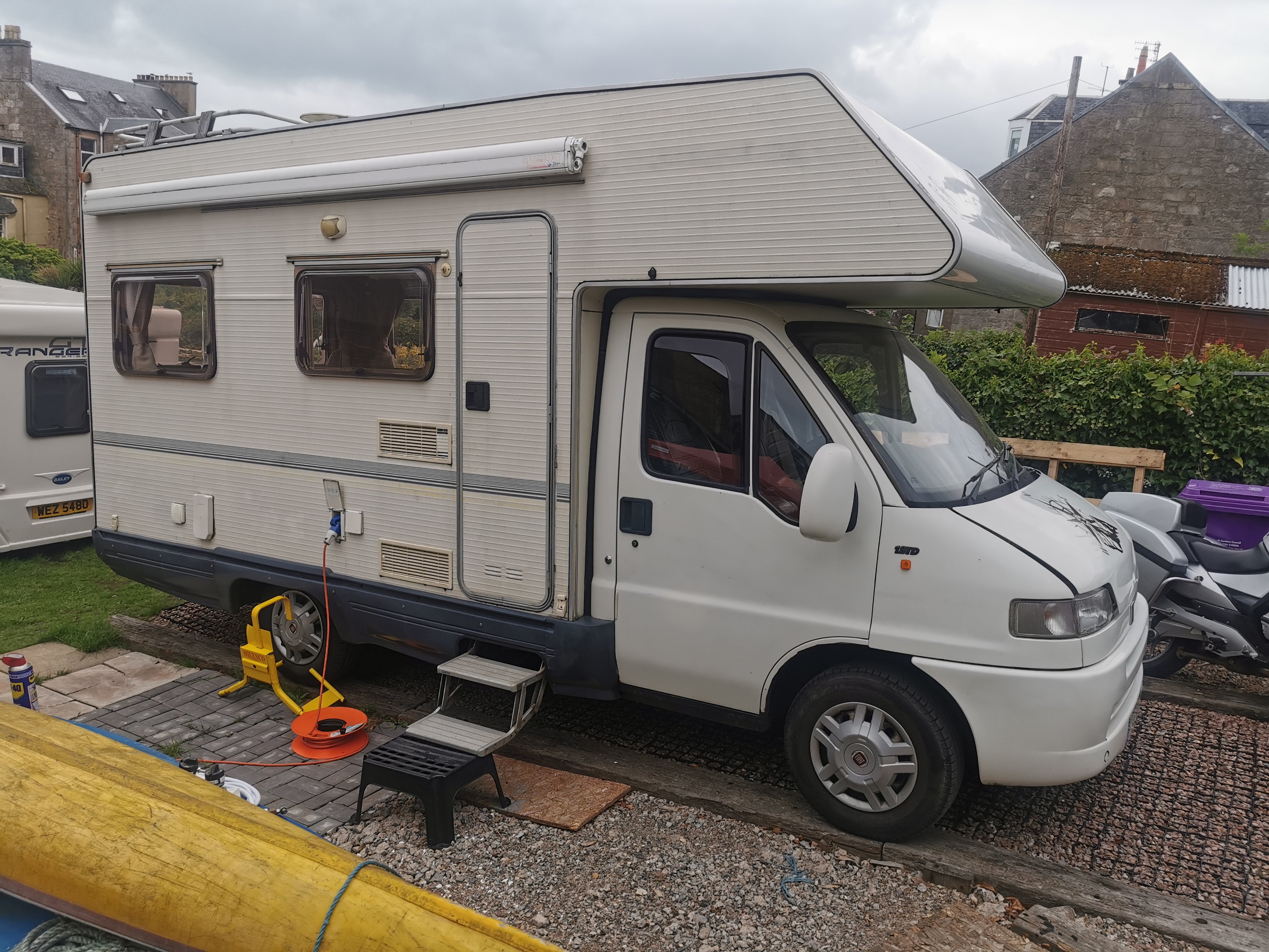

Totally confused by the number of gearbox options.

Should have said it is a 1999 model.
It did come with lots of history, not all good, gearbox been repaired and replaced at least a couple of times but the timing belt is fairy recent(?) need to check the dates again!
It was a spur of the moment purchase in June, to use as a dayvan, odd overnighter, as we also have a caravan.
Bought knowing the gearbox struggled to engage first gear when cold but would improve when warm (or warm plus switch off)
Been sitting since purchase and now looking to start using it and hope the gearbox can be improved before going for a refurb gearbox option?
