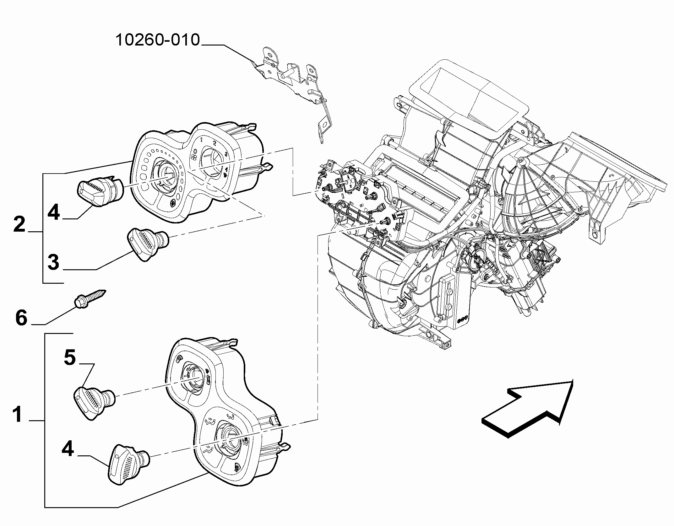

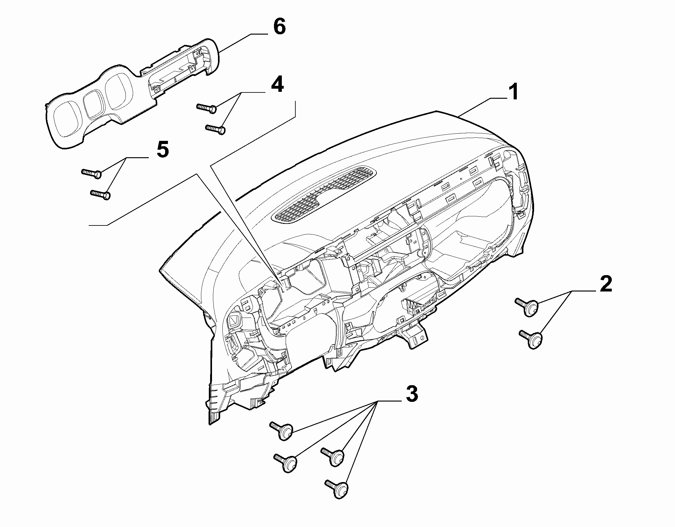

Between the back of the radio and those buttons is most of the workings of the heating system - the ducting and the control cables from the rotary controls.. So, while in principle there's a way through, there are several oddly shaped things in the way! These images from the ePER parts catalogue (here: https://eper.fiatforum.com/en/Groups/F/F/GIN/33) might give a clue. One shows the underside of those buttons too. The whole trim panel around the gear-lever (which includes the window buttons and those two smaller ones) can be released and lifted upwards by releasing the clips with a pry tool, and then you can push those buttons up from underneath. Or, as TPN says, just the plastic frame for the gear-lever gaiter itself can be released with care and you can reach through to under those buttons.
