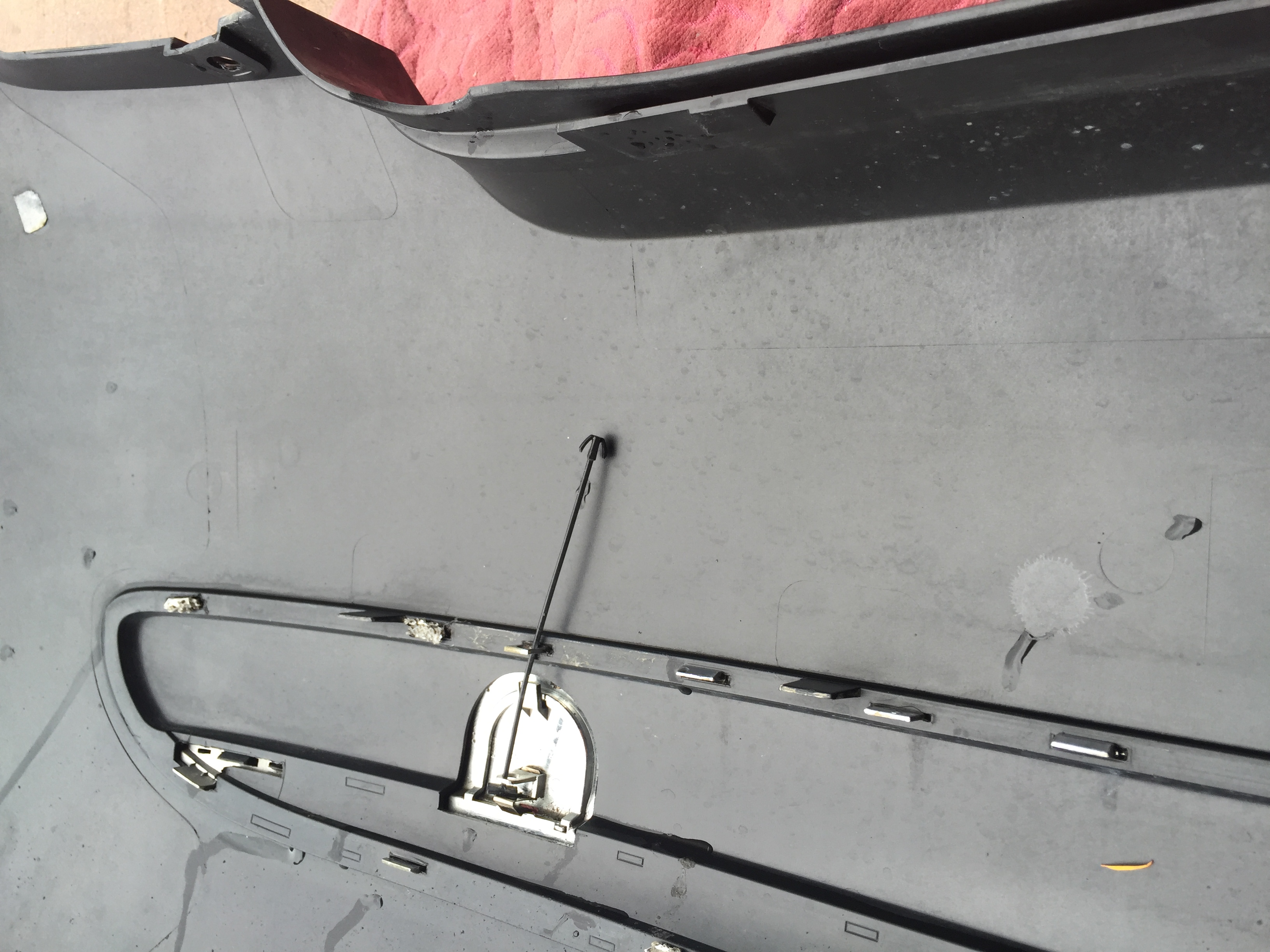

My bumper (2008 Lounge) had very faint circles as shown below. You can just make out two in the picture - one near the outermost chrome tab, and one near some splatter mark.
Easy enough to drill a 3mm pilot hole and then use the hole cutter from the other side.
