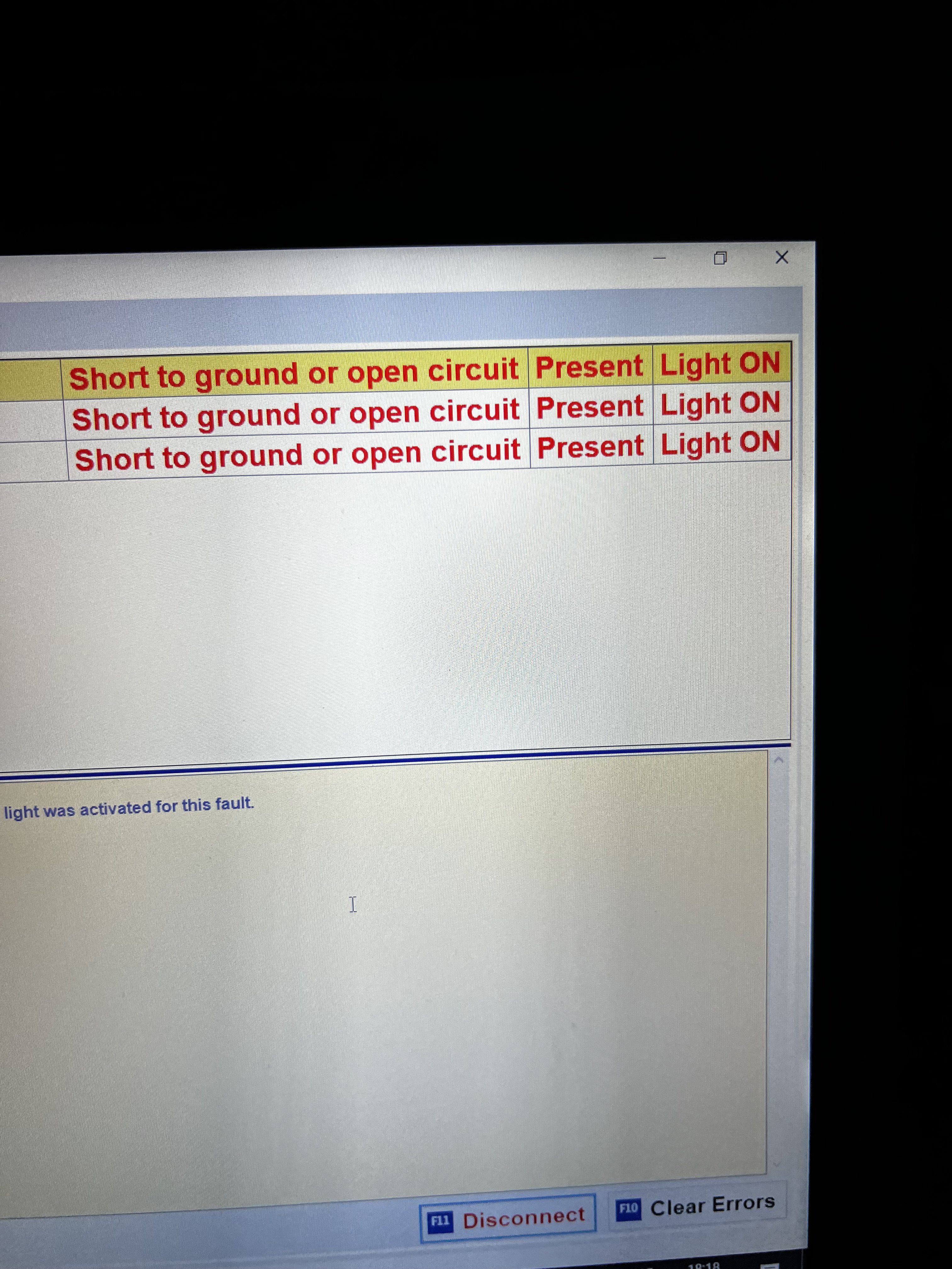

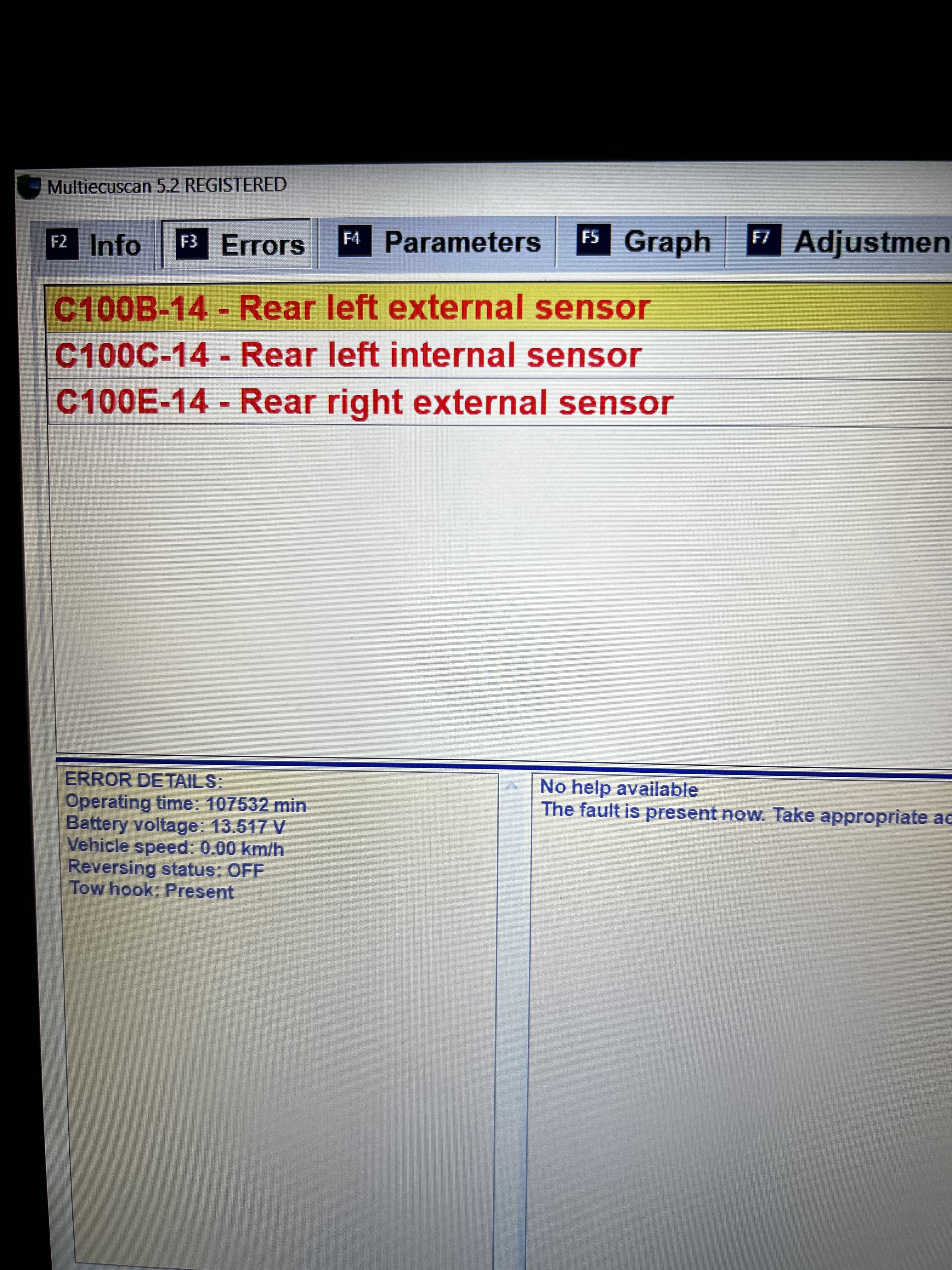

Hi, looking for some help. We have a yellow triangle alert coming up on the dash and a message regarding parking sensors. I have replaced all three sensors, replacement module in the back and still alarming. I have now purchased equipment to check and reset. Alarm resets but as soon as I put it in reverse I get all three sensor codes saying open or short circuited. Anyone got any ideas?

If you've replaced a module "in the back" you may need a proxi alignment.
Go into MES and the 'Body' ECU, and do a Proxi Alignment, if you haven't already.
Tried that and it said it wasn’t required. Will try again, just to confirm. Thanks
Yip, so over rode the proxy alignment and carried out anyway, Still same three error codes as soon as reverse is selected. Disconnnected rear loom, wee skoot of wd40, still same errors. Have just purchesed a 2nd module with the same year stamp as mine. Replacement I got was a 2015. Btw, thought reverse switch but lamp is ok and as far as I can see, only two pinned switch so guessing not that…thanks though👍
you have a short to ground, fortunately for you the problem appears to be between the module and the sensors. you've already replaced the sensors so presumably you know where to look to remove them from the back of the bumper, next you need to follow the wiring from the sensors back into the car where they enter the boot through a rubber grommet behind the bumper, then up to the module, usually in the left and side of the boot behind the back wheel on fiat's. but you've replaced that as well so you'll know where to find it.
We have all heard about the issues on hear with fiat 500 wiring between the car body and the boot lid, I suspect the same type of wiring would have been used for the parking sensors also. The insulation on the wiring breaks down causing short circuits (which is what your fault is saying is the problem) the wires can also short to the body of the car if the rubber grommet is damaged or missing. finally of the car is knocked or bumped the wiring can get pinched and short out, and so need replacing as well.
Basically you have exhausted swapping bits, you have a short circuit, you now need to follow the wires to find the short.
Some great info and ideas coming through, thanks…really appreciated. An additional module and loom coming. If still same then it’s a wire/wires within the boot I would imagine. Thanks again and will keep you posted👍
