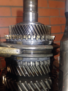

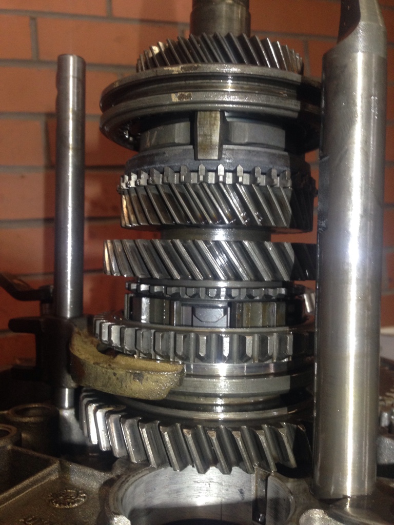

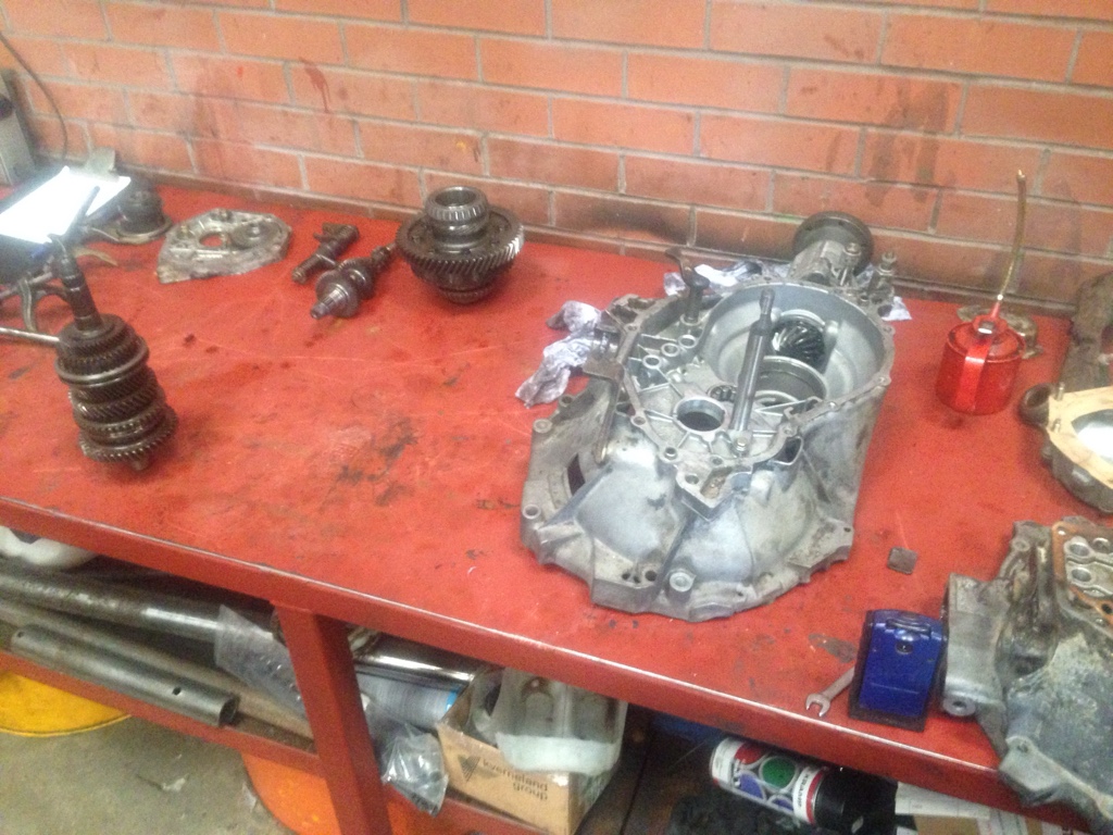

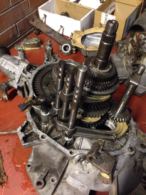

Thanks didn't see this till I got it apart [emoji23] ImageUploadedByFIAT Forum1466932415.762685.jpg
4th syncro has failed can we still get parts ? Or should I rob one from a second hand one off eBay ?
Syncro' rings are still available, if not cross match form CC g/box. I don' thing second hand ones are that easy to get. If on ebay £100+ for untested one.
