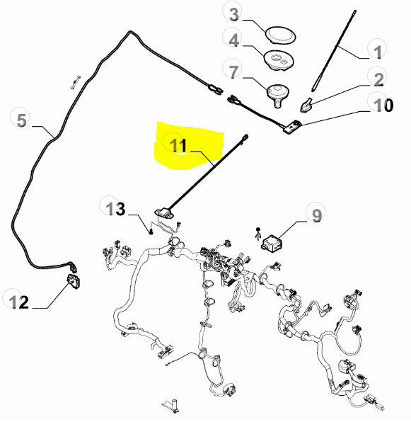

Does anyone know where this GPS module goes on a 2018 Ducato?
All the images for the wiring I can find on-line, show a short connections cable (11) with no extension, so it doesn't look like it goes behind the cab mirror or in the passenger door mirror - which kind of implies it's behind the dash (I'm looking to fit the module so I can't check on my van)
Any ideas or can someone check behind their radio please? :)
