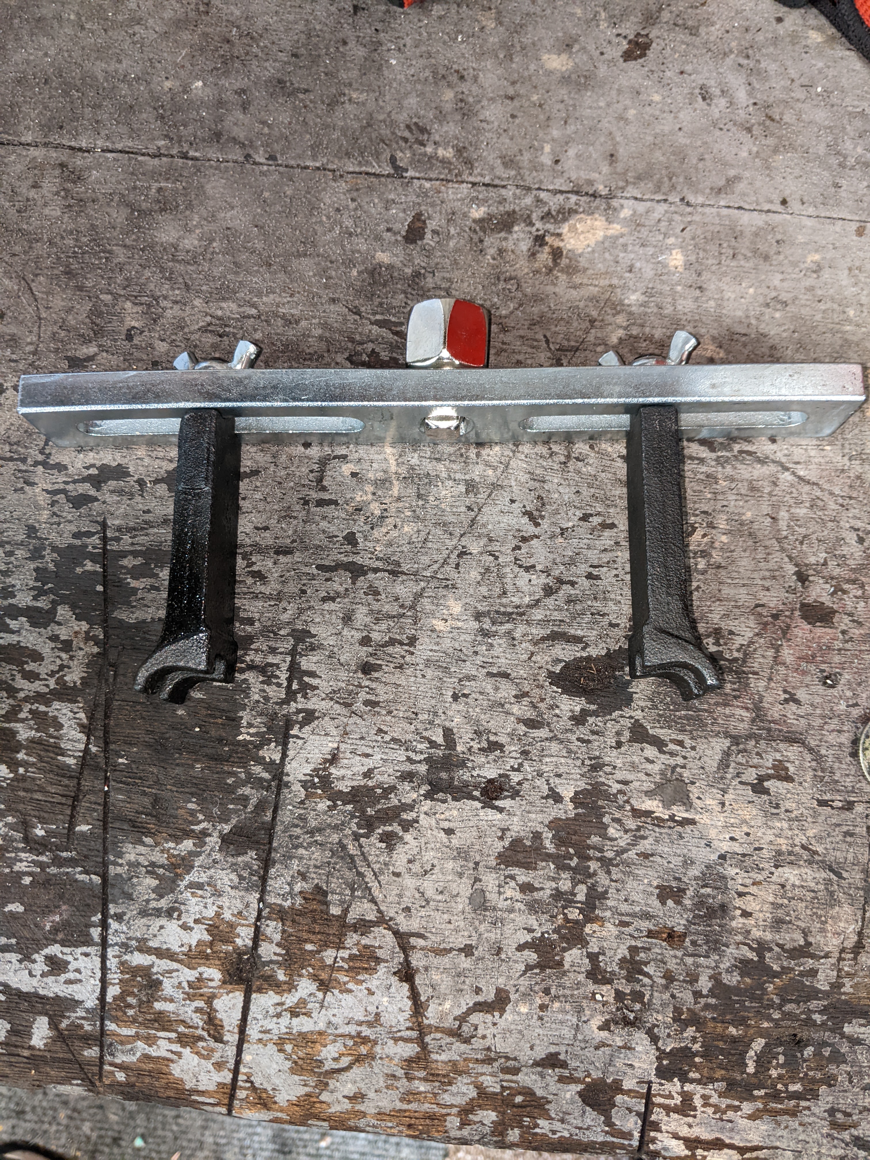

Hi so last week I decided to purchase the tool for removing the sender unit ring and it arrived today so why not get stuck into it , well it only took me 35 mins job start and complete so I am well happy with that was a simple enough job and since the fuel was well down at the quarter tank so there was no mess really just a test at the pumps now but am sure it's a success here is the tool I bought and the pipe removed , thanks again for your help , who would have thought just 4" makes a big difference ,,😂
