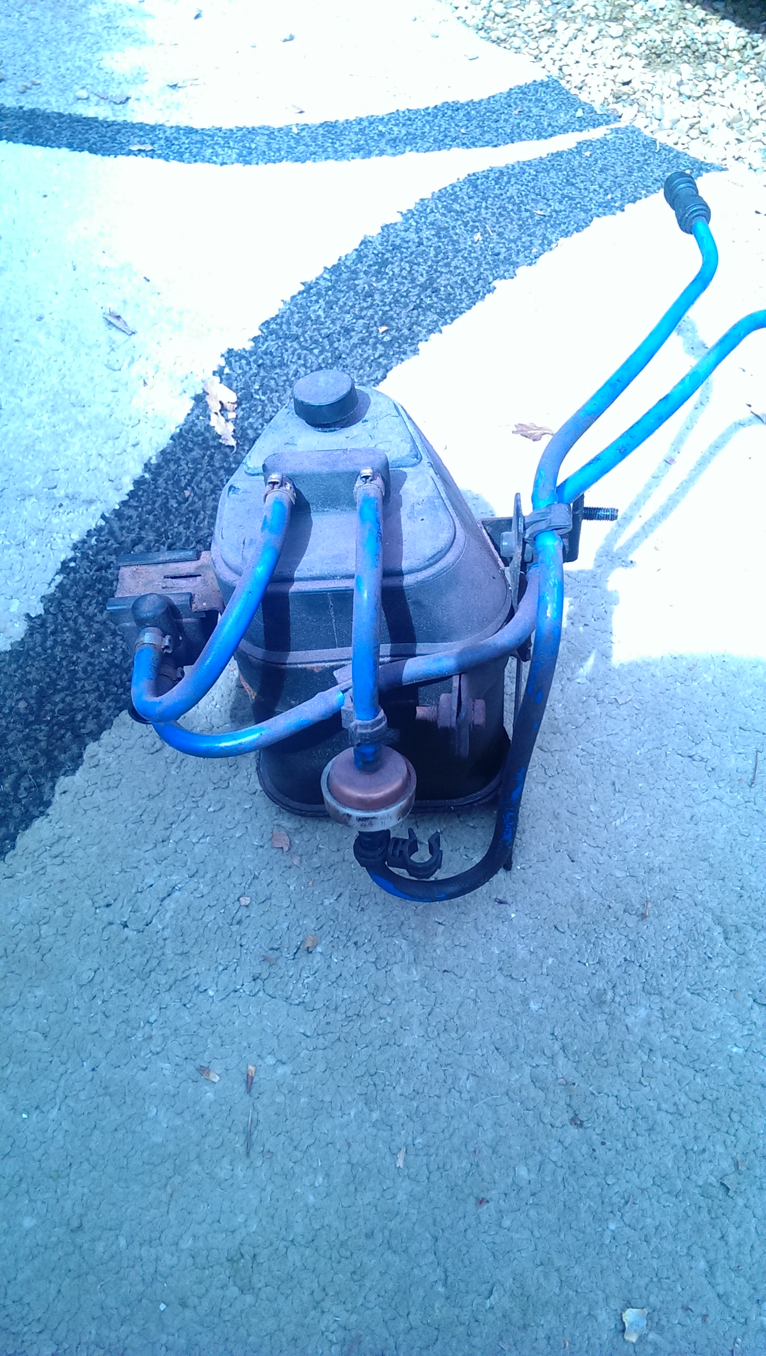

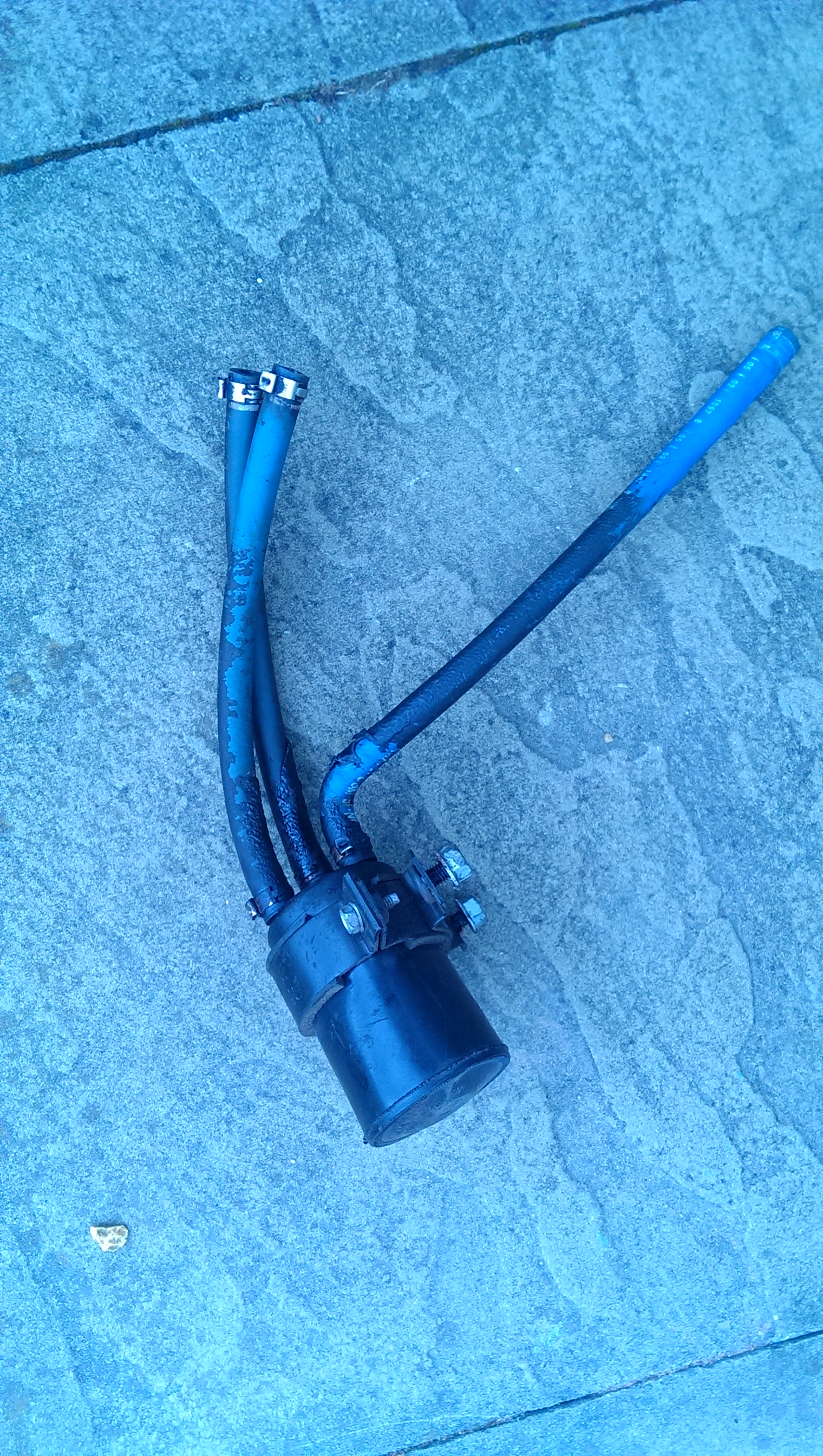

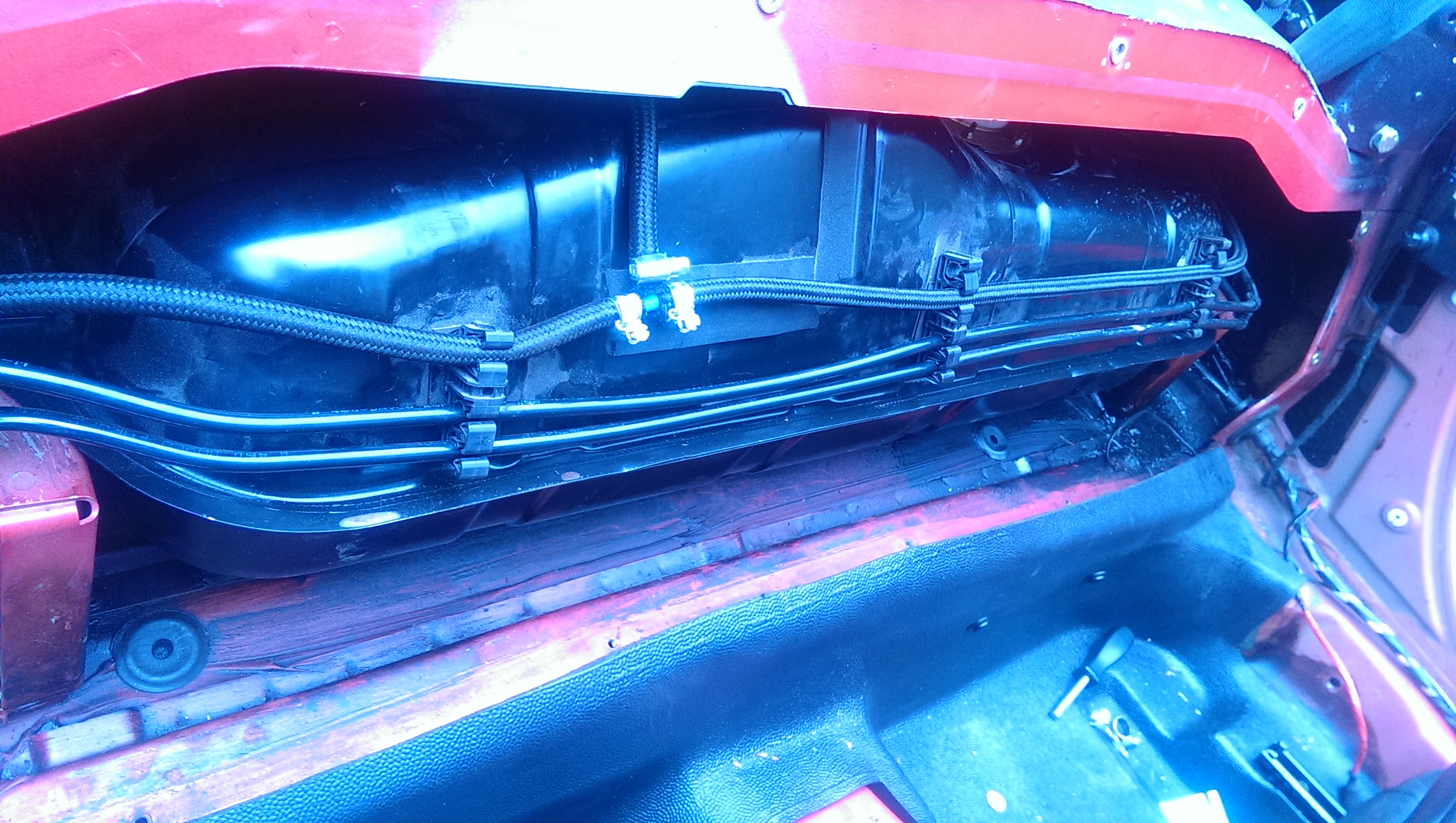

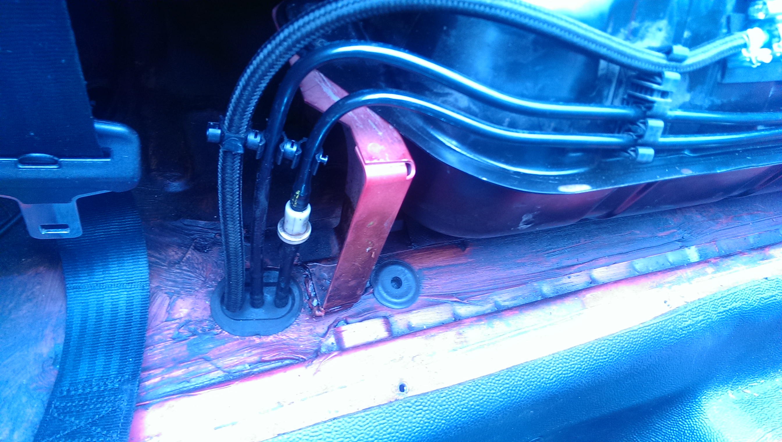

Hi, I announced some time ago that I had cured my fuel smell, last week it returned. I think because I had filled to the max with fuel. Had really bad smell both in the boot & the cabin, really strong.
So I decided to take the advice of the above post from Cribus and isolate the separator and the carbon filer. However once I started to remove the back panel, I decided to remove the the separator altogether, used fuel pipe and T piece to join the two valves on the tank, and exited the pipe through the same hole as the blue fuel pipe would have gone to the carbon filter.
Moving to the front of the car, I also removed the carbon filter. However I retained the solenoid, this has two pipes one from the canister(this I removed replacing it with the pipe that comes from the separator) the other pipe goes to the inlet manifold.
The blue plastic pipe that came of the separator and exited under the rear of the car, has a connector I removed this and fixed it to my new pipe from the vents, then connected this to the pipe that went to the front carbon filter (now connected to the Solenoid). Unsure if this connection is the right thing to do, but my thought is that any fumes will perhaps be redirected to the engine, rather than just exiting under the car.
All would seem to be working OK. Removing the carbon filter and separator I could see no evidence of leaks or splits in the pipe work. Just hope my efforts were worth the time.

Hi Dave, Yes that sounds like it makes sense. You got the segregator out which is more than I managed, I couldn't see what held it in place ?
My only thought is what if the solenoid isn't doing what it's supposed to do and manage the release of vapour into the intake ? That's what made me suspicious of the canister set-up and decide to just jettison that as well as the segregator.
Hopefully your arrangement will be the solution but if you still get the smell, maybe try running the vapour to the rear underside just to see if it helps ? Oh and I kept releasing the fuel cap now and then in the early days to make sure there was no pressure building up in the tank (there never was).

Hi Cribus,
That is an interesting point regarding checking for pressure in your tank. I did and still get a hissing sound as I undo my petrol tank, always assumed this was normal, as others have commented on this. So should we have no pressure in the tank?
I can quite easily disconnect the vent pipe, so that it just vents to the rear of the car. Undoing the pipe from the inlet chamber is also easy by replacing the pipe with a blanking plug. This I may do just to see if I still get pressure in the tank.
Regarding removal of the separator unit, it is held in place with two nuts that hold it in place. The location of the bolts is behind the black side trim panel that wraps around the hood compartment, undo those nuts and extract the unit from where the fuel tank is located
