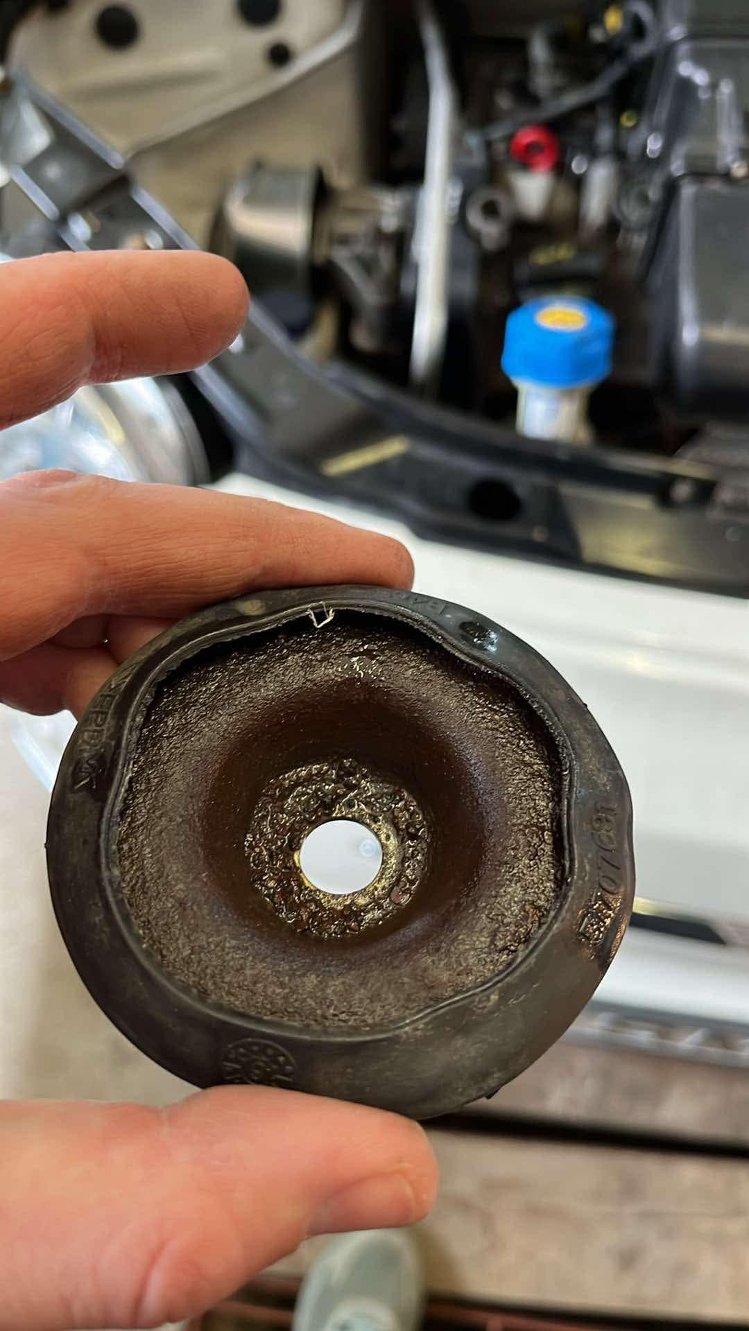

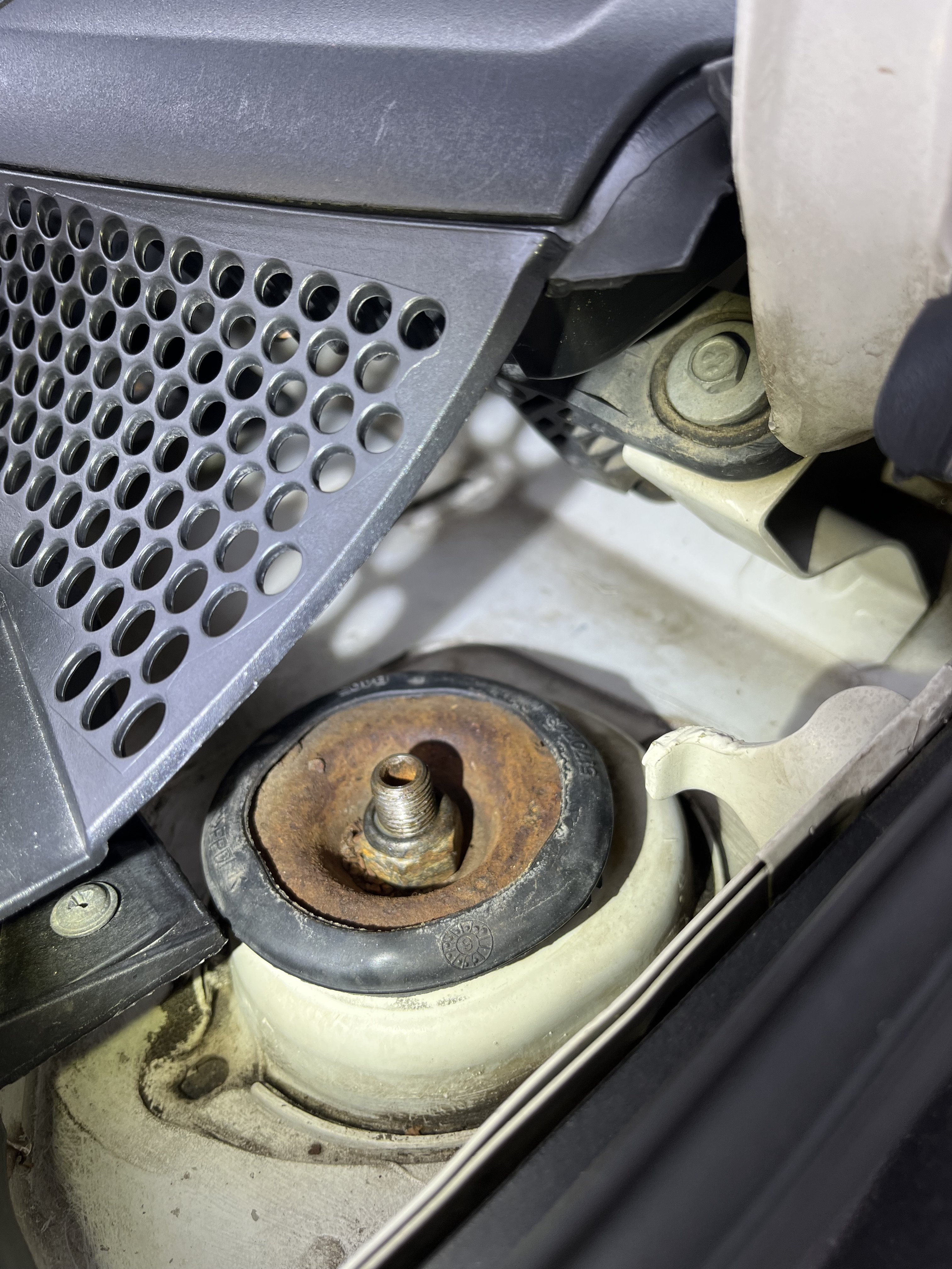

I thought I would replace the upper spring plate because it was very rusty. After simply replacing it, a strange rubbery, creaking noise started to occur when I go over speed bumps or very uneven roads.
After that, I replaced the shock absorbers and the strut mount/bearing for a week, but the noise didn't go away.
The steering gear and stabilizer bar bushings were also replaced a month ago. There’s no knocking sound, just this awful rubbery creaking noise. Could you help me figure out what it might be?

You did get the arrow pointing to the rear on the top rubber mount? And the metal tab facing outwards to the side of the car, compare your before and after pictures you'll see a gap at the front that's not there on the old pic?
Yes, in the first picture (for old rusty parts) the turret silencer is normally mounted upside down, so the arrow is pointing towards the front of the car.
After I replaced the parts, the arrow on the turret silencer points backwards and the mark on the metal spring plate points outwards as you wrote.
By the way KYB is the tower silencer/bearing and also the new shocks. And the top plate is factory new.
