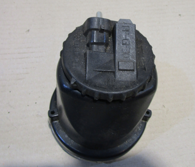

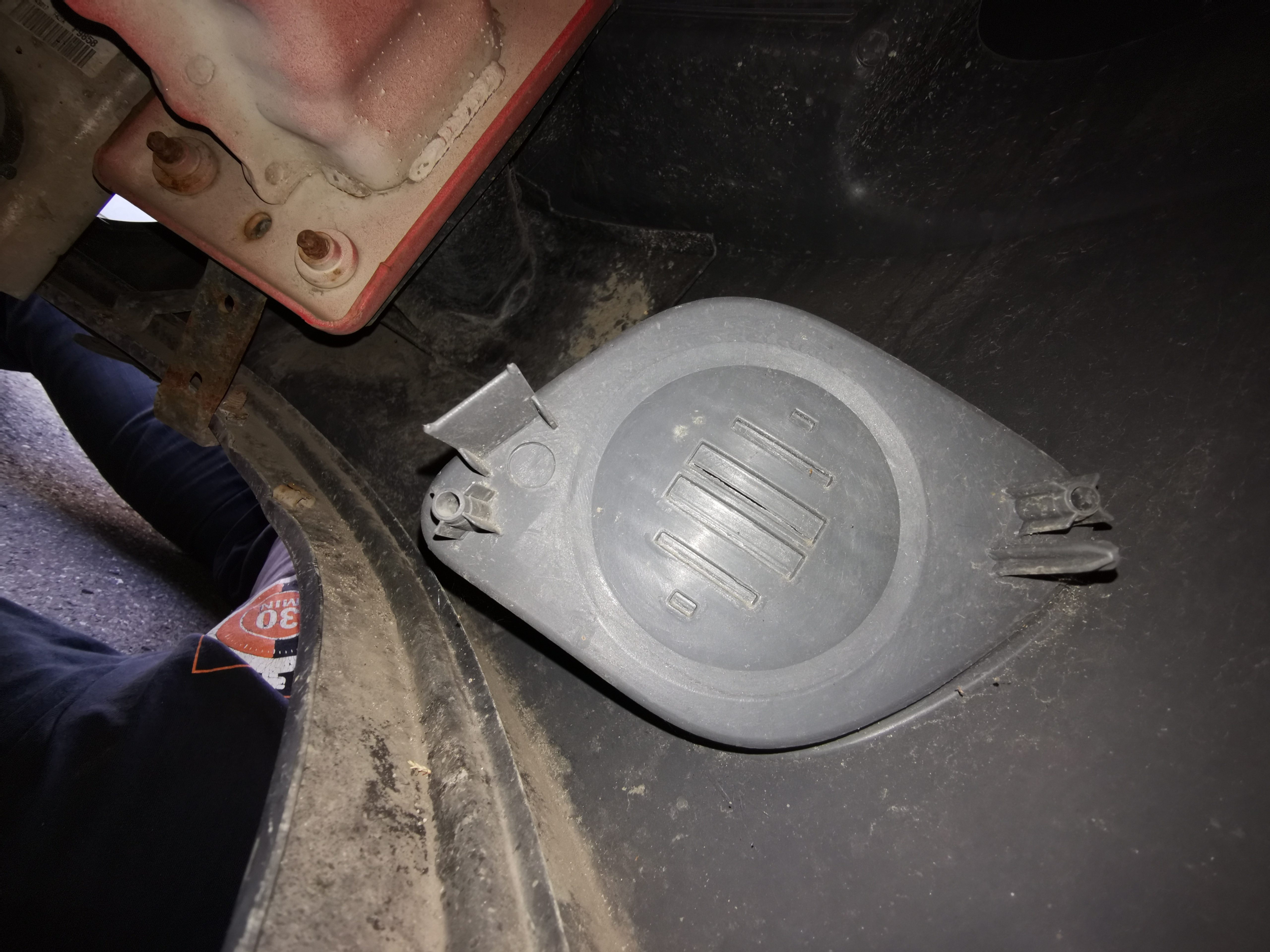

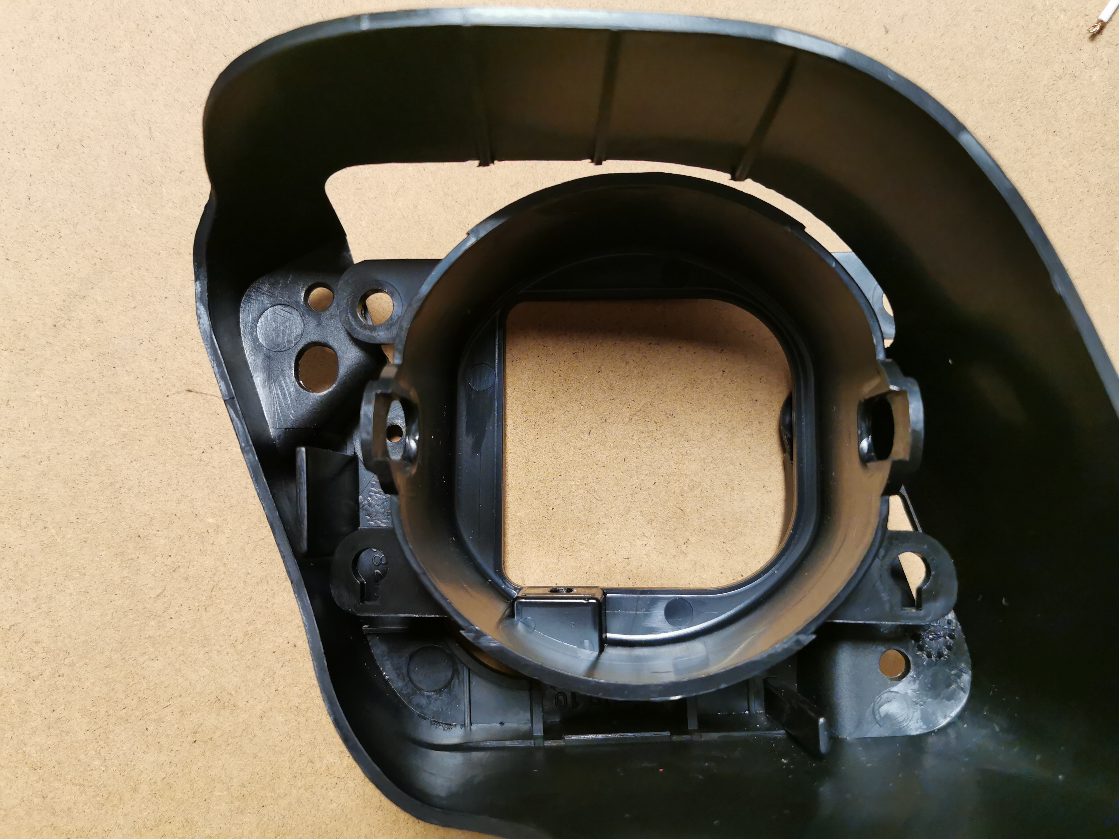

The question is the mounting. Originally there's no mount except two bushings (?) for screws on the diagonal of the emplacement on the standard bumper.
The mount for the original fog light fits perfectly, but fits the optional fog light. That's how it looks on the bumper.
It is quite hard to find a DRL that has the same housing as the fog light. I'm trying to do it since a year. I've seens sets dedicated to different models, but those for the x250 fit the x290 which has a completely different bumper + mounting. Laying is the mount for the x250, on top of that a part of a 'dedicated to x250' housing. I found out later it's for the x290.
That's how the original fog light looks like:
That's why Autotrail cut the whole and siliconed the DRL in place.
