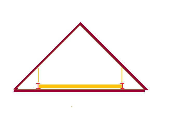

You will need support for the roof as well as the new floor.
How I've seen this done in a previous house was that steel joists were put in at front and back, about 5 foot in from the edge of the roof. These then carry the new floor and have supports up to the roof, which also form the support for the wall between the new room and loft void.
I incorrectly assumed terrace when you said victorian. A semi is easier, as the joists can be posted through two holes, made by removing a few tiles from the end of the roof (if it's hipped), or by removing a few bricks if it has a gable end wall.
See scribble piccy attached. Brown is existing wood, orange new wood and red steel joists.
Don't rely on me - I'm only going on what I've seen and an interest in all things building related.

I'm really grateful to you, thanks - what you have illustrated there makes perfect sense, rather than running huge great timbers across the whole span when they are only needed in the middle of the loft room.
I also think we could go ahead and complete the rooms below now, knowing the it would in theory be possible to install the steel at a later date by passing it through the roof after lifting some tiles and felt.

I've no idea on price. With this method you do lose a few inches of head height, as the new joists sit on top of the ceiling joists. Our current house has the floor joists between the old joists, which leaves just the thickness of the joists between the floors. It's a bugger to run pipes and cables through though, as there's more wood than space.
It might be cheaper to span timber across the whole width though - how it was done in the old days. If your roof pitch allows you to get the required height of joist onto the top of the wall without hitting the backs of the tiles.
I personally don't like the steel method, as it means that the entire room rests on four small points of the wall (and you lose height).
