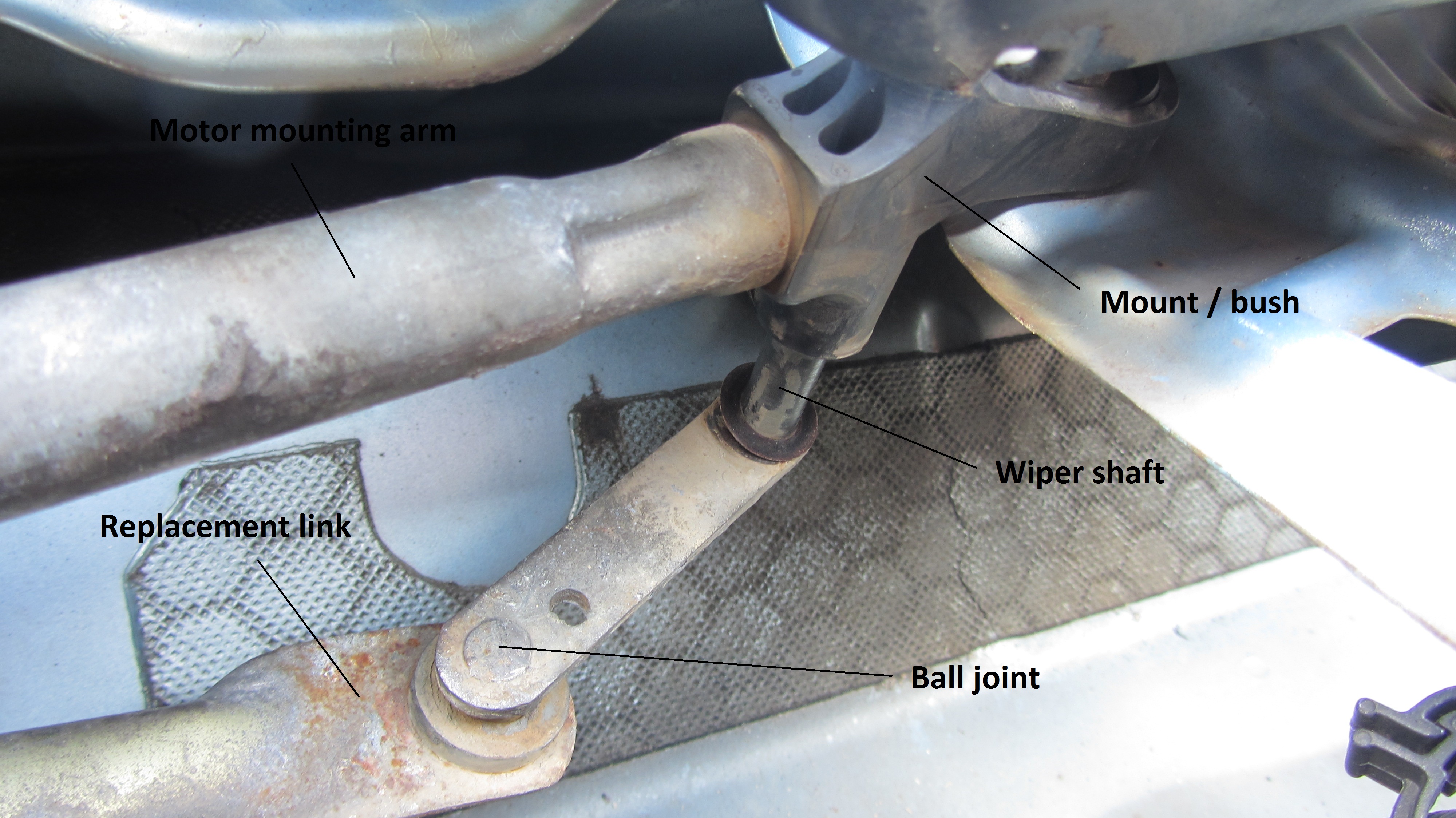

First, orientation:
The wiper mechanism is attached to the car through 2 plastic mounts. These serve 2 functions:
1. As a mount - you can see the fixed motor arm that goes from this plastic mount to the motor. There is another one on the other side.
2. As a bush for the wiper shaft. In this image, I have dropped the shaft for clarity.

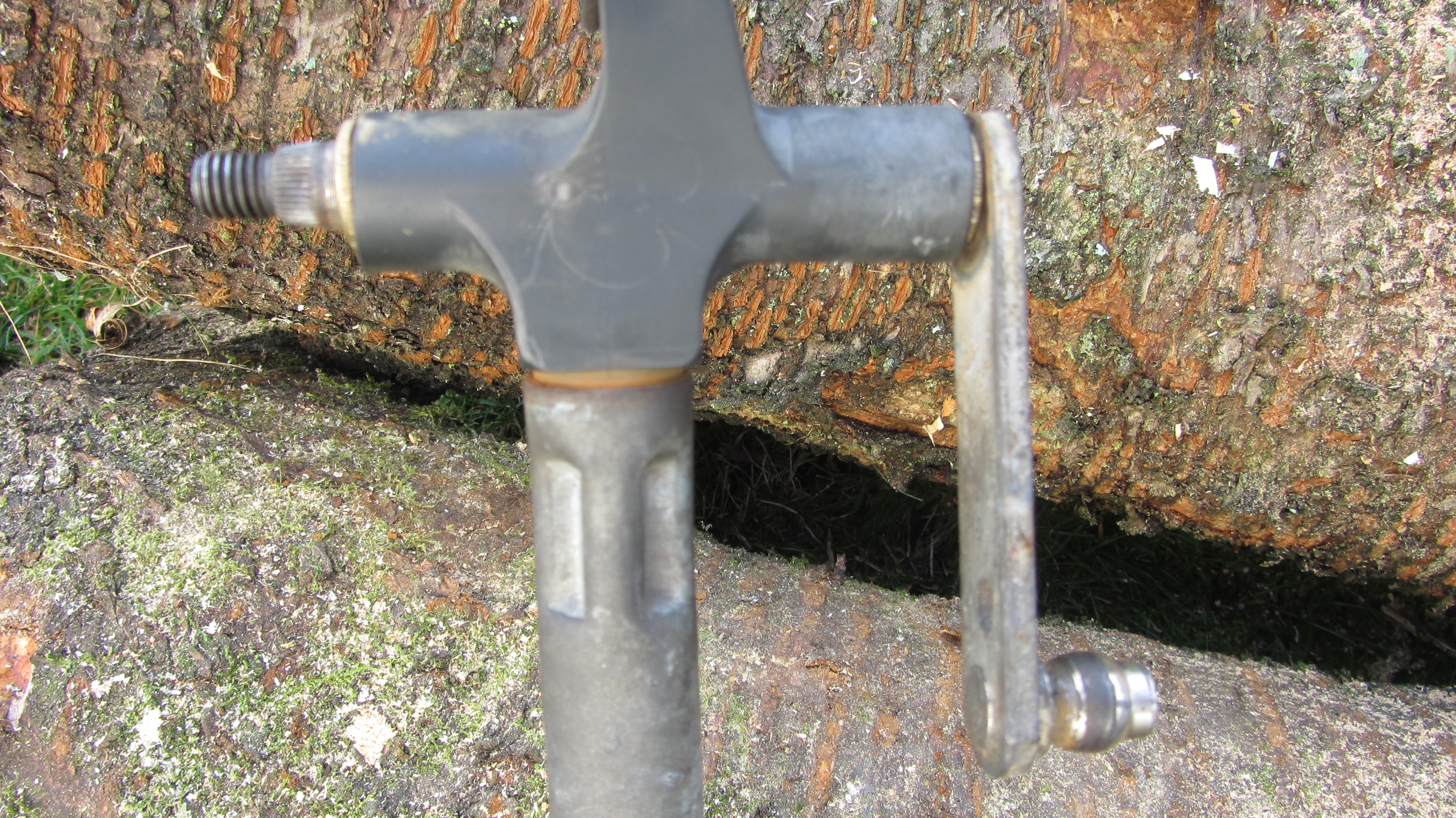

You can also see the infamous ball joint, which connects to the wiper shaft with a short link. I replaced these a while ago with replacement links from Wipex, which are at end of life now after a few years.
The wiper shaft rotates in the bush, classic rotary bearing. Unfortunately, the bush is made from Nylon (you can see the PA, for polyamide, stamp on the plastic moulding). This means it wears out.

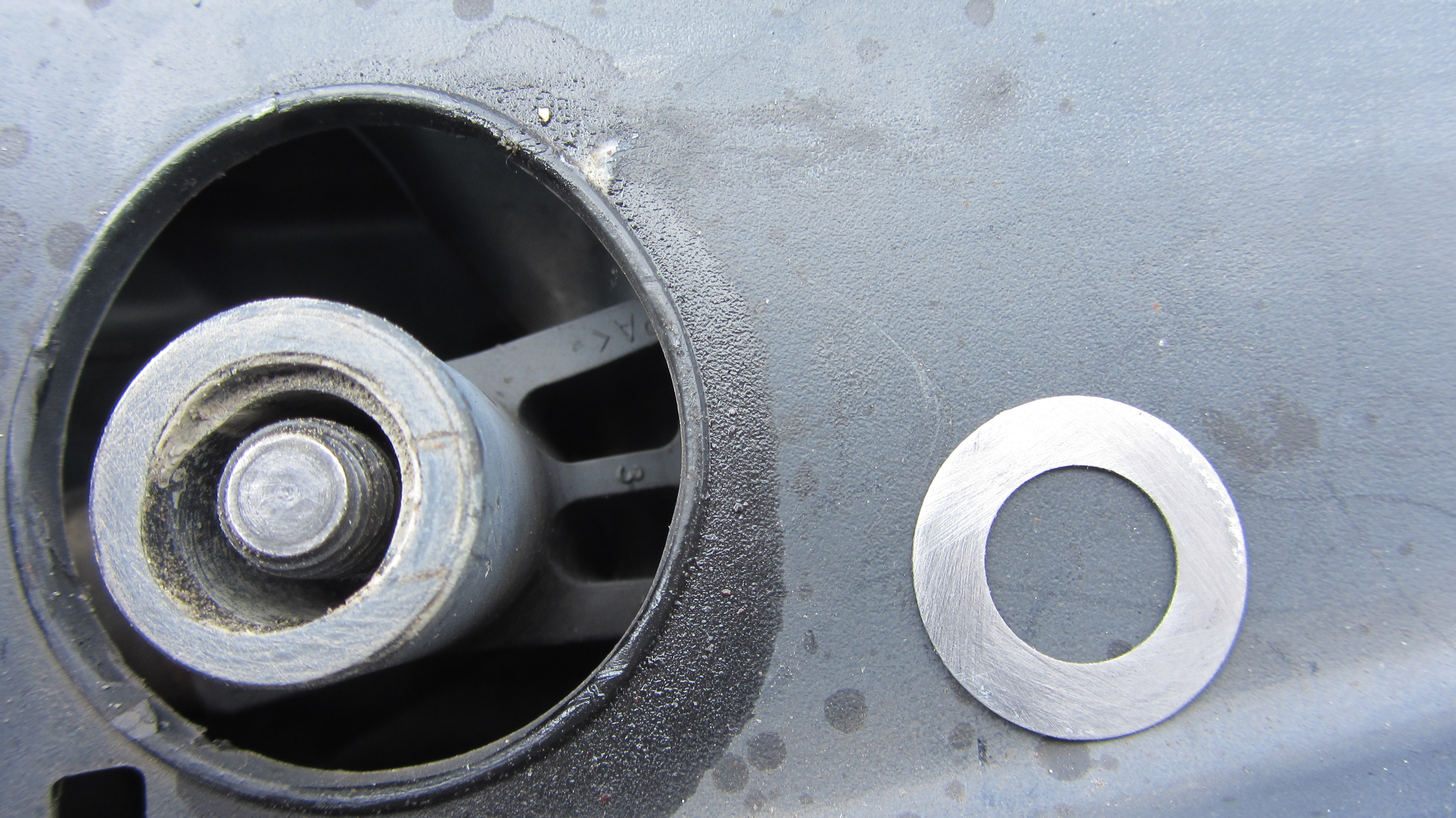

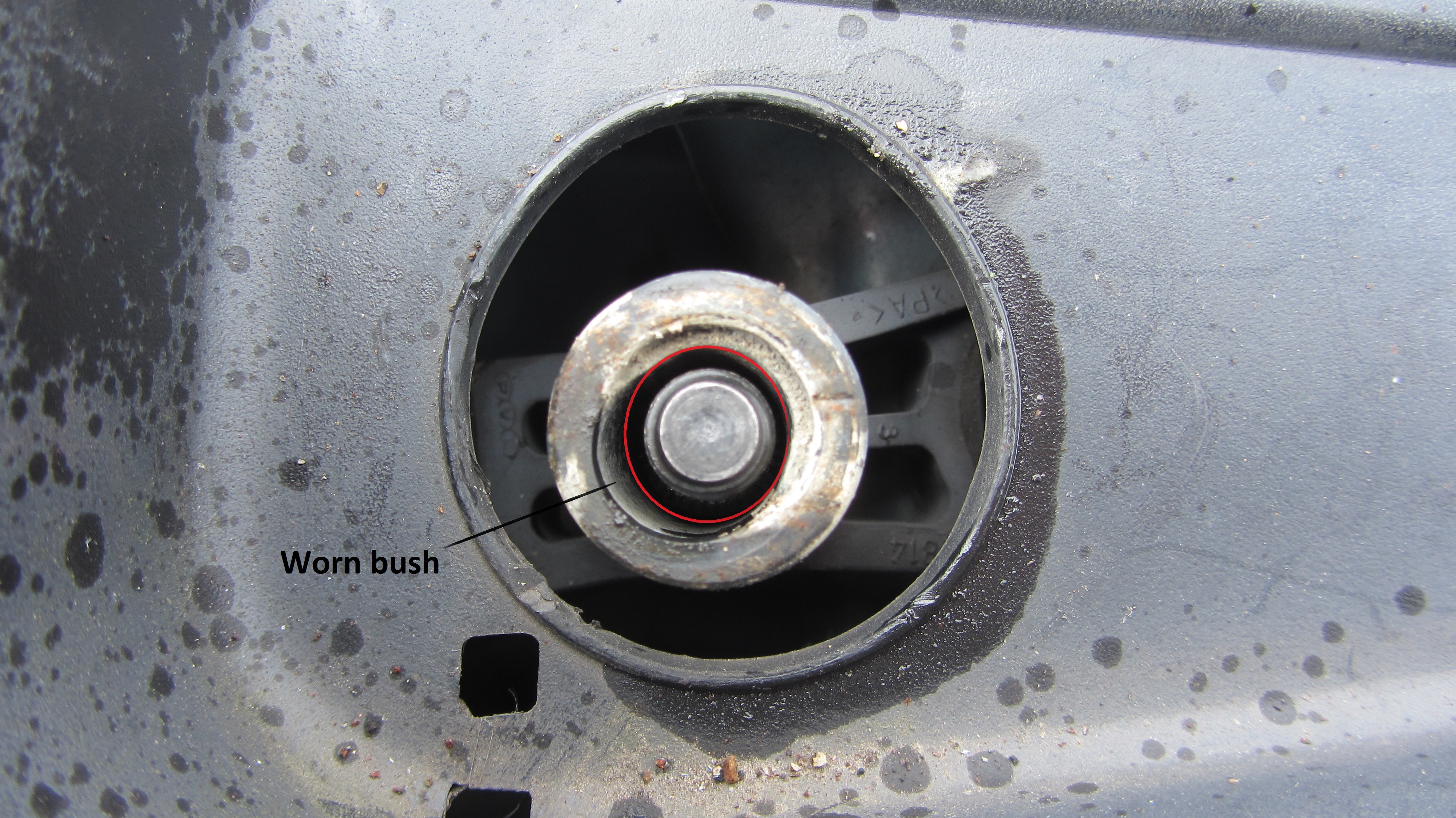

Once the wiper arm is off (13mm spanner and a bit of pulling), you will see this:
This shows that the shaft is moving in the bush. There should be no lateral motion.
The shaft is retained in the bush with a starlock washer, which sits on top of a plain washer, which sits on top of the face of the bush. The shaft has an OD of 10mm, the plain washer has a matching ID of (approx.) 10mm.
The starlock washer can be carefully pried off with a flat screwdriver, and the plain washer can be recovered.
You'll then see wear like this in the bush:
What should be a circular bush has worn into an elongated oval. This allows the wiper shaft to wander, and the position of the wiper arm to vary as a result.

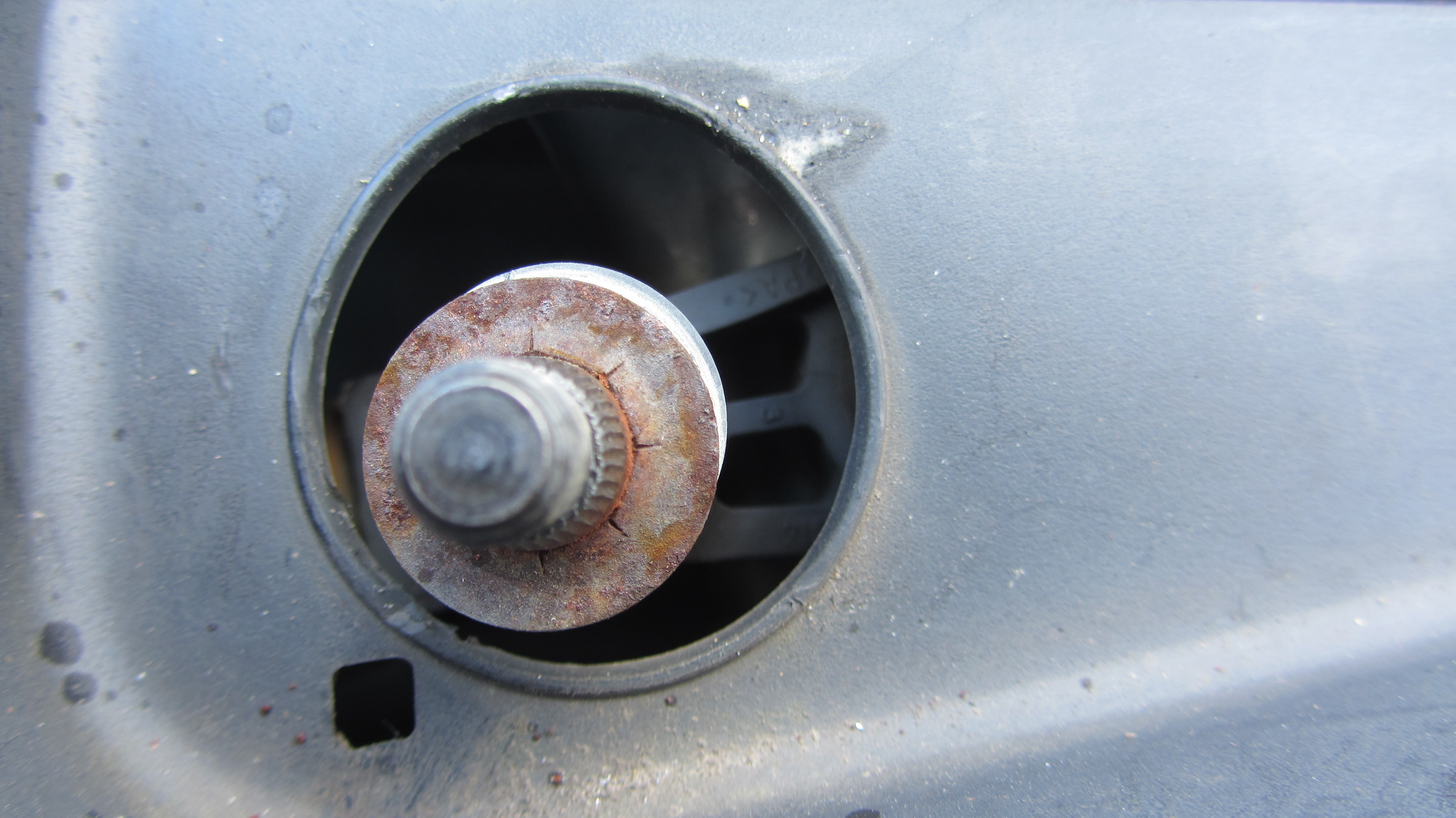

The solution is to return the top of the bush to the marked circular shape. I cleaned the plain washer (18mm OD, 10mm ID) and the top of the bush with 180 grit sandpaper, see below.
I then used 2 part epoxy glue (generic, although next time I might go for Q Bond, which looks very strong in the demos I've seen) to glue the plain washer to the bush. It's easy to get this right - the washer outer diameter matches the bush so you can get it nicely centralised.
Refit the starlock. You can replace with a 10mm starlock if preferred, mine was OK to reuse. Reconnect the wiper arm. Test.
Mine seems to be fixed now, no more striking the scuttle.
