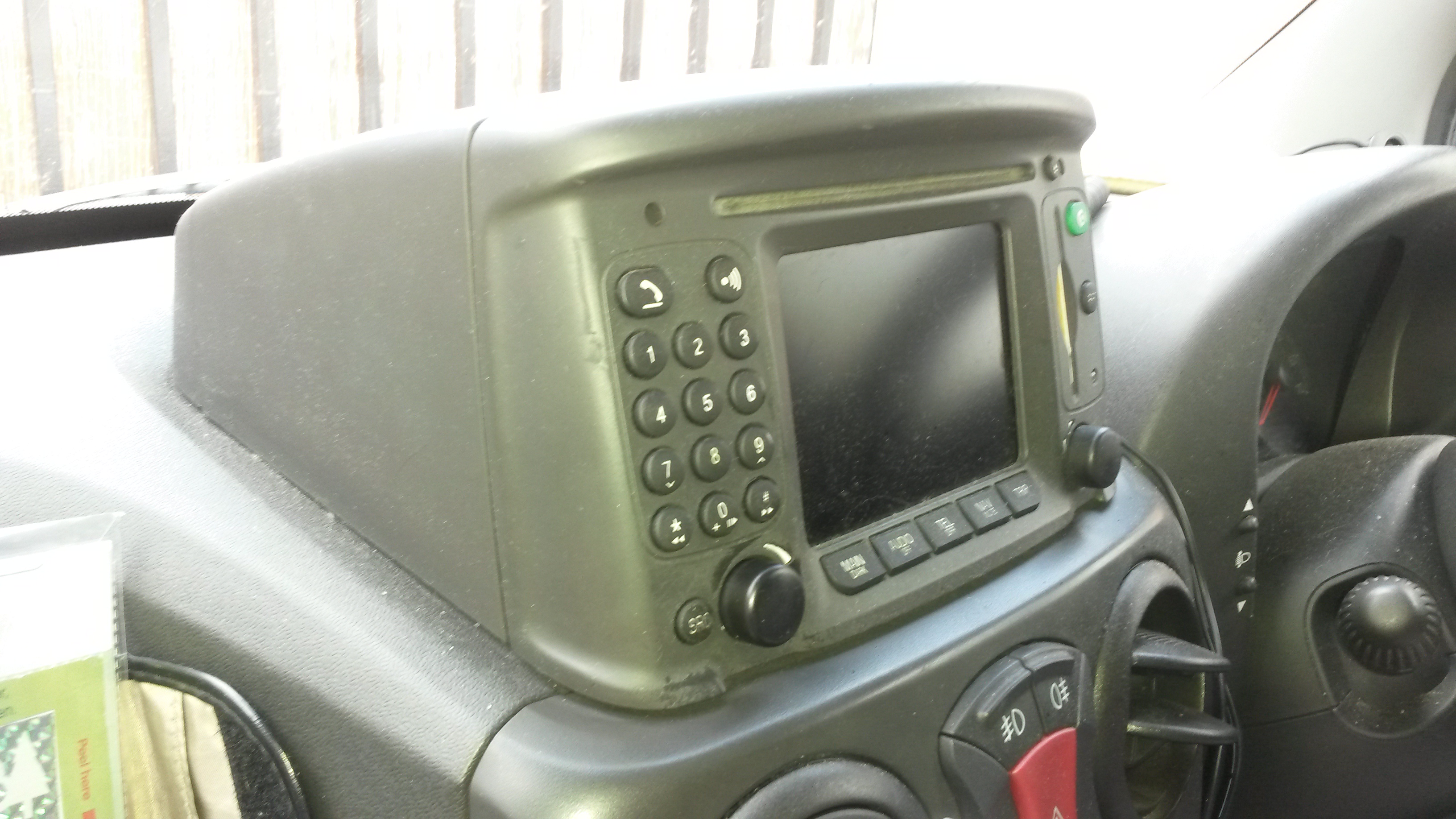

Hello there,
I am about to fit a new stereo to my 06 Doblo.
I understand that the ISO connectors should fit, and that I need a DIN/ISO antennae adaptor, but as I am replacing the CD/Sat Nav/Phone card unit, I wondered if there was anything else I needed to worry about?
There are a lot of non-ISO wires and connections at the back.
I have purchased a 'salvaged' single Pod/binnacle from E Bay.
Thanks, Oz.
