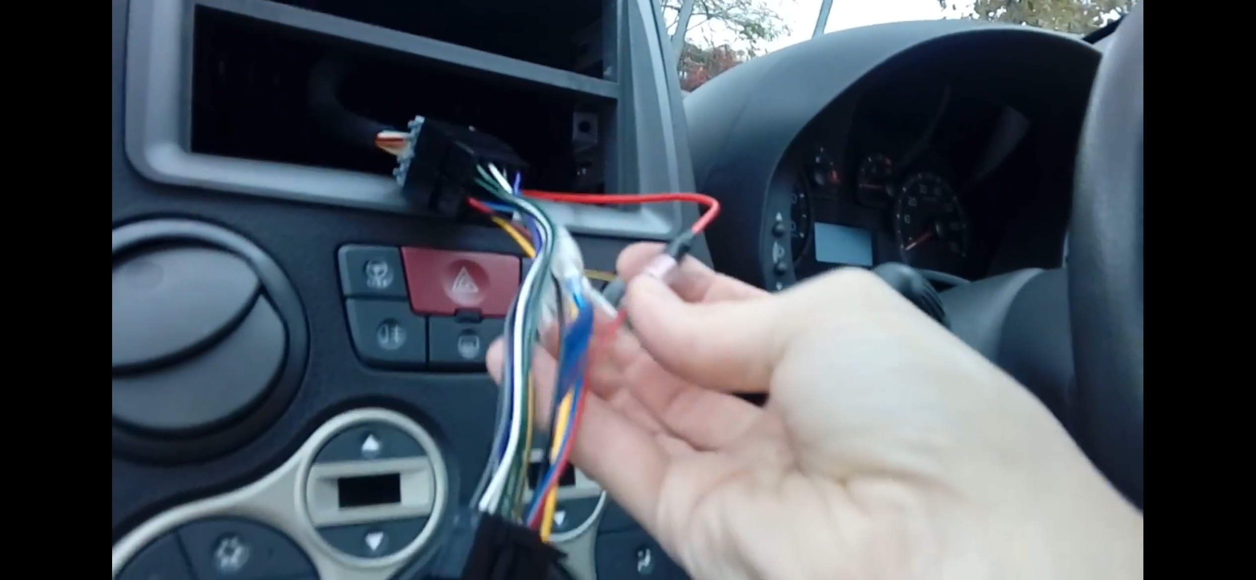

Quick question: is it okay to add two things to the ignition? Like if I wanted to do stereo and dash cam?
As long as the total current is less than the circuit was designed for,
Radio is only a sense wire so negligible
If you keep to original fuse value in place as in the video it will never cause any damage
Dashcam you will have to look at it's maximum current draw, most will be quite small and okay, there might be some at 2A or more, my door bell camera for example is 2A while charging, still doable but I would have to be more careful which circuit got piggy backed

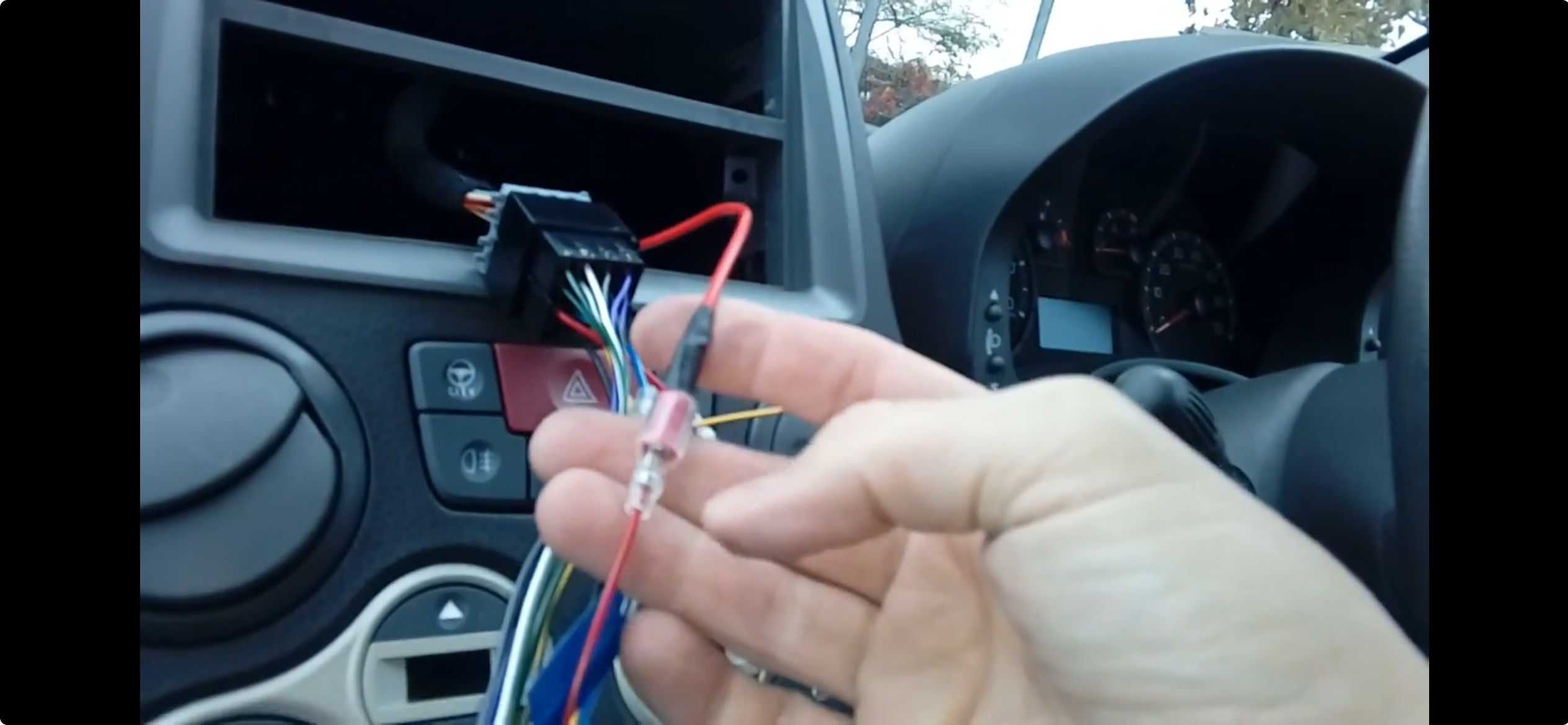

Is it possible to just route the fuse split power cord into the main connector for the new stereo?
Like I’m seeing this guy do it on Yourube and he doesn’t have the special harness linked above

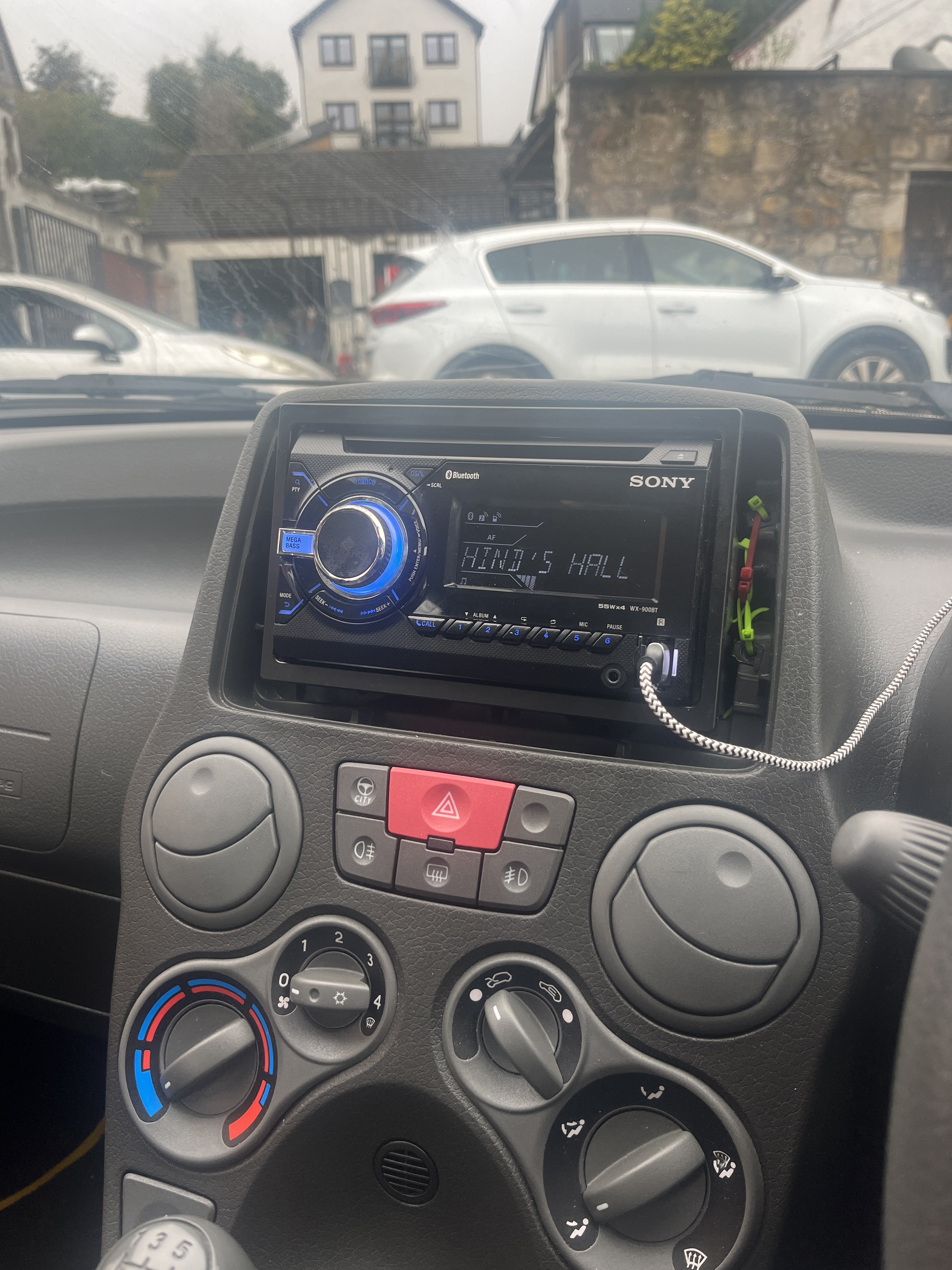

Also, I don’t have a facia yet, but is there a way I could secure the new stereo (even if with zip ties or screwing into plastic inside the dash)?
Most radios have an auto power off feature. If you do forget they shut off with a time delay after ignition off. I set mine to zero seconds. Some have a set time with the ignition off. When you forget the radio is on, it will switch itself off after a time delay.
OEM radio detects the ignition off by canbus, and just works
Third party radios as in this thread have no canbus
No canbus, no ignition on or off detection, no automatically switching off.
If you want the radio to automatically switch on and off a method of detecting the ignition switch has to be added

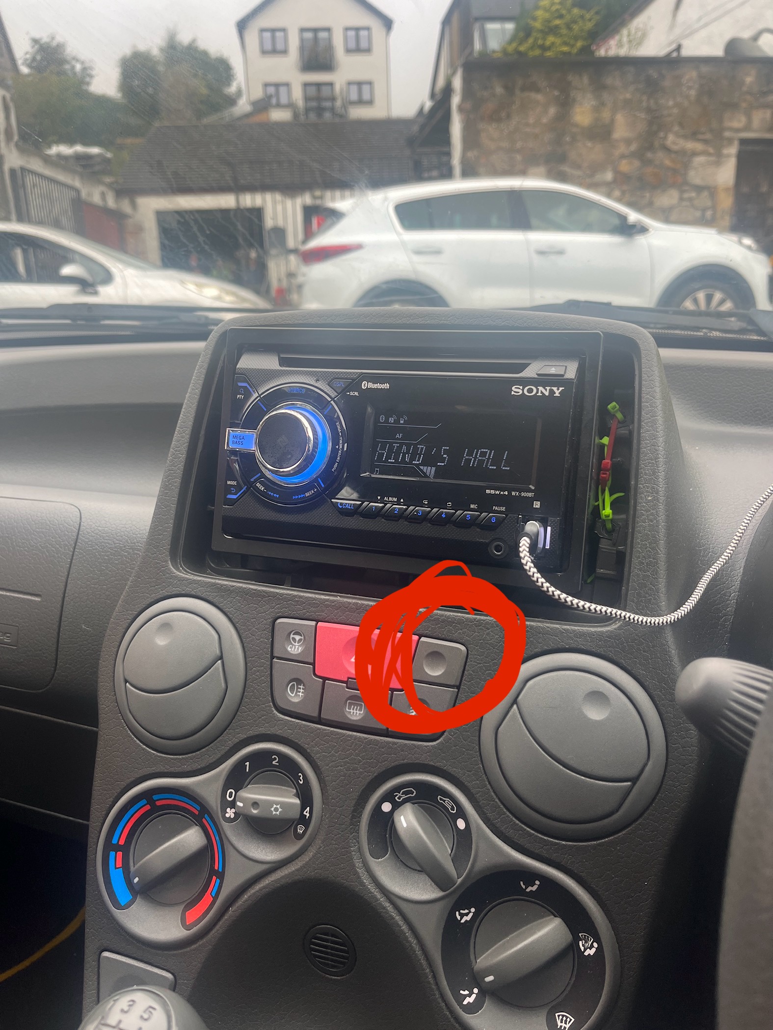

I was also wondering if it would be possible to put an actual button behind the dumby button on the console panel.
Has anyone done that?
I did a ‘momentary’ switch on for some air horns I put on my panda, everyone used to look around for the unseen truck, but that wasn’t using the actual blank other than a place to hold in the screw in switch
