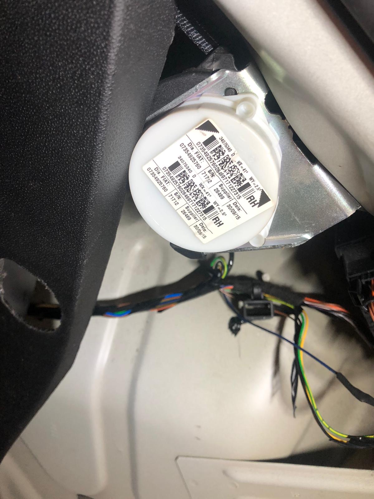

New to the forum, but have several Fiat 500s new and old. The older one has had a visit from rats over Christmas and they chewed through the loom and rear seatbelts. Loom has been repaired, but my question is do all 500 seatbelts fit the different models so long as the year is correct as I cannot find replacements anywhere.

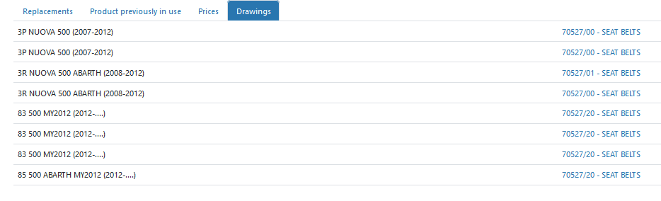

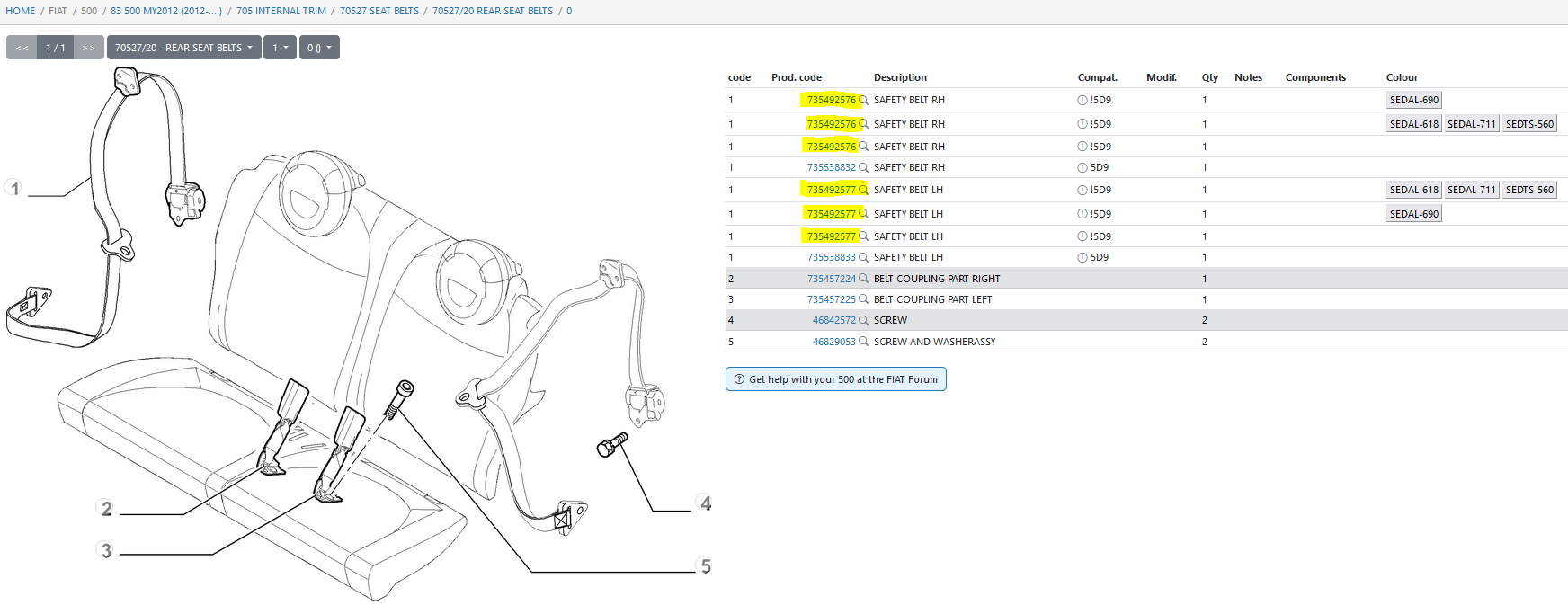

From what I can see in ePER (link on the bottom of the forum banner, search window top left of the screen), there are 2 different rear seat belts per side available. The 'odd' one is for the Gucci edition (option number 5D9, !5D9 means not for Gucci). The remaining ones listed (highlighted) have the same part numbers as yours (on the attached photos):
This comes from the MY2012 FIAT 500.
Searching with the part number is seems the same seatbelts were installed since 2007:
I'd however wait for a confirmation from a 500 owner, or someone who knows better this model.
