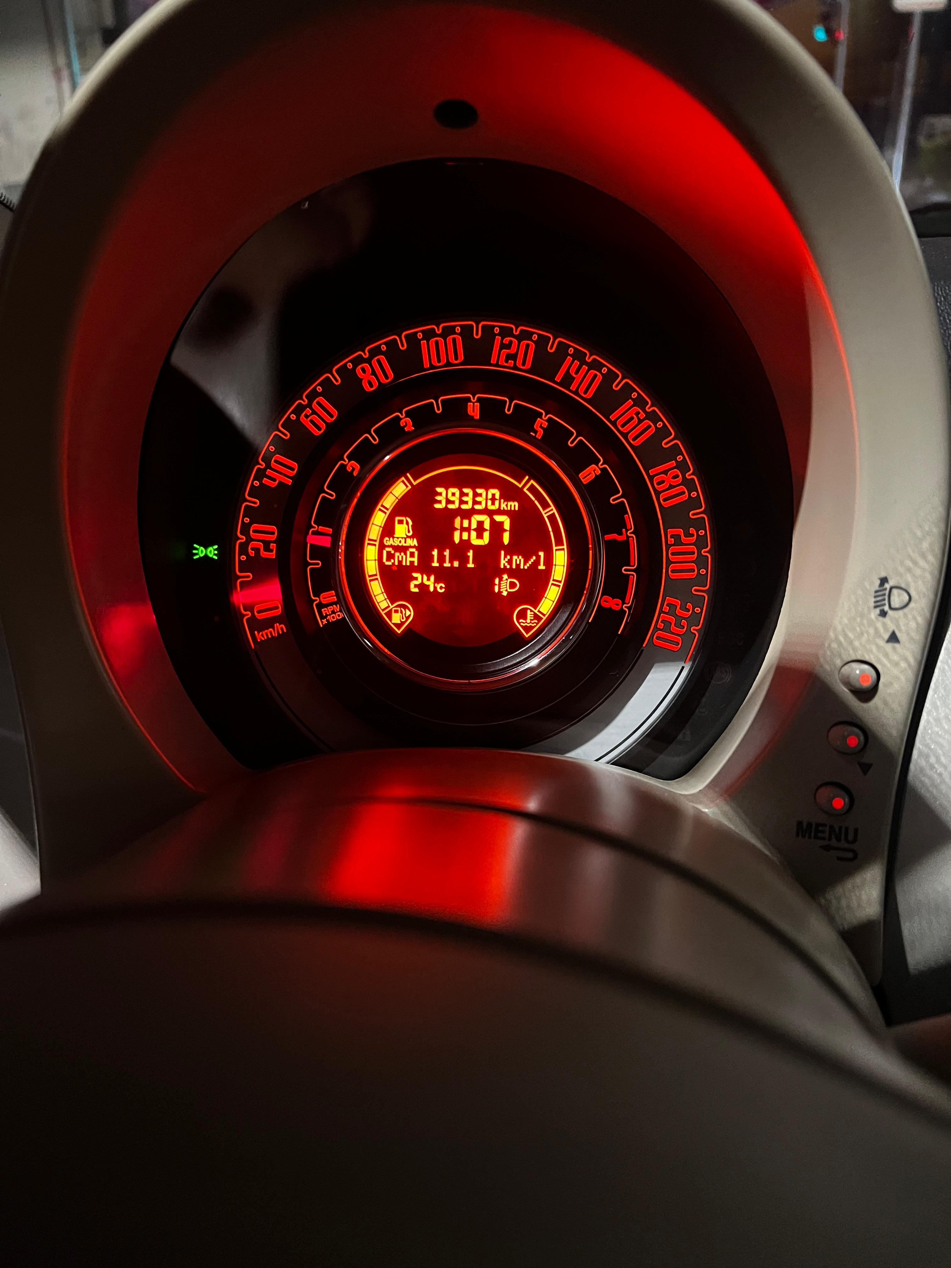

Previous OEM Cluster that was installed in the CAR

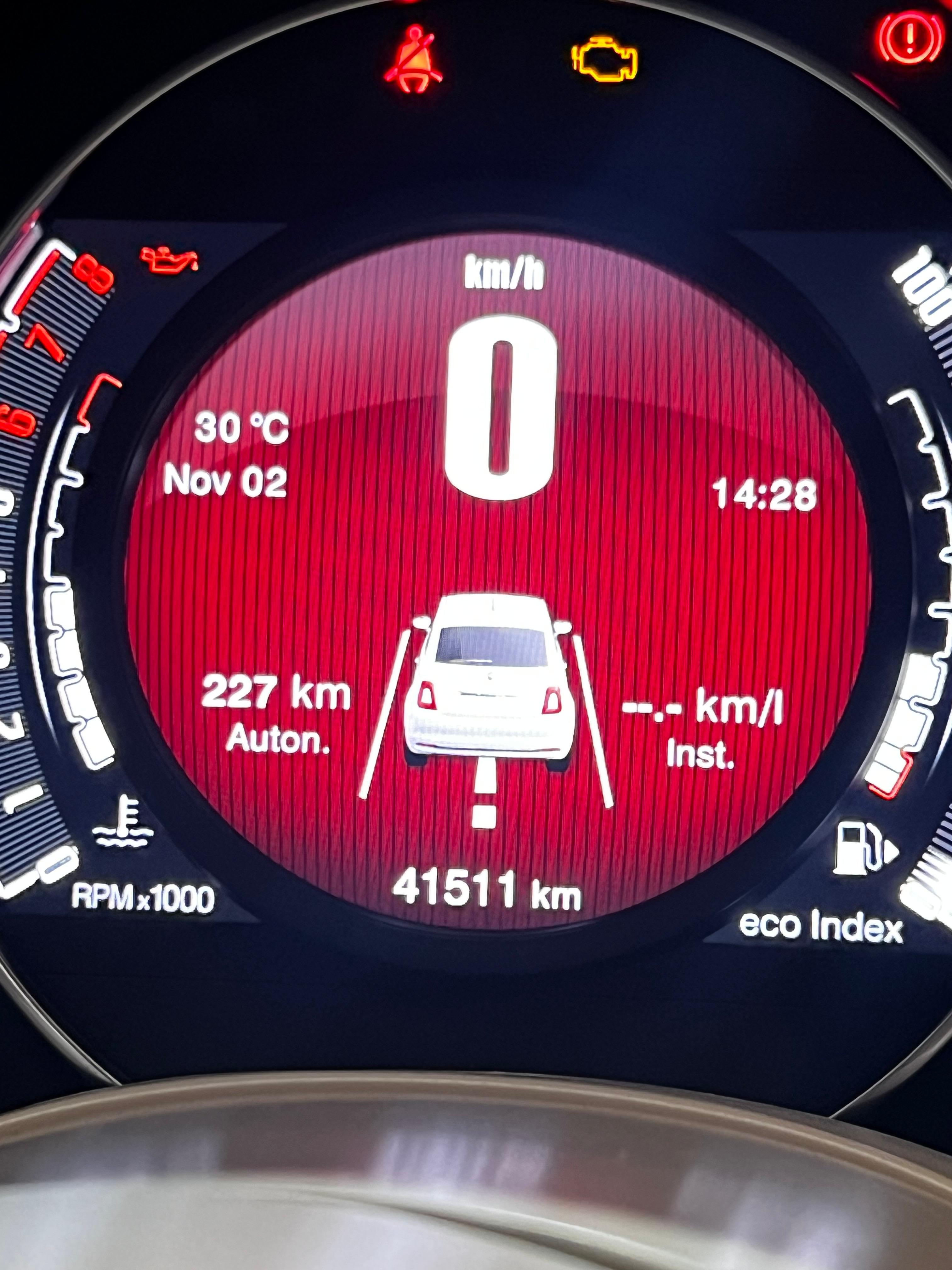

A) Picture of my current setup, TFT Cluster

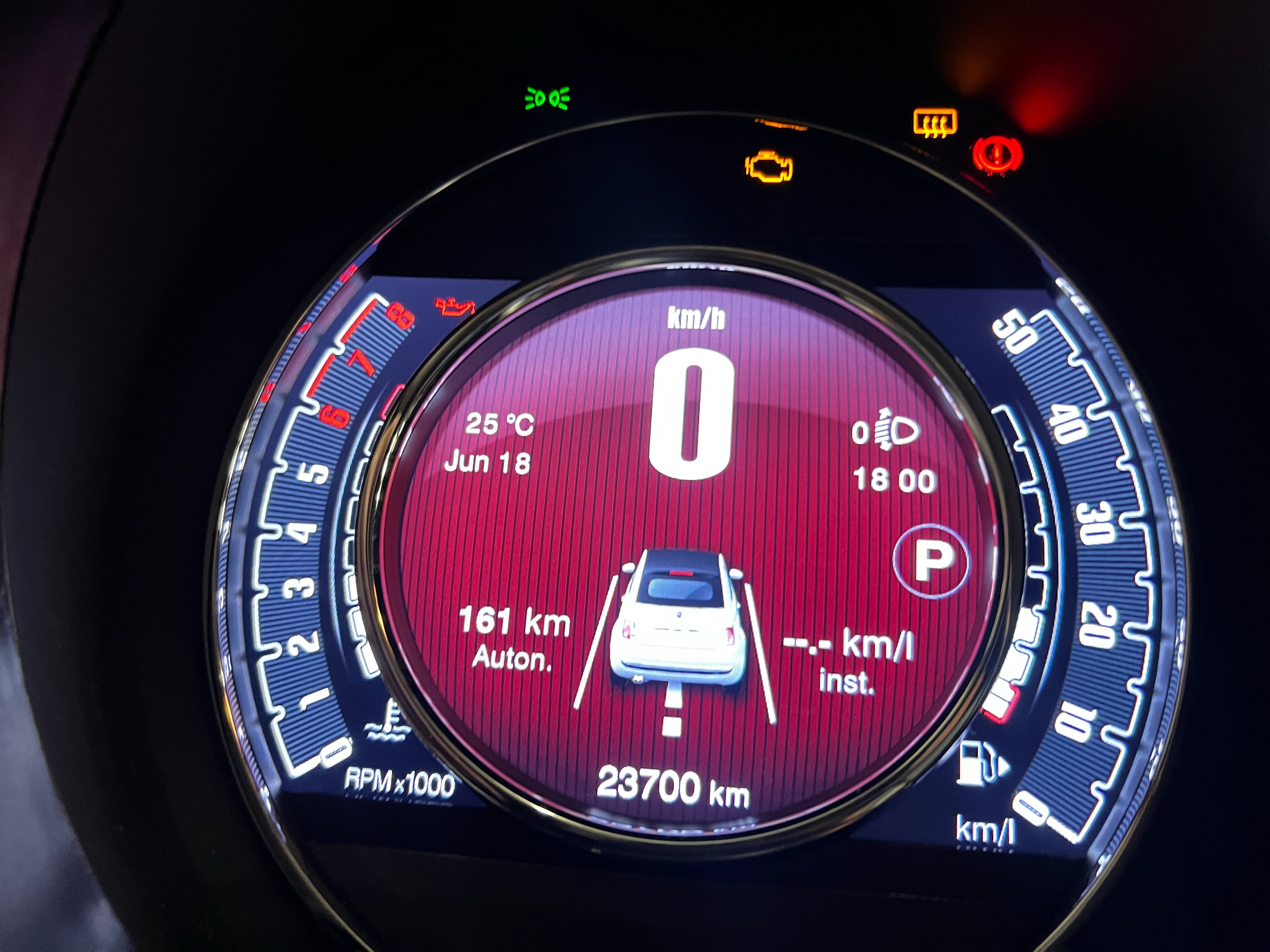

B) Picture of Another Europe Display with the headlight leveling enabled and TPMS ( Random Internet Images)

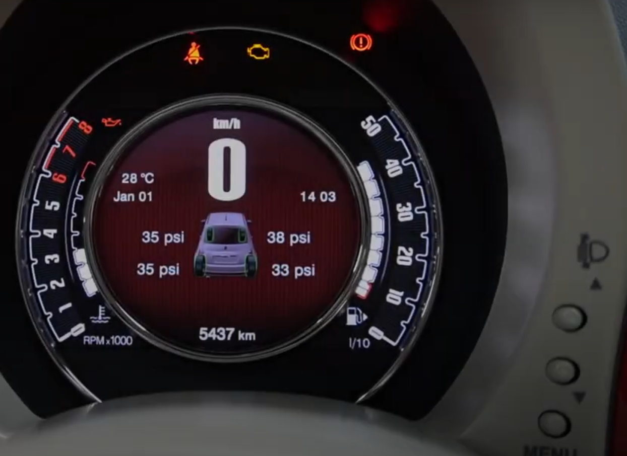

C) Picture from the Cabrio
