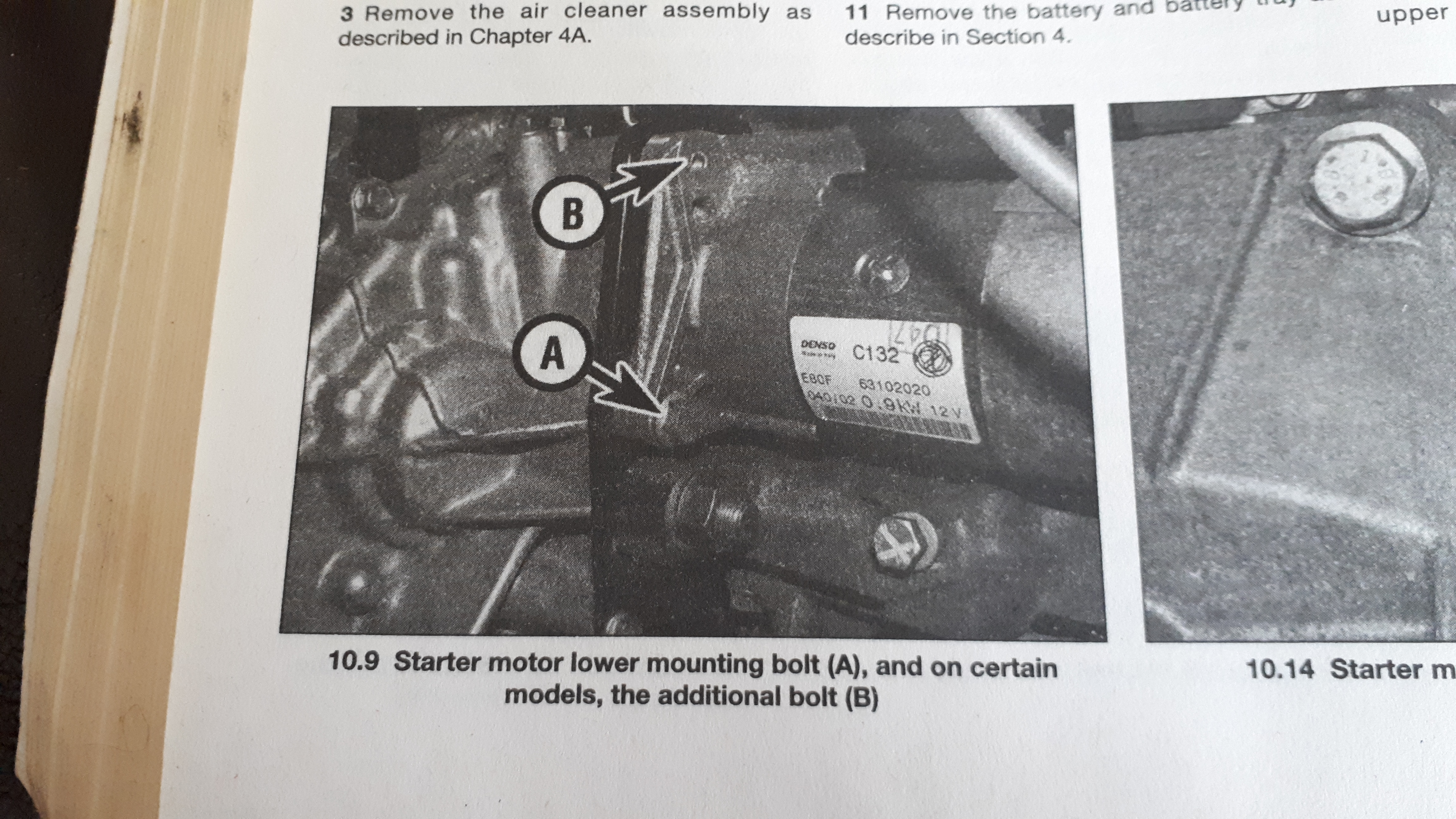

Cant try the bump start as I live on a very busy road. It was a nightmare pushing the car into the driveway. I had a go at attempting to remove the starter... I got to the bottom 13mm bolt which you can see and get too from under the car HOWEVER, there is still 1 13mm bolt on the opposite side and I cant even see or feel the bolt! What makes it worse is, I tried removing the inlet manifold to get access to the starter motor from the top but ones you try and wedge the inlet manifold away from the engine, it gets stuck against the cars shell. There is no way to get the intake manifold out without moving the engine forward. Any ideas on how I am meant to get to that 13 mm bolt on the starter??
This may help
I took the bell housing down when I replaced the input shaft in the gearbox. There is a bolt on the driver side of the upper part of bell housing that holds onto the starter motor. There are 2 bolts, may be 1 bolt, on the other side just above the oil sump.
Hope it helps.

In your second picture, the bolt(s) labeled A and B.. I have taken bolt A off and there is no bolt B but a hole. However, on the opposite side of bolt A is another bolt which is what I am trying to get too however I cant seem to figure out how in the world I can get to it.
Thanks.
It's a fairly easy job if you have a set of ramps. Two bolts at the bottom from under the car and a third at the top of the bell housing. You could check the wiring to the motor before you remove it.
I removed mine as the starter was sticking when cold and sounded like a screeching fan belt.
I only see 1 bolt from under the car which I removed and a 2nd bolt holding the wires in place. There is another bolt on the opposite side of the starter which I cant get too.

There is no way to access the second bolt from removing the battery tray. The starter motor has 2 bolts.. 1 bolt I can access from underneath the car and the second bolt is opposite the one I can access however because it is behind the engine I cannot see the bolt.
https://www.startermotor-alternator...ages/fiat-500-1.2-1.4-07-starter-motor-s2402-[3]-11668-p.jpg
Here is the picture of the starter I have. I can see the bolt hole on the left from underneathe the car and have already removed that bolt. The top hole there is no bolt there and on the opposite side of bolt A is another bolt but I cannot see that bolt from underneath the car. I tried accessing it from battery tray but you cant even see the starter from the battery side of the car.
I tried accessing the bolt from where the alternator is located as the starter is next to the alternator but I cant see the bolt or feel it.
Thanks.
Thanks.
I have changed the starter myself and the bolt is accessible from battery side of the engine. Are you sure its a 1.2 engine not a diesel or twin-air
One bolt remove from starter motor bottom from under car, and the other from top of car on battery side of top of bell housing (on 1.2)

Okay starter has been replaced.. Swifty500 was right, all this time I didnt realise the bolt is coming into the starter from the battery side!!! Thats all done thank you to you all however the issue is still here. Starter has been replaced but the car still does not crank over. When turning the key to the start position, there is a single click which will happen only ones each time the key is turned to on position. What else could it be as I am lost for words.
