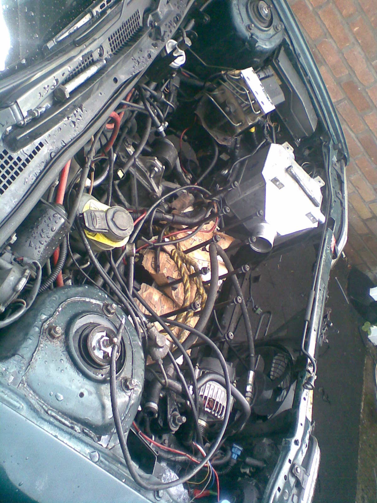

just been helping pull the dead engine out of my friends Rover 220 Coupe Turbo after it died to death a couple of weeks back. I'll copy and paste he's post from rovertech here.
Phoenix3dfx225 said:
Well I was heading to work on a Saturday morning to do some overtime, and was on some country lanes, holding it in 4th gear at around 4krpm until I got over a crest of a hill which leads down a long straight bit of road. Got over the crest and went WOT upto 5.5krpm where by at first I thought it misfired, but then a split second later realised I'd lost power and another split seconded noticed my rear mirror was so full of smoke I couldnt see the road behind me or anything else. Looked back at my dash to see my rpm reading zero :(
Coasted along and pulled up. Jumped out to check underneith the car to see if I had lost fluids nope, turned her over, clunk nothin. Bummer! Whilst waiting for break down to turn up I thought I'd check oil level to find it was way past max with a oil / water combination. Damn serve head gasket failure.
Until tonight when I took the head off and found, serve lack of no 3 cylinder failure! I'll get more clearer pictures up later :)

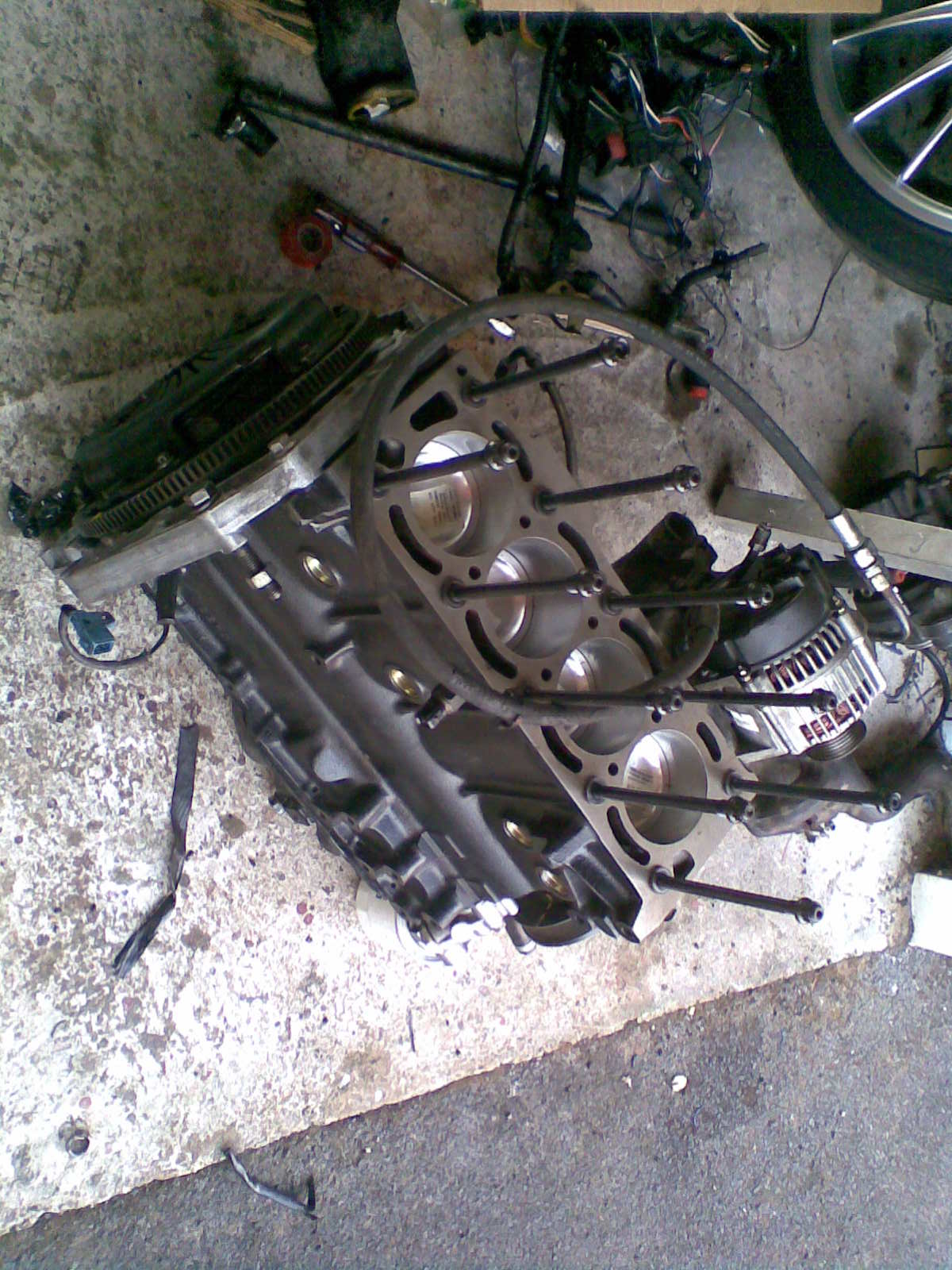

ok, been helping pull the car to bits. took the camera round and got some better photos. The engine hasn't been stripped any further yet, just eveything disconencted ready to be dropped out.
Piston dust.
The dent in the edge looks like the rod has hit it, how is that even possible!
The turbo spins again (but is still being scrapped), and the cat had a bit of water and a few bits of metal in it that dropped out when shaken!
It is an engine purchased for about £100 around a year ago that was only needing to run for a while whilst a new more powerful engine was built up. he had turned the boost up, and we think damaged the ringlands. (it sounded very rattly) but had been fine for 2 months or so with the boost backed off again.

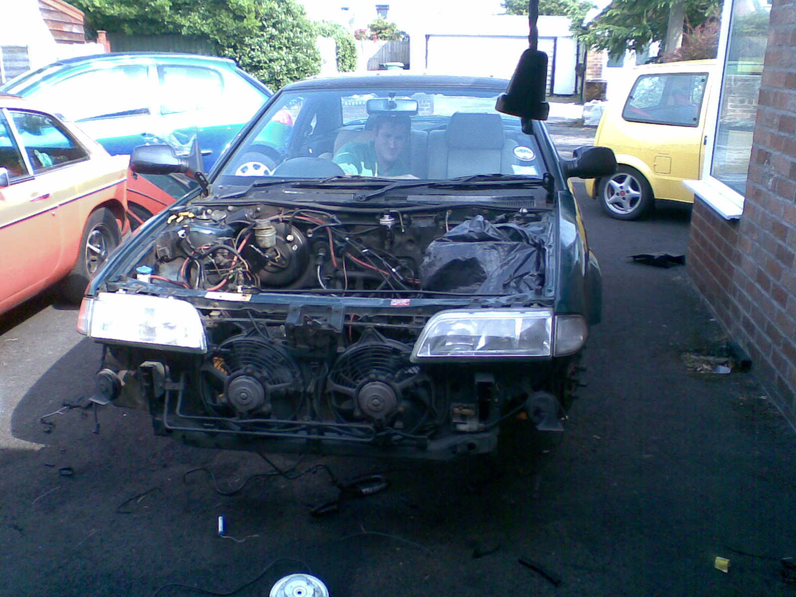

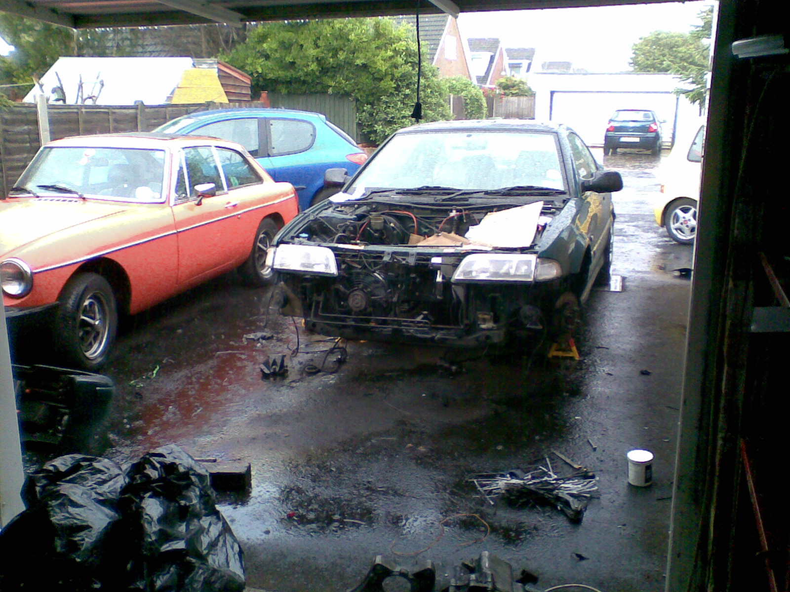

well the old engine was out,
new one ready to go in..
then the heavens opened..
but the engine crane had to be returned the following day, so we got on with it;
that'll do.. getting there, engine and box are in - head can go on another day. i've bagged the fun task of re-fitting the turbo timer, LC1 wideband lambda and the pump wiring for the new water/air charge cooler. :D
