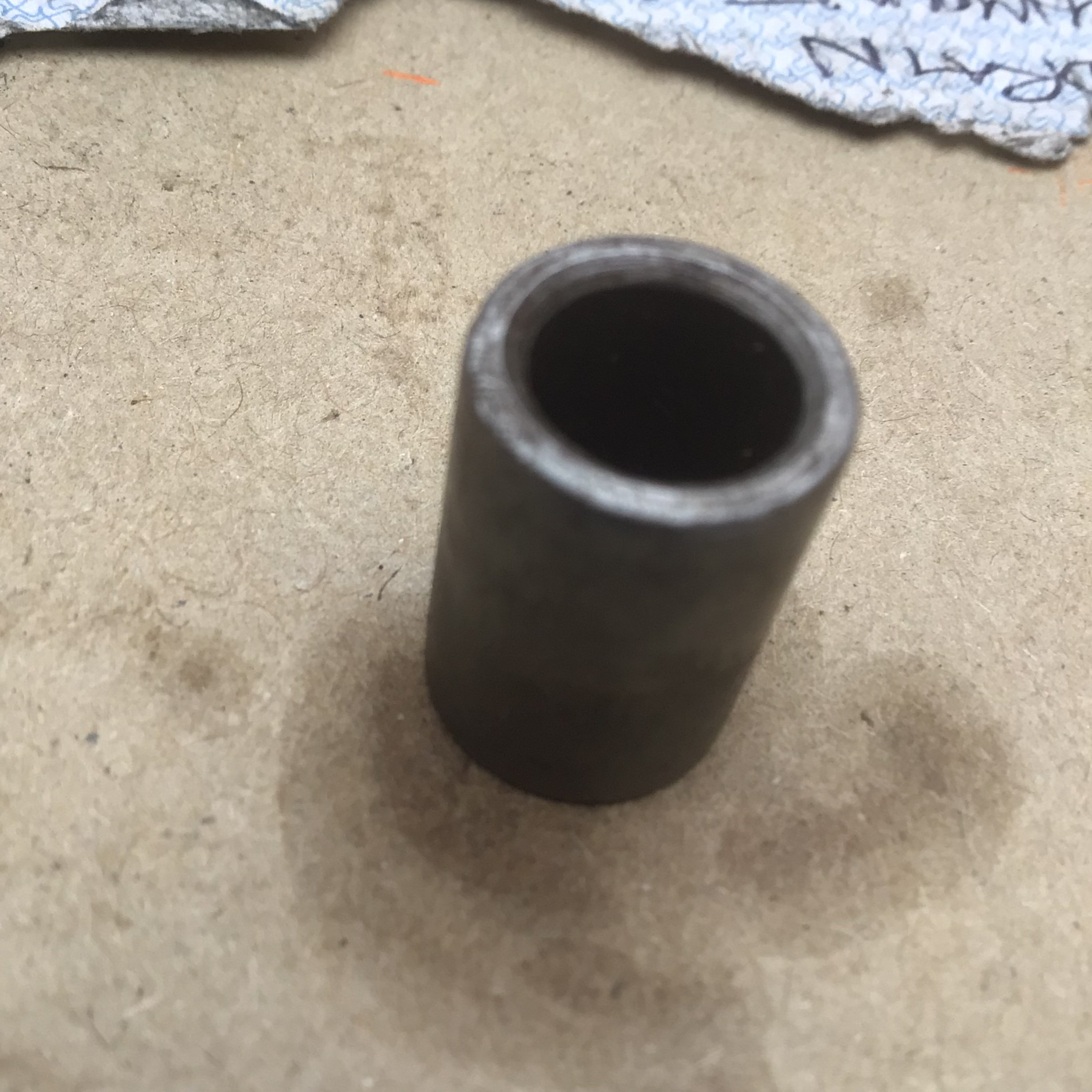

Does anyone have insight to finding replacements for the two hollow dowels / pins / bushings / alignment pins that are used to ensure correct fitment of the engine to the bell housing? For the life of me I can’t find a source, not even sure if I’m calling it the right name… it’s 13mm outer diameter, 11 mm ID, and 18mm long. I discovered my Giardiniera had only one when removing the engine, and it got somewhat mangled on removal. Thanks!

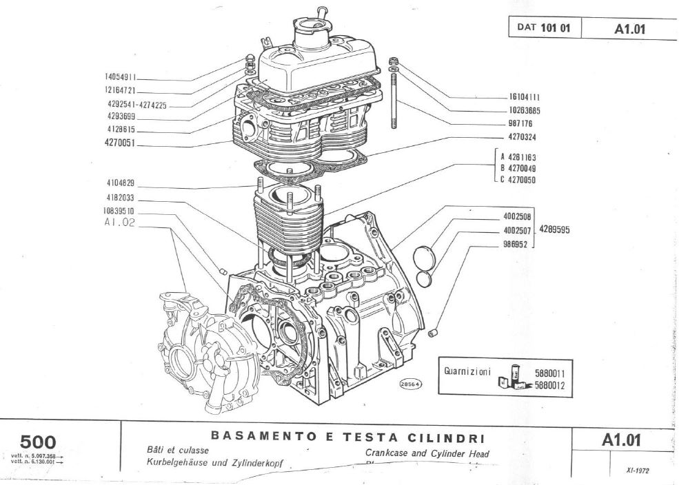

Seems to be part number 986952. May help you find them.
That would have been a main agent type part back in the day but I have never seen any for sale these days. I have found one in my gearbox bits I was just sorting through so I can get you some accurate dimensions if you are getting some made.
Thanks everyone for the feedback! I do have one still laying around and a local friend who says he can recreate more... sounds like that's the path to go.
