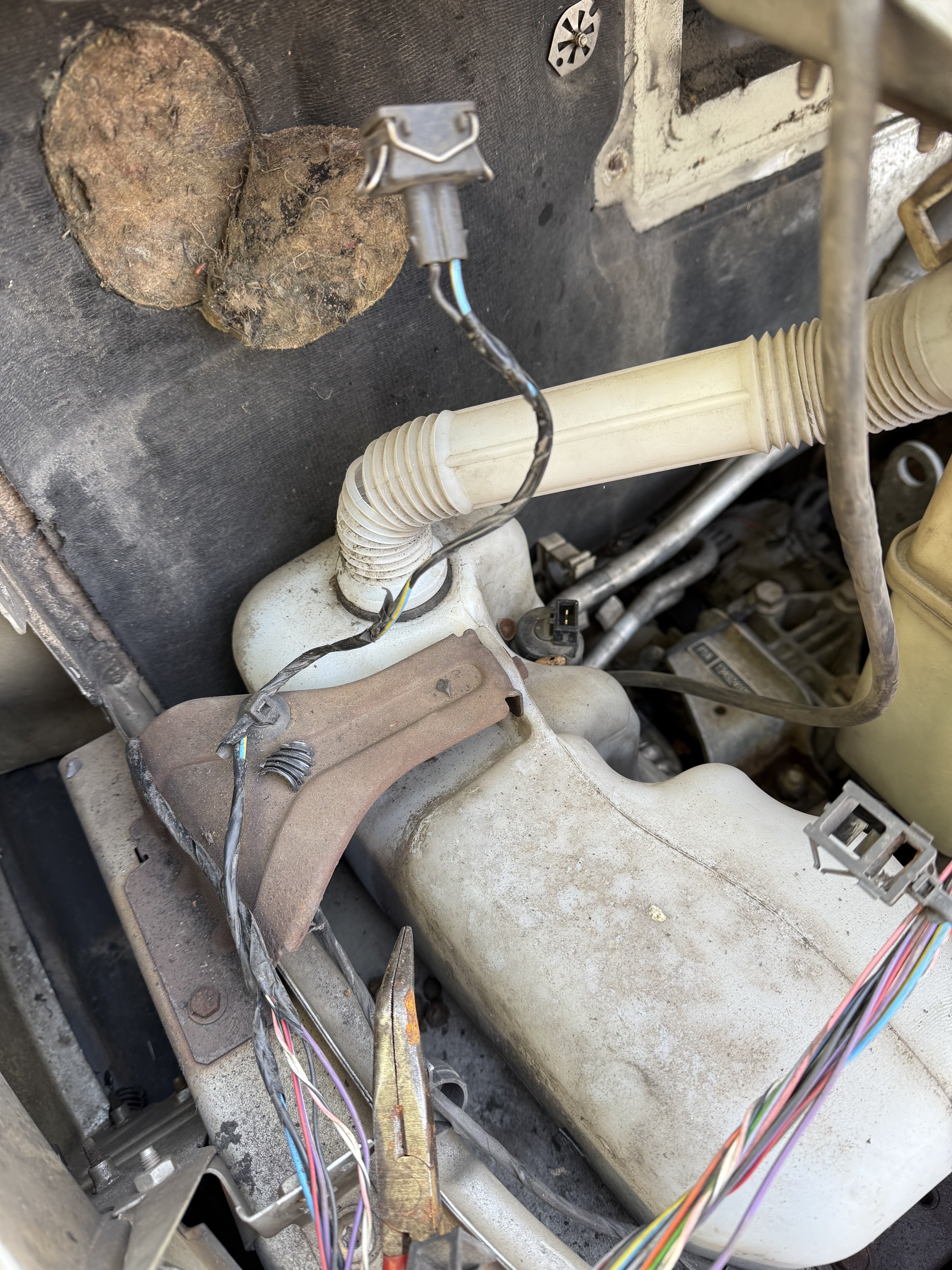

Hi guys, I have a request. See the photo in the post. I have a Ducato 250 2.3 88kw 2006. The problem is that the wipers cannot be turned off and the washer pump does not work. (The wiper motor is new and so is the pump) I found out that there is a black wire from the connector to the wiper motor that broke and I don't know where it broke and where it should go so I can fix it. Can you help? Thank you, see the photo of the cable

See lower LHS corner of diagram in attached Fiat eLearn Packet Print. Black wire is colour coded "N" apparently it has an in harness junction denoted by diamond symbol. Links washer motor, and wiper motor to chassis at earth point below LHS headlamp.

Thanks for the information. If I understand correctly, I will connect a new wire to the broken cable and connect it to the N wire in the spray pump.
Yes, but as screen washer (spray) pump is not working, you still need earth (chassis) connection. Diagram shows 3 wires connected to each other.

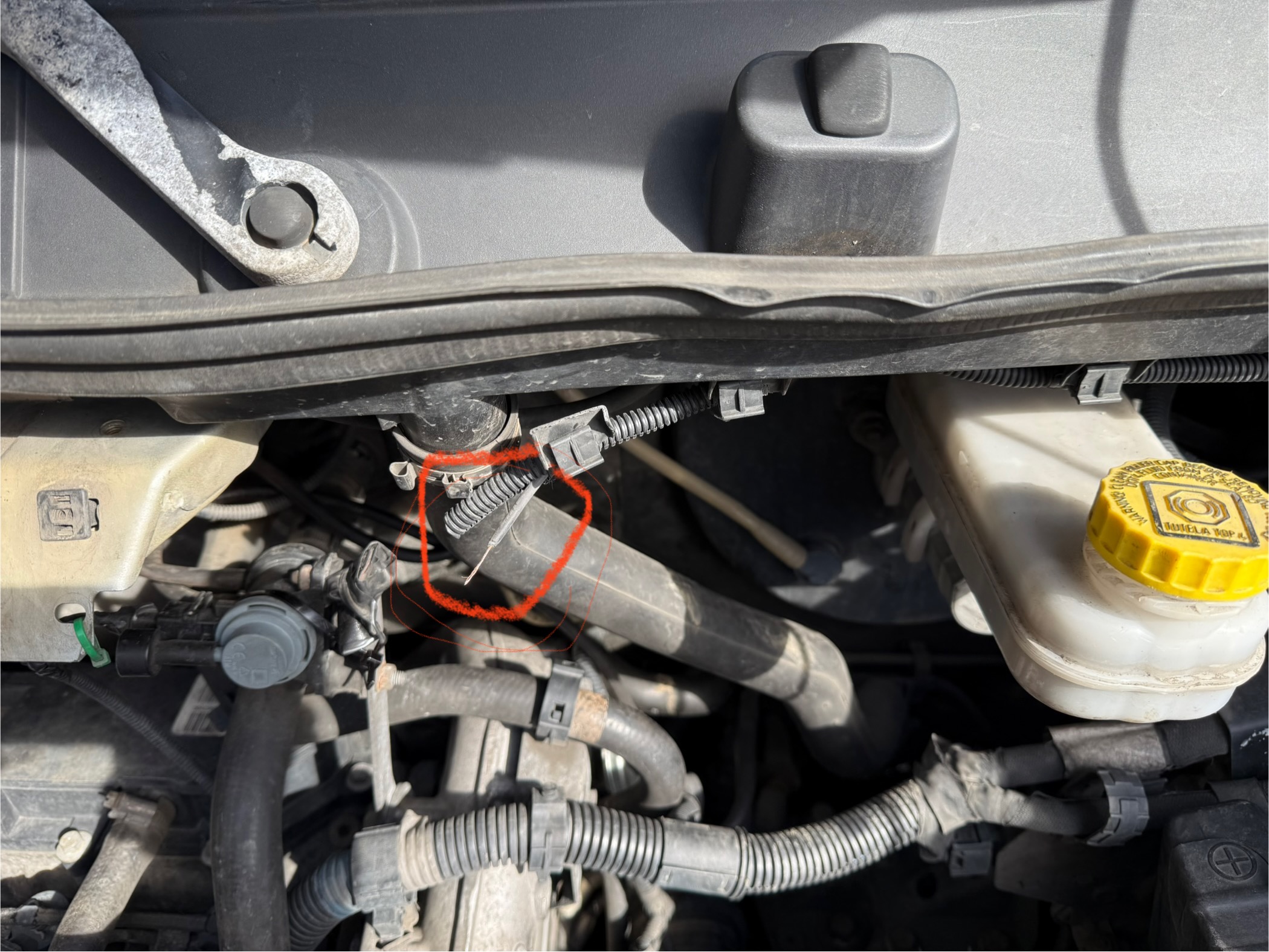

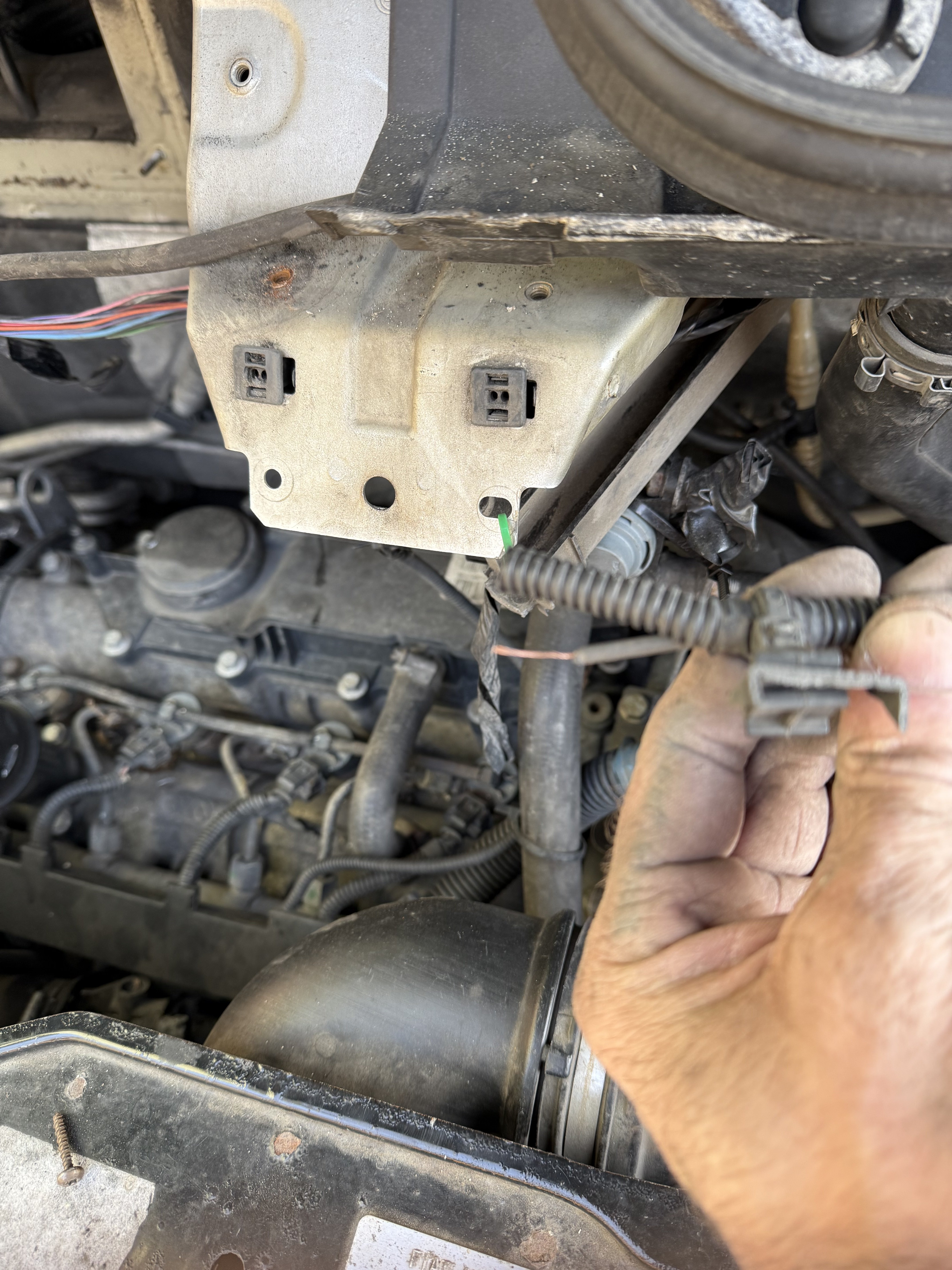

I'll go after the cables from the pump, maybe I'll be lucky and find the other part of the broken cable. So I'd just connect them together. Or if I can't find it, I'll connect a new one to the pump and I'll hope the connection to the ground remains intact. I'll take a picture if I can.
The second pair of broken pieces is not missing anywhere. The harness from the pump is fine, as is the frame under the light.
