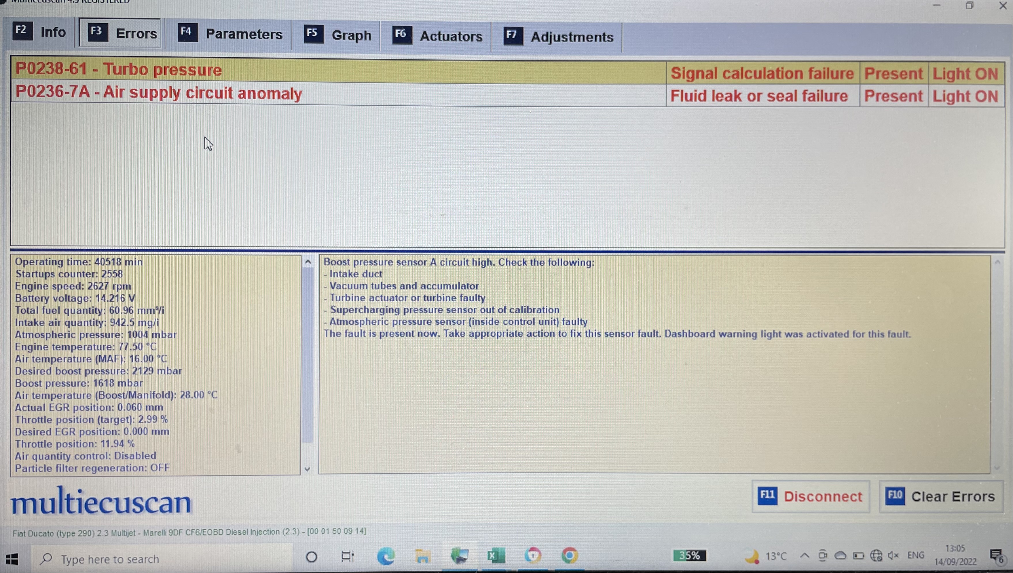

With Multiecuscan check the freeze frame data for the error.
With Multiecuscan set to graph the following parameters. See tutorial
www.fiatforum.com
Example Picture freeze Frame
Comparison of 401 Freeze frame data
5 different engines and 4 results from engine G.

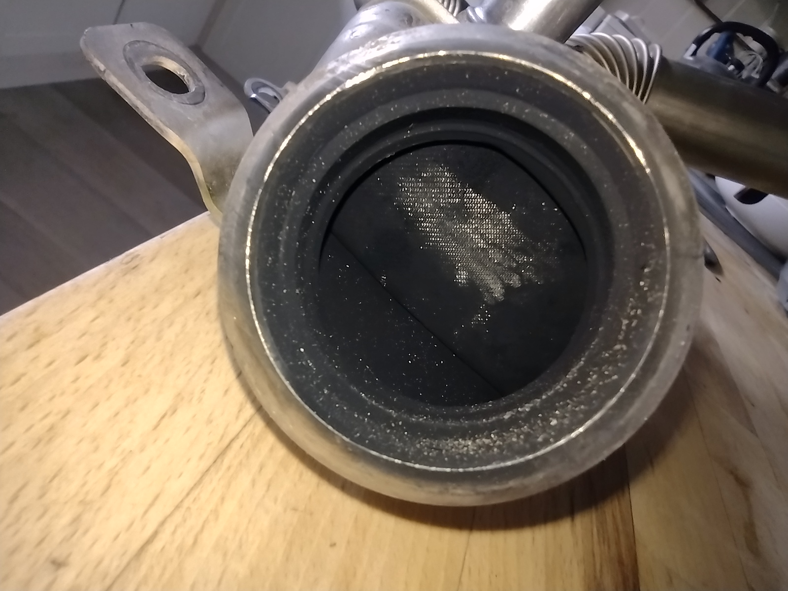

IF you have P0401 code sooty exhaust and a low LPEGR temperature you probably have a blocked cooler.
If other codes exist relating to pressure then the MAP sensor and turbo solenoid are suspect.
Where is the LPEGR cooler.
Tutorial to Measure specific Engine PIDs (Parameter ID) and Save data for analysis.
This was originally written to help one person with his Ducato totally new to MES to start saving data. it is not an exhaustive manual nor intended to be. Tutorial to Measure specific Engine PIDs (Parameter ID) and Save data for analysis. Open...
