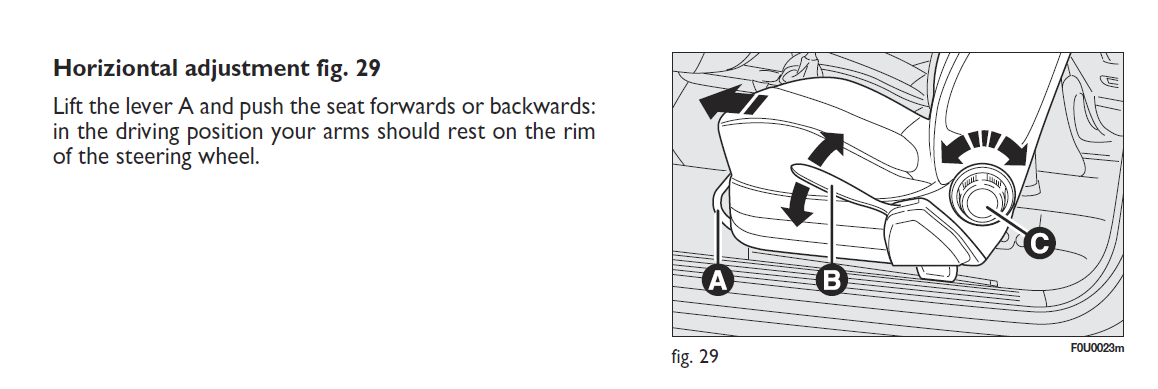

Hello,
Is the lever that allows sliding working properly? Looking at the manual:
it should be attached to both sides of the seat base, perhaps it has detached itself and thus you can't move the seat.
Try pushing the seat a little bit to the back and to the front and operate the lever at the same time.
Compare with the other side, should be the same.

Hi. Thanks for the reply! The lever is still attached and the chair doesn’t move when pushing the seat. I’ve looked under the chair and when I operate the lever it seems like a piece of the mechanism (perhaps a spring under a pin?) is jammed in the runner on the right hand side. There is a metal arm that moves down to meet the pin when the lever is engaged. The left hand side engages fine.
I’ve tried using a screwdriver to release the piece stuck in the runner but it won’t budge.
Hope that makes sense - I’m not really 100% sure what I’m looking at.
