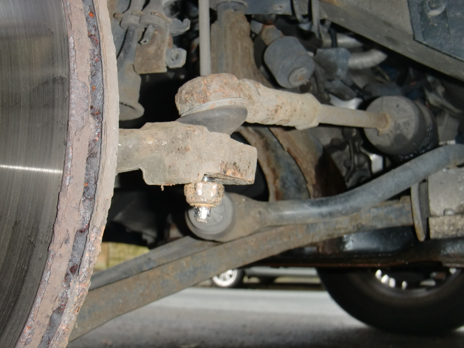

Then onto the Track rod end and the saga it entailed
In the end the lock nut came off in several pieces;
I didn't have any trouble splitting the taper joint but made the mistake of doing so before fully removing the nut. Once I'd split the taper I didn't have enough purchase on the stud with a set of grips so it just turned with the nut due to the exposed/rusted threads binding. Note to self, remove nut before splitting joint next time!

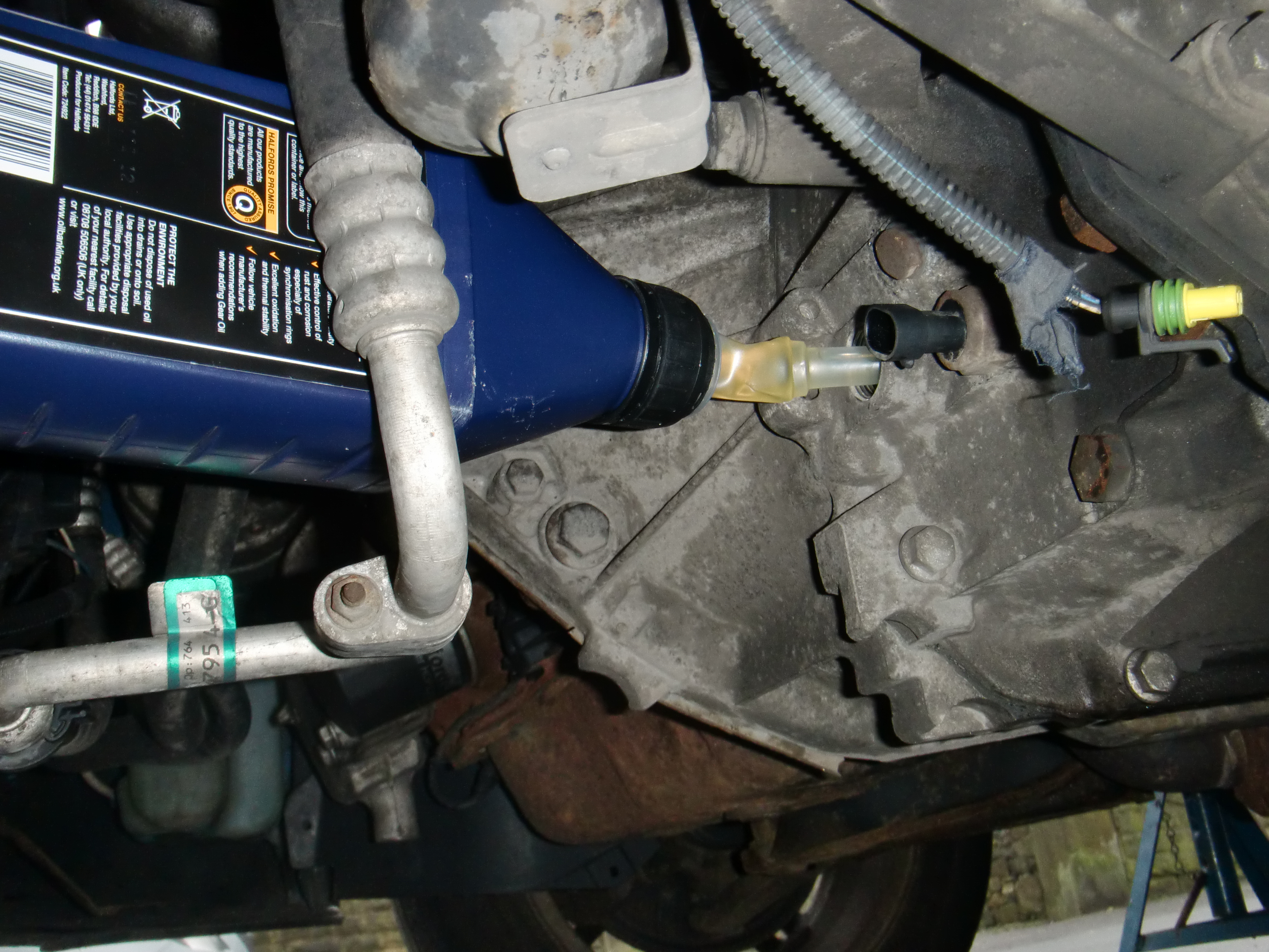

That's about as far as I could go for now until I get a new clamp for the inboard side of the rubber bellows so just topped up the gearbox.
I just managed to get the bottle spout in
until a level could be seen from the filling/level plug.

Also if you remove the bottom turbo hose to intercooler(2 minute job) it makes a much easier job of topping up.

Thanks for the tip for poping out the drive shaft, I'll definately be giving that a try when I get the proper spares. As for the turbo mine's the 1.6 petrol so it's all coolant pipes in the way, I got the oil in though with a bit of manoevring (y)
