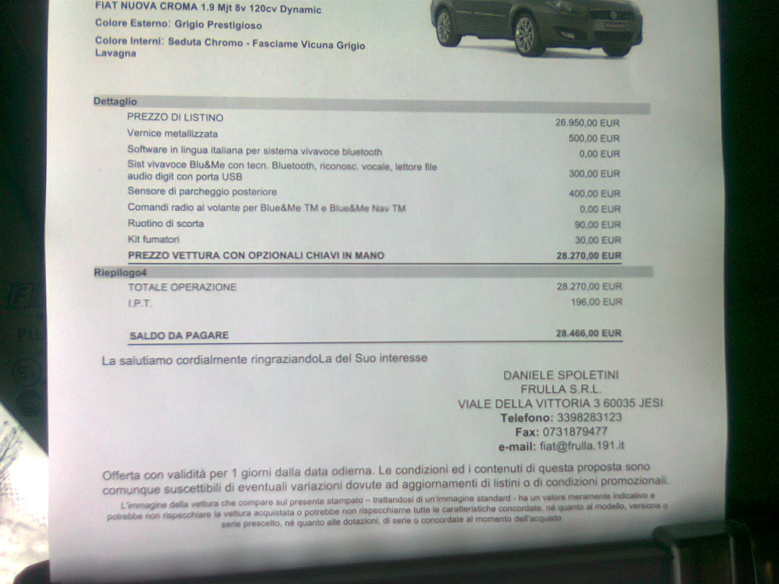

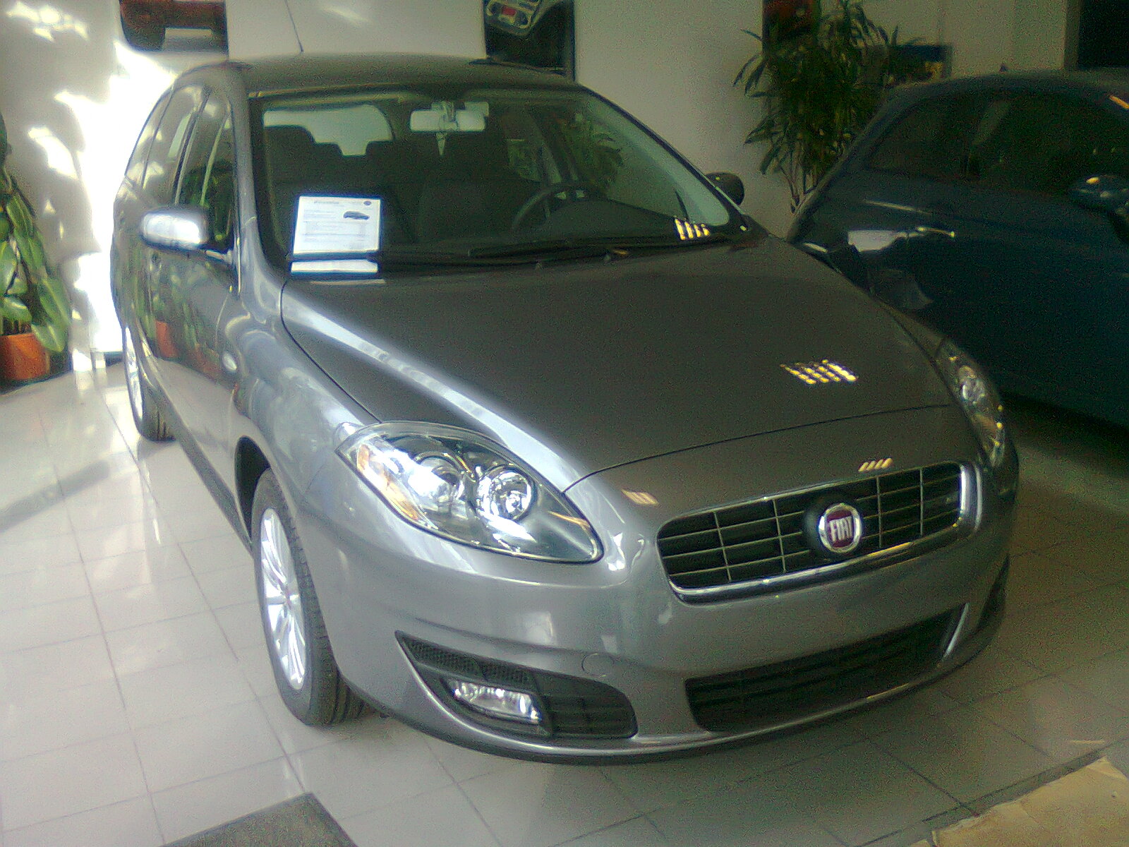

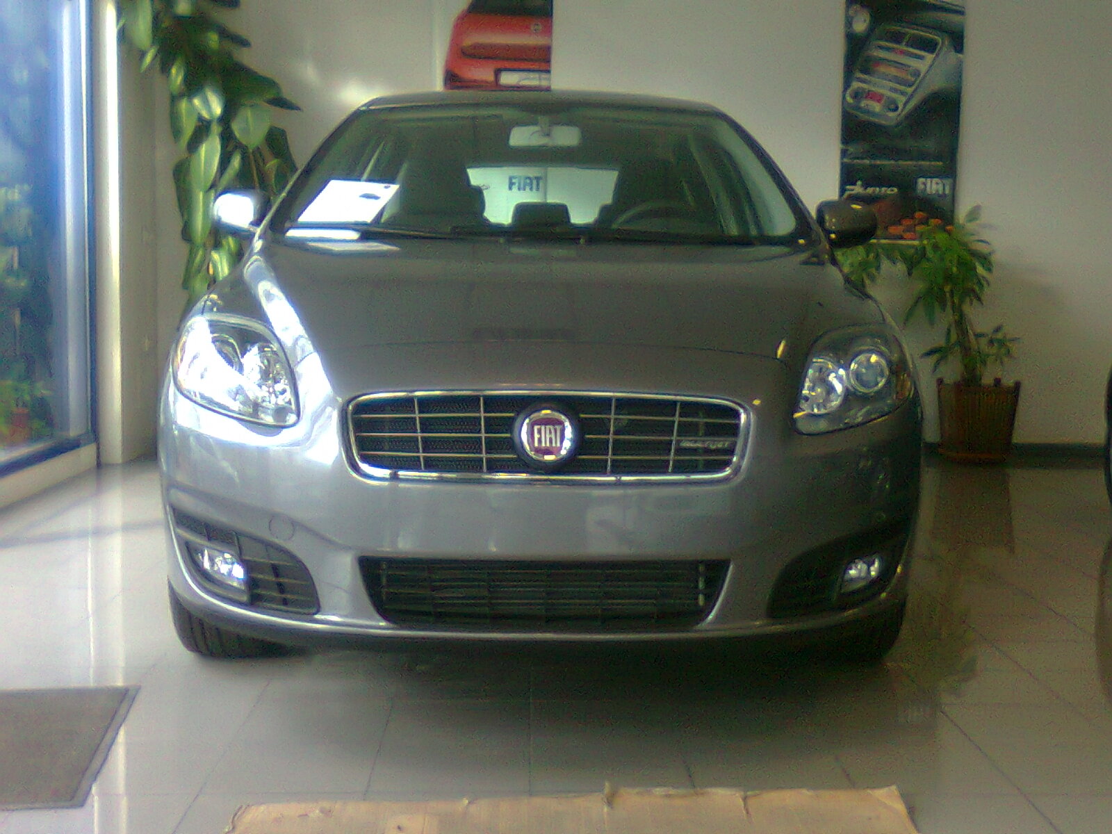

If so many Croma owners have had drive shaft problems, why do dealers look so blank when you tell them. This thread has had over 3000 views. There are only around 1400 Cromas in the UK! Many more of course where I am in Italy. By the way, last Thursday in local Fiat dealer. 120 8v Croma, brand new with blu&me etc for €28000 (about £24,356). Get one quick its a dying species.
mmmmm facelift croma :yum:
I couldn't believe the cost of cars out there - we saw a Cinq up for €3000.. People wouldn't pay £500 here!
Is that a brand new Croma? We bought ours 2 years old, only 16,000 miles, and around £8000. About 1/3 original cost.
From my experience as an almost annual visitor to Italy thier new car prices are very high compared to most of the rest of Europe.
Also the Italian vehicle tax/road tax scheme is quite complicated and "banded". It would not surprise me if that there was some form of interlinking between purchase price and vehicle tax band besides the annual car road tax duty. Such a linking would make the Croma very expensive.
Don't forget Italy is the land of smaller vehicles so the larger ones are in the minority.
Indeed Cromas are expensive here. The insurance system is very complicated. For 2 adults it cost over 1250 euros fully comp. Road tax is extortionate compared to UK. Over 320 euros per annum. Thankfully diesel is always a little cheaper than petrol. Italy may be the land of small cars but it doesn't stop Italians buying big Audis, Mercs, BMs etc by the truckload even in a rural area where we live.
