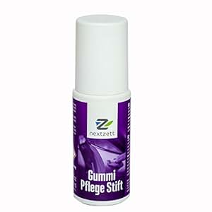

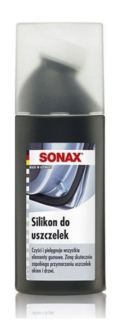

In freezing weather wiping the door seals with a silicon lubricant of a rag or some paper towel will help prevent it sticking to the door with frost. Recommended to do this every winter before the ice. WD40 Silicon or something similar does the job
In freezing weather wiping the door seals with a silicon lubricant of a rag or some paper towel will help prevent it sticking nto the door with frost. Recommended to do this every winter before the ice. WD40 Silicon or something similar
I use a silicon on it but it's already on its way out so when this bloody snow and ice has done one i will replace it, the snow which was fun at 1st, and the car loves it but I don't everywhere I go seen range rovers and all manner of 4x4s stuck or struggling but this panda draws all the attention cos it's a little husky that takes snow in its stride not even been remotely stuck yet spose there's always a 1st time but not yet
