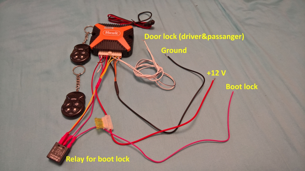

First connect wires from Hawk unit and relay according this picture:
