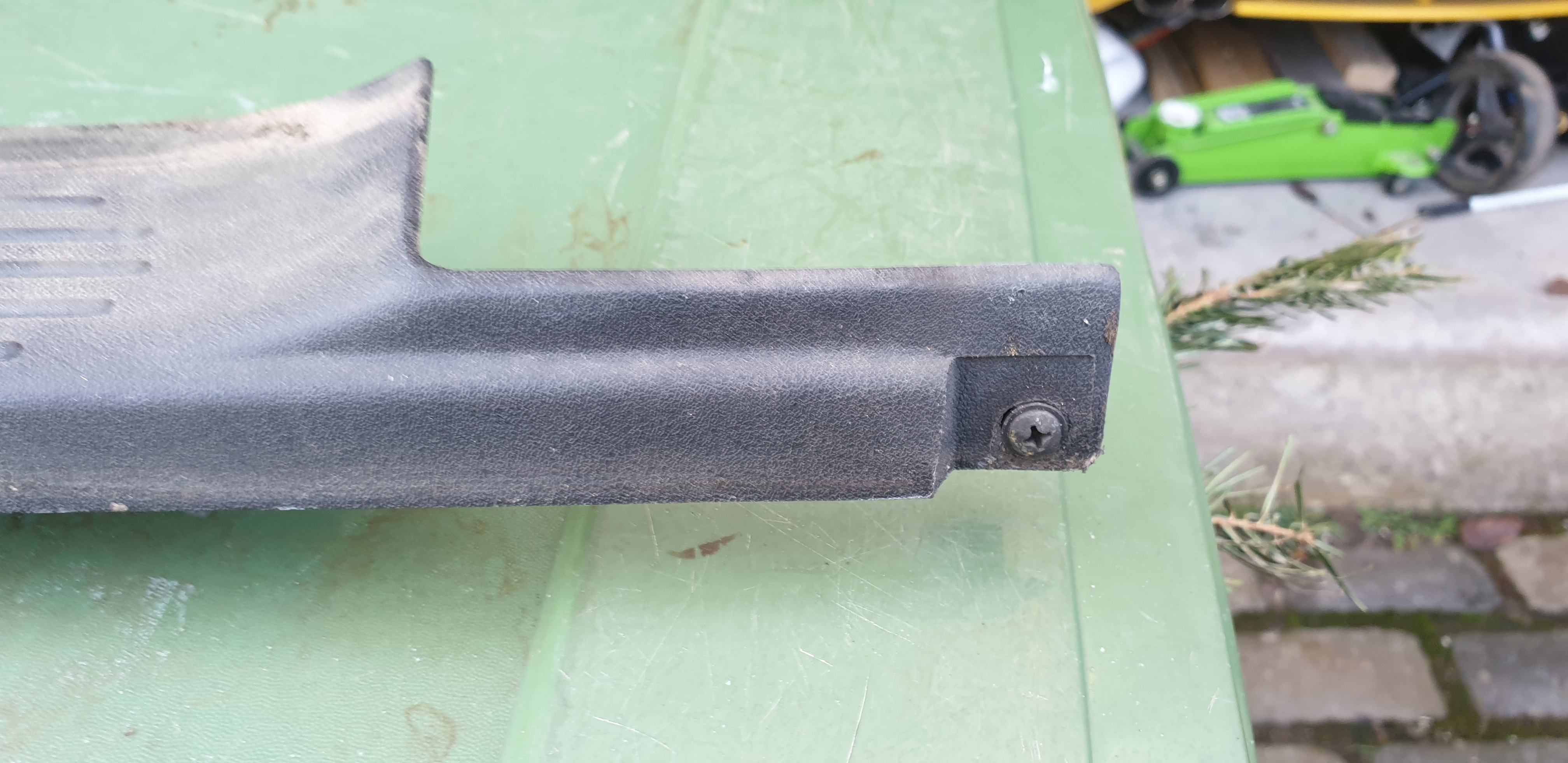

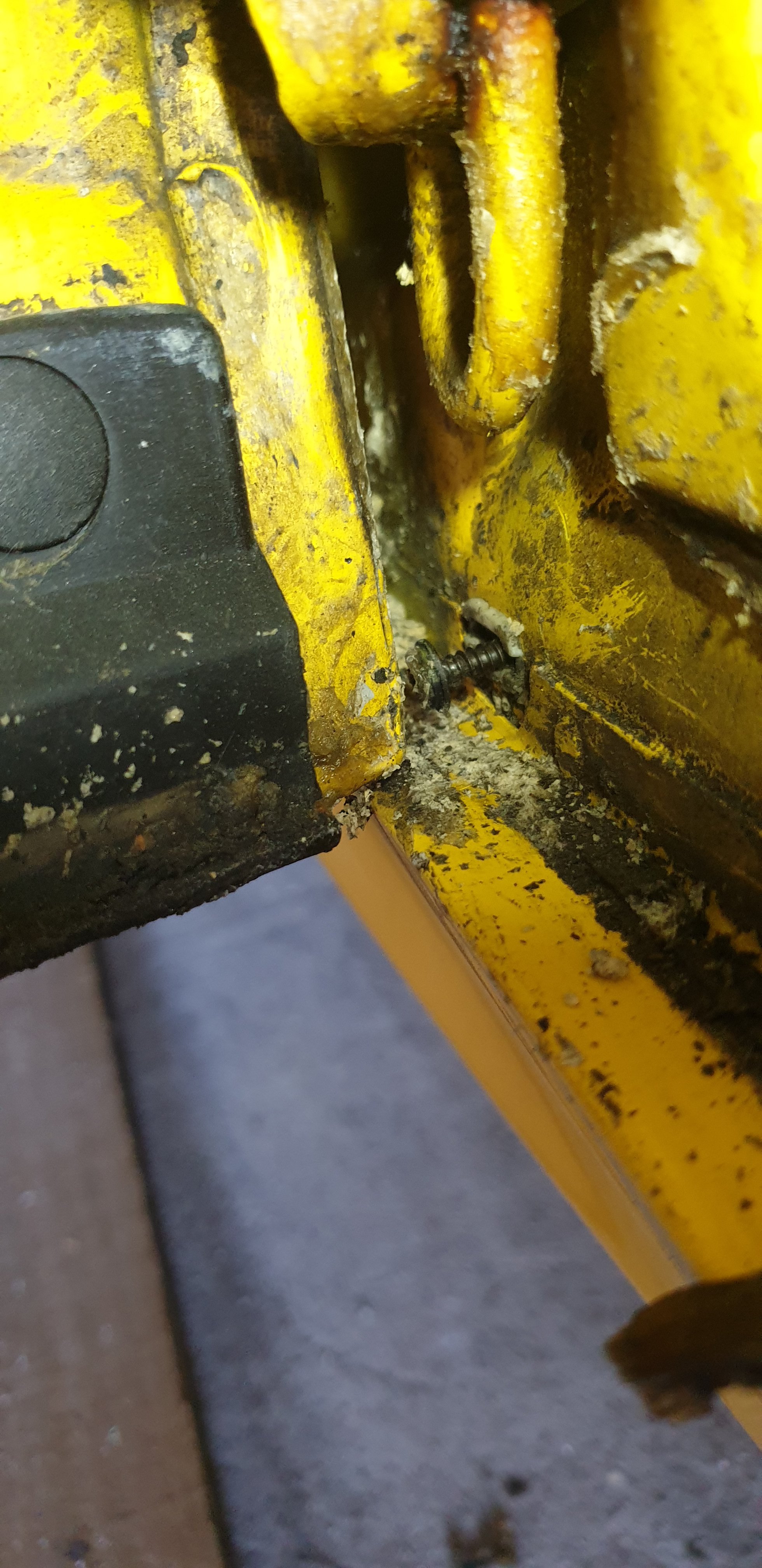

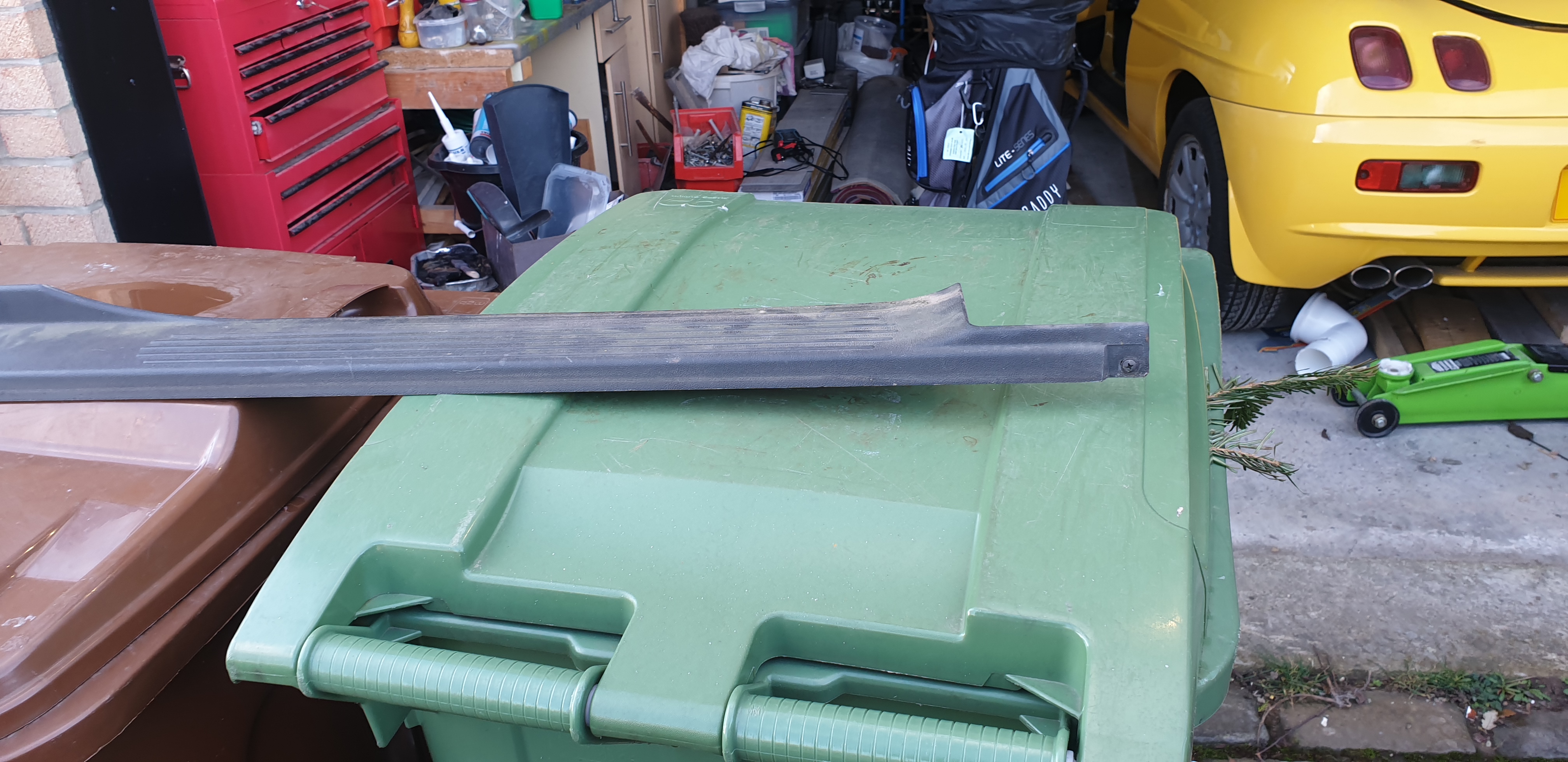

Hi all. Putting the Barchetta back together after welding the floor. I've got a little bit of rust on the lip that runs inside the door frames, and need to remove the black plastic trims that fit on top of the sill. There is 1 screw I can see which I have removed but it doesn't want to come free. What holds it in place please?

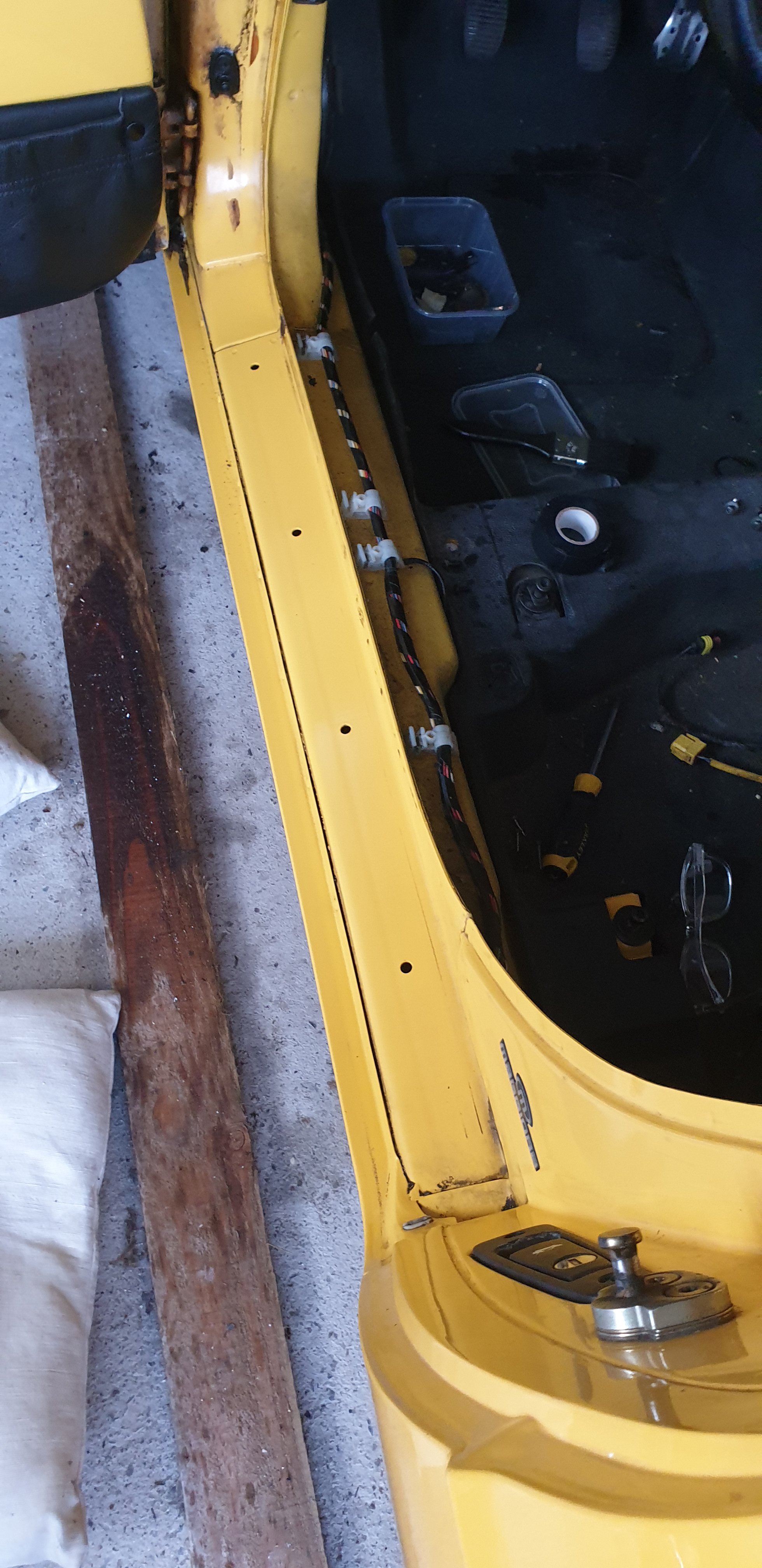

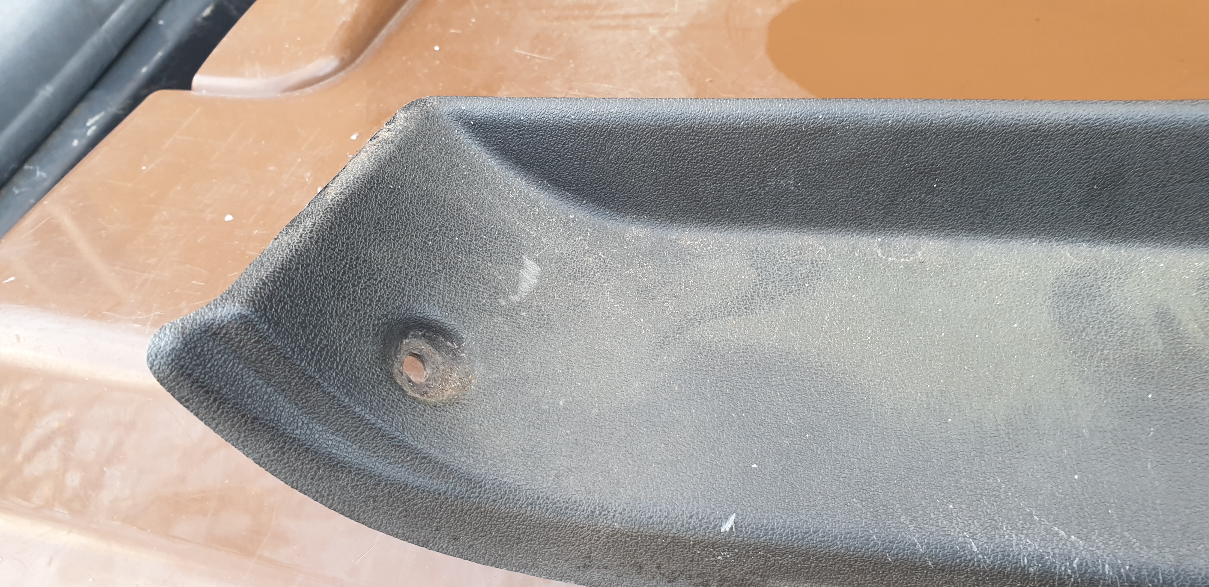

Sussed it. There's a small screw at the base of the A pillar. Door needs to be fully open to see it. There's also 4 of the plug and socket kind of fixings, but they didn't put up much resistance. The 4 holes for them can be seen in the top of the sill pic.
