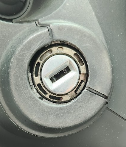

Hi - I bought my van a long way back and it only had 1 ignition key and a separate door key which worked the slam locks. The ignition key looks pretty generic no buttons etc. Also the ignition on the van seems to have been tampered with - no outer ring and no plastic tab that I see on other pics. It's a 2008 Relay 2.2 XLWB.
Reason I'm curious is that I had some starting trouble recently and it may be the ignition circuit to the solenoid signal not getting activated properly so am thinking to replace the key/barrel. I guess this will be easier if I don't need to worry about the transponder/immobiliser - though I may need to get a separate immobiliser fitted for my insurance of course.
You are correct in your observation that no transponder aeriel ring is fitted round the ignition barrel. However there remains the possibility that the aeriel has been removed, and placed under the dash, with the transponder chip stuck next to it. Member @bugsymike has a story about this, whereby he ended up washing the chip away when cleaning a pre-used van.
One reason for not removing the transponder system is pure economics, as it allowsuse of an off the shelf replacement lock barrel and key.
If the chip, and aeriel have been removed, the engine control computer will need to have been reprogrammed to remove the immobiliser function.
The standard immobiliser does not interface with the starter solenoid, it only prevents fuel injection, by not allowing the ecu to progress to that stage.

Ahh interesting thanks so much. I'll take the trim off and have a look for anything that looks like an aeriel / transponder chip. If I'm in luck I can swap over the ignition and have the luxury of 2 keys as well which will be nice as for 10 years I've been dreading the loss of the 1 key thinking I couldn't easily get it copied as I don't have the master key.
Assuming the immobiliser is there it is of course not effective so I should probably have an after market one installed. My van is not new but it does look OK and has a lot inside that may be attractive!

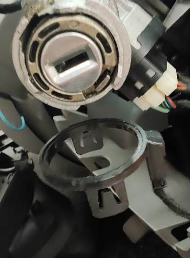

So after taking things apart I now have the barrel out. I notice that there is actually the aeriel - just a bit hidden behind the grey plastic trim.
I have a new assembly arriving imminently so am thinking I can just replace the barrel (so the part the key directly goes in and the part around that which came out together. But then I will need to keep my old ignition key with the transponder in my van to hold near the ignition when starting? Does the transponder have to be there just for starting or is it needed all the time the engine is running?

OK so finally found the answer! You need to put a screwdriver into the assembly and turn the small catch at the bottom clockwise "on" position then the barrel will go in. It wasn't the push latch stopping it but the small mechanism at the end of the slot the barrel goes into. I thank this youtube video for the clue.
And now all is reassembled I confirm that the non-descript blade key does indeed have a transponder so am seeing if a local locksmith can get the 2 new keys to work with the immobiliser. For me it's OK to just have the "original" key next to the ignition to start the engine but this may not please a future owner who may be suspicious about the van's history.
