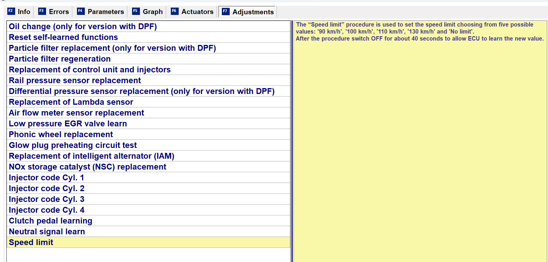

This is the simulation screen in MultiECUScan from my 2018 Doblo
Yes indeed, but when there is an speed limit set with MultiEcuScan it isn't rpm restricting. It is litterly speed restricting.
