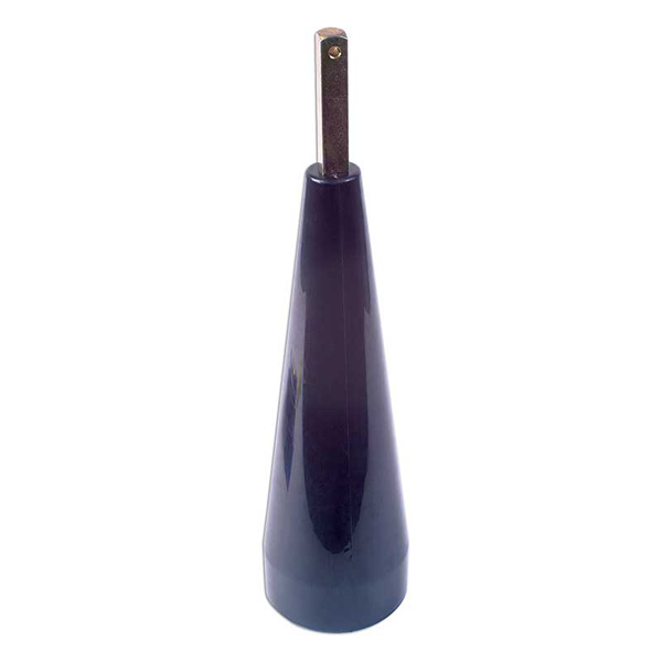

The third method is to buy a stretchy type pattern CV boot and using a well oiled plastic trumpet stretch the new boot over the CV joint and fit grease and clips etc.
Below are the three tool methods .;)
