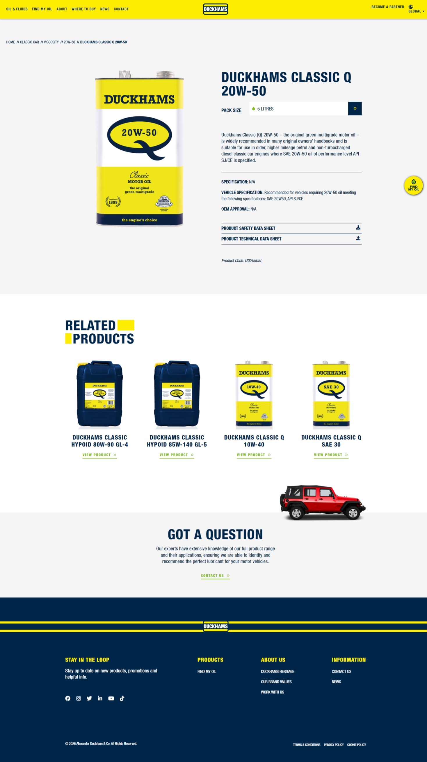

If you want 20w/50 oil you might see if you get this - it was recently re-introduced, It was noted for being a weird green colour, so don't be spooked if it still is green, there's nothing wrong with it.
If you can remember when milk had cream on top you can probably remember Duckhams on the shelf in Halfords! 😂😂
