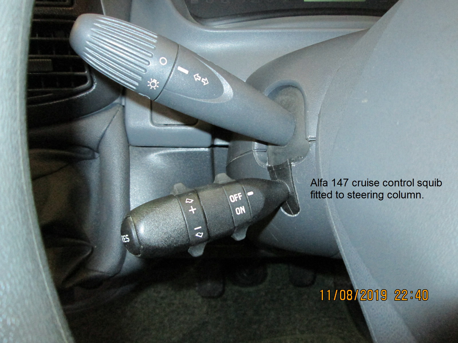

Hi Jimmy,
Welcome to the forum.
Some of us have used a Fiat Alpha 147 cruise squib on the earlier x244 Ducato. I do not know how this would fit on your x250. See attached photo.
