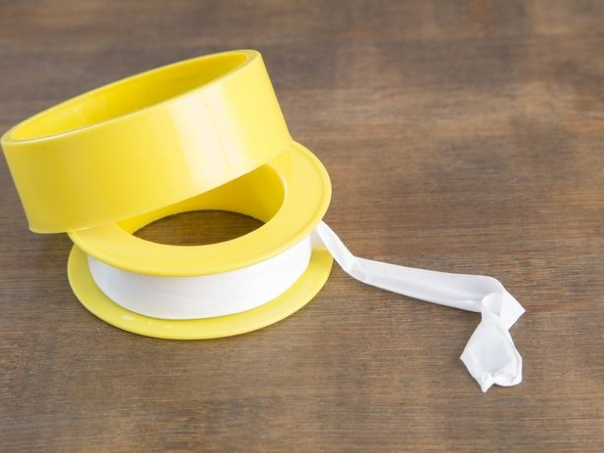

I've also read that plumber's teflon tape can be rolled between the bush and bar.
That's interesting, I'll look into that, cheers.
