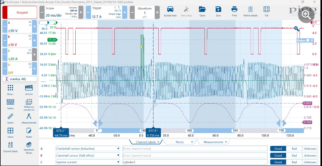

Thanks for links now comes a terminolgy question. I am trying to analize my injectors with a picoscope and taking advice from elsewhere. it suggests measuring the crankshaft sensor and injector then some maths together to find the "different cylindar". Now is this the camshaft sensor on top "timing sensor"
or the engine speed sensor "revs sensor" (used to determine the angular position of the crank)
as i write this i'm begining to have an idea but someone me or him was confused when talking about the rev and crank sensor as 2 separate devices. its the same one? please unconfuse me.

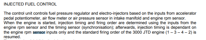

I'm pretty sure the revolution/crank sensor are synonymous.
Though the following is actually from the other training manual for the 3 litre engine, the need for both a timing and revolution sensor is neatly explained, and is probably similar for the 2.3. (i.e. on first cycle or part-cycle, the initial cylinder for injection is determined from the timing (camshaft) sensor and once that first (part-) cycle is complete, the crankshaft (rpm) sensor alone is used).
The above is also stated for in eLearn for the 2.8jtd, but I have been unable to find a similar definite statement for the 2.3, either in x250 Training Manual, or in eLearn for the 2.3jtd.

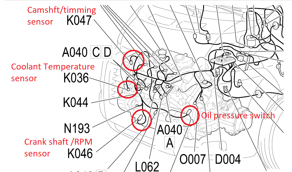

Hi mate,could you please guide me to crankshaft sensor on 2010 3.0 160.fiat ducatto motorhome.thanks⁰
See page 59 of x250 Training Manual, which is available in Downloads section. See black banner at top of page. Shorter of two available files is for 3 litre.
