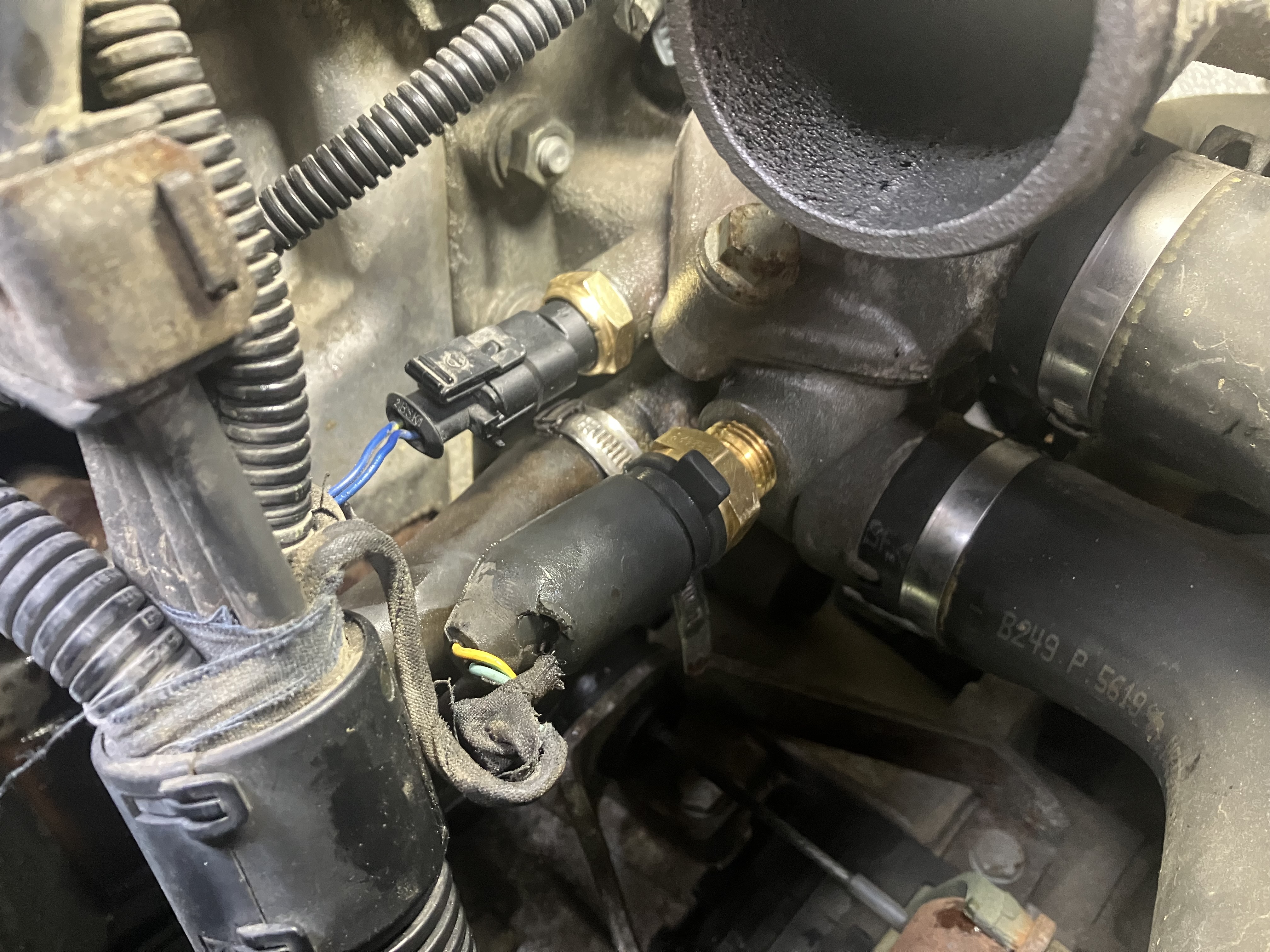

The 2,8idTD is a Sofim 8140.43, while the 2.8jtd is a Sofim 8140.43s. As the 2.8jtd was developed from the 2.8idTD, I would expect the thermostat locations to be similar. The 2.8jtd has an extra sensor for the ECU which is used for fan control and injection timing.
On my 2.8jtd you can just glimpse the sensors when peering between the intercooler hoses towards the LHS of the vehicle. For access either remove the intercooler hose(s), or the air filter housing.
The linked photo was submitted of a 2,8jtd was submitted in a recent thread, and should serve to illustrate the location. See here,
Unfortunately there may be a further complication with the 2.8idTD, in that it has a voltage regulator to supply perhaps temperature and fuel gauges. I cannot be sure as I have never owned one.

The round connector in that photo ( right hand one) I have one of them on the left hand side of the engine, right side if talking from the front. It's a 2 pin in a T configuration.
I've ordered a replacement thermostat from here ebay link and when i tinkered with the connector my thermostat gauge become unresponsive so 90% certain thats its.
As for air in the system, I had a new radiator fitted 2 months ago and the system was bled so hoping it's not air and just a dodgy sensor.
Sorry Ebay link did not work for me, but I can confirm that on my x244 2.8jtd the combined gauge sensor, and thermostatic switch for the warning light has the connector blades in a T configuration. Thread is M16, and the hexagonal section fits into a 22mm spanner.
Last year I noticed that my gauge was going to normal immediately when switchng the ignition on. I prepared to change the sensor, but in the event, cleaning the connector contacts effected a cure. Hence I did not attempt to use the following method, which I have previously used to minimise fluid loss when changing a clutch master cylinder. I did receive a favourable report when I it suggested on another thread relating to temperature sensors.
Fill the coolant reservoir to the brim with appropriate coolant. Seal the reservoir top with thin plastic sheet, and rubber bands, or string. Prepare for a quick change of sensors, and some coolant spillage. When the old sensor is removed there should be minimum coolant loss, as any loss will be creating a vacuum at the top of the reservoir. If successful you may have to remove surplus coolant from the reservoir.
