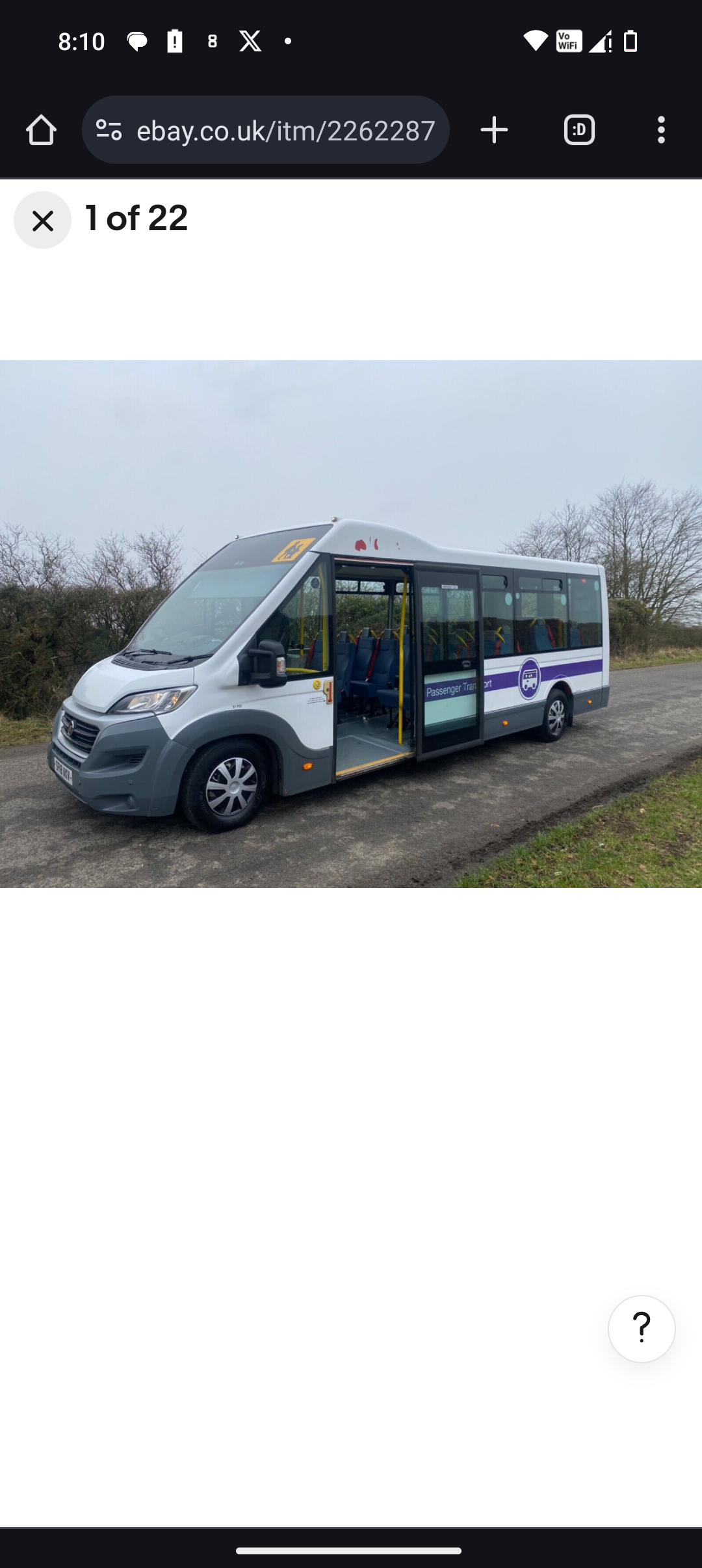

Hi all, I am getting this large minibus on Monday and I need to just confirm a few things with people in the know. So this is a fiat ducato 42 multijet with a Mallor conversation and disability access. The vehicle is 7.5m long, 2.2 wide and 2.8 high. It has a gross weight of 4200kg. I plan to use the vehicle as a wheelchair access vehicle, but adapted for personal/ family use (5 seats max) and not a 16 seater commercial minibus as it is now. My question is, can I drive this on my licence.. I have had my license for 20 years and I have worked for a courier company driving LWB vans. Also, because this is registered as a minibus, I feel as though my insurance quote has come out a tad high.. £730 for a year, is this right or do I need to change something with the DVLA. This is completely new territory for me and any advice you can offer would be simply amazing. Thank you in advance 😊
