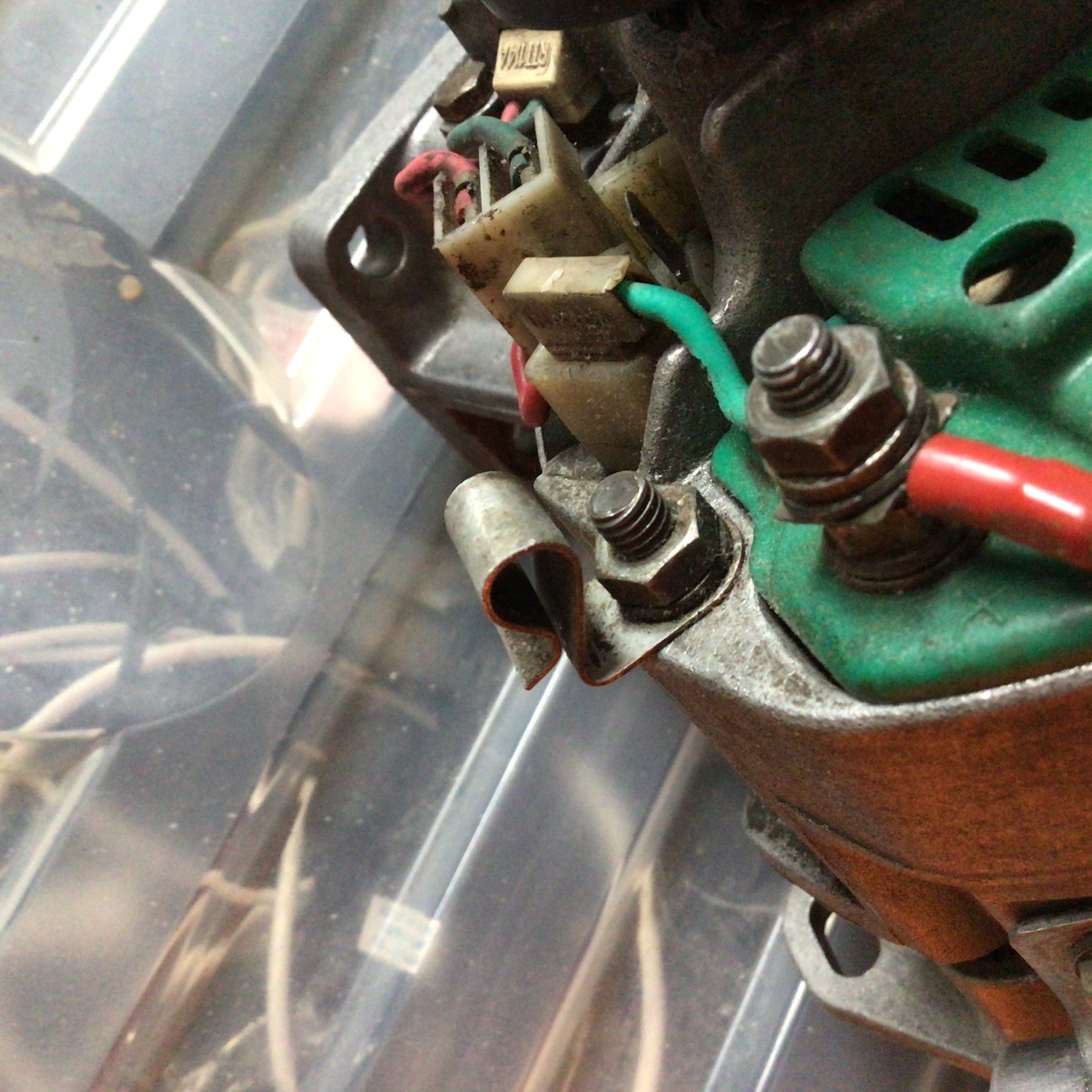

This is the original spring clip fitment on the alternator. I guess designed to keep the wires well back from the pulley.
A rubber-lined 'P' clip, turned to face inwards would do the job perfectly adequately. The spring clip that Fiat used would have been a lot cheaper to make (and did the job) than a 'P' clip which is why I suspect Fiat used the simple spring clip.
