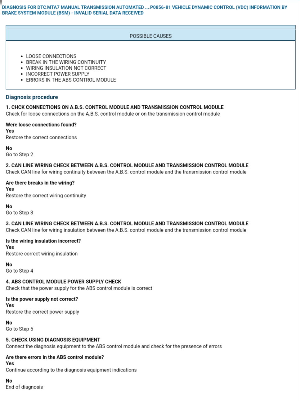

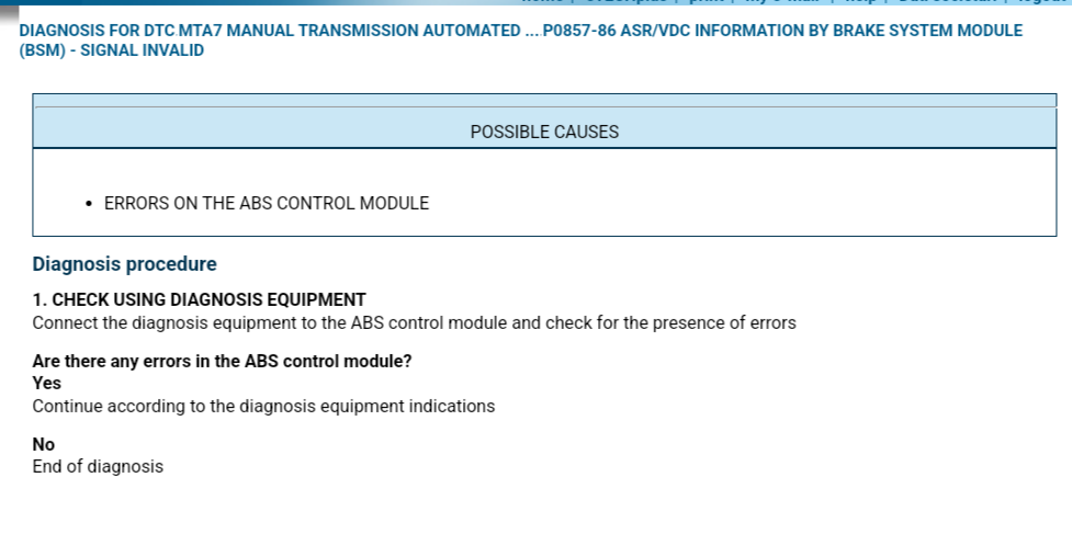

I have also changed the break pedal switch after having a diagnostic check carried out that highlighted two fault codes po857-86 and po856-81
Thanks you so much msjoberg your information is very much appreciated many thanks ajward
I will get it booked in as I don’t have the equipment to to check it out fingers crossed it’s not to expensive

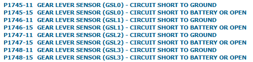

What first comes to mind: error in Gear Lever Sensor(s), or in wiring from Gear Lever Sensor(s) to Transmission Control Unit, or in Transmission Control Unit.
Speculating further: If there are no error codes it seems to be some error that the system doesn´t detect, this could point to some mechanical error preventing the function of the Gear Lever Sensor for auto/manual selection. I do not know which one of the sensors this is.
I would start with a simple test using Multiecuscan or other capable diagnostic tool, to check the status of the Gear selector lever position parameter when auto/manual is toggled with the lever.
Error codes when errors are detected for the sensors:
